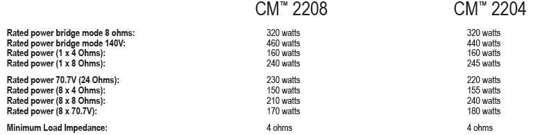

That's it_____Without more detailed specs! Peavey don't disclose the full specs. They only specify THD at 1 KHz on a 70 volt line. What is the THD from 20-20K at rated power at 4 and 8 ohms? What is the power bandwidth? What is the frequency response like at full power? Compare the specs of any QSC amp and you will be provided with detailed specs.
IMO, this amp has a very poor low current power supply as it's rated power output at 4 ohms is inferior to that for an 8 ohm load. It is indeed specifically designed for paging. I wouldn't recommend to anyone to acquire such product unless it's purpose is to use in venues for paging purposes. With the info at hand, this cannot be classified as a true hi-fi amplifier.
Let's ask @PENG what he thinks of that amp in a high-end home theater system.
Edit: Specifications:
  • Model: CM 2208
  • Output Power 4 Ohms: 150W x 8
  • Output Power 8 Ohms: 220W x 8
  • Output Power 70V: 20W x 8
  • Frequency response (1W into 8 Ohms ): 1KHz, <0.02% THD+N, one channel driven, non-bridged operation - 5Hz to 20kHz, +/- 1dB
    THD+N: <0.02% at rated power (@ 70V, 1kHz)
    Damping factor: 200:1 into 8 Ohms
  • Input CMRR: >60dB @ 1KHz
  • Input sensitivity @ 70V: 0.775V for full rated output power (0.775V gain selected); .75V for full rated power (x40 gain selected)
  • Input impedance: 20Kohms balanced, 10Kohms unbalanced
  • Hum and noise: -97dB, A-weighted
  • Crosstalk: < -60dB below max rated power (1KHz)
    Power supply: linear transformer
  • Circuit breaker rating (120V/230V): 12A / 6A
  • Current draw (120VAC), 1/8 power, 70V: 4.0A
  • Current draw (120VAC), 1/3 power, 70V: 8.0A
  • Current draw (120VAC), at idle: <2A
    Thermal emissions 1/3 power, 70V: 947 btu/hr

Pretty hard to interpret that!
When they say:
Do they mean it puts 150W into 8 channels simultaneously? If they are "continuous" or RMS, that still is very impressive. As has been discussed (in PENG's thread about "does S&V test data affect your buying decisions" (I'm guessing title from memory) thread, IIRC) no one tests 5 channels into 4 ohms continuous power-full bandwidth!
It's a multi-channel amp (8 channels) with several applications and seems to have plenty of power with that in mind. It isn't spec'd for the home audio consumer who worries about specs more than necessary, but it will work just fine for a variety of home audio applications just fine as long as the power meets your needs (and would exceed that of the OP in any case) and the fan noise and phoenix connectors are understood. Worrying about spec that is basically inaudible....meh. For the USD 295 I paid I don't consider it a poor purchase. YMMV :) If you want prettier/more awesome specs buy something else like a a Benchmark perhaps.

I prefer other mch amps and won't touch the CM2208 that seems to be designed for some specific applications, such as for high impedance loads.
Would you elaborate a bit? It indicates in the manual minimum 8 ohm impedance. This would be bad if using with speakers that have say 8 ohm impedance and swing higher at points? I hooked up to speakers that probably do that but didn't notice any anomalies. @ellisr63 used one in his multich system, and no longer does, due the fan noise (altho he said he might use it again in a house in Mexico he was setting up).
Minimum is 4 ohms, but maximum may be 24 ohms, the minimum 8 ohms indicated in the manual is for the bridged mode.
That thing was designed for up to 70V (24 ohms)!! So relatively speaking, it is more of a high voltage amp, not a high current amp (I hated such term, but that's what audiophiles use..). As @Verdinut pointed out, it output less into 4 ohms than into 8 ohms. Even a little Denon AVR-X3400H could do a little better if you have 4 ohm speakers.

Actually up to 140V from what you posted....and show me that Denon where it can do that power level in 8ch at 4ohm please (like we mentioned in your other thread).
PENG
140 V would be for bridged mode only. I have never seen anything tested at 4 ohms for 8 channels. For 7 channels, there was one (the only one I have ever seen, by S&V), and I posted the link in post#113.
