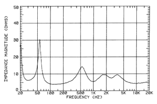

A speaker's impedance is NOT a finite, hard number. It changes as the frequency changes. The JBL L890, for example is rated 8Ω.
And for most of the FR, it is or close to it. Its only from about 250 ~ 80 htz it dips to around 4Ω. But the HK AVR635 I had at the time could drive them with no problem. But when connected to a 220w amp via the 635 pre outs, the L890 certainly played with more authority from 250~80.

A short circuit is hardly a fair test!
But with respect I think you a flogging a dead horse. You are not going to find an 8 ohm speaker these days and you would not want one if you could.
To really estimate a the load of a speaker, requires the curve and phase angle and then you need cosine tables to actually see what the impedance of the speaker is at a given frequency.
Despite your previous post, nominal impedance is a useless term, and of no value in deciding the difficulty or other wise of a load. The average consumer is not going to be able to do that.
There was a paper a few years ago, that had the math and an index of load difficulty. The originator called it the amplifier torture test index. Industry showed no interest as you might expect.
Now lets put this in perspective. Her is is one of my three way designs, form three 8 ohm drivers. I used all known techniques to get the load as resistive as possible. Component count for each crossover ended up being 27. This is the result.
Now a budget speaker will not have a 27 part count. So having a go at speaker manufacturer's is tossing at windmills.
The receiver manufacturers could solve this easily, by quoting the power into 8 and 4 ohm. It is easy math then for most consumers to work out the current limitations of the receiver's amplifiers. They choose not to and that speaks volumes. So as Irvrobinson said in a previous post if you buy one of those cheap receivers: - caveat emptor.

Frankly any speaker that does not drop it impedance below 500 Hz to the tuning peak or peaks, you likely don't want.
The only devices that I know of that are inclined to go into reset, over heat and or blow up when confronted with four ohm loads or difficult phase angles are receivers. Most have lousy power amp sections that are not worth the time of day.

Clearly the Pioneer has used 16 ohm bass mids. These are not common at all with practically none on the OEM market.
I doubt the Aurum Cantus is fully BSC compensated. They are made by a Chinese OEM company and sold pretty cheap in China as Haihuang and given a fancy name in the west.
You have never designed a speaker. I can tell you that you have no or little control over the impedance. You have to take what you get when you are done.
My speaker I referenced would be 6 ohm nominal at least. I equalized the impedance as I was doffing the hat to Raymond Cooke who felt this was a good thing and used these techniques extensively in his later designs. However I gave up a lot of sensitivity and still need a big amp.
As I speaker designer I would expect amps out there to drive any speaker without blowing up. But as others have stated, I'm not sure if speakers are blowing up amps. If as you suggest they are, then the receiver manufacturers need to address it, as it is virtually impossible for the speaker designer to do so.
