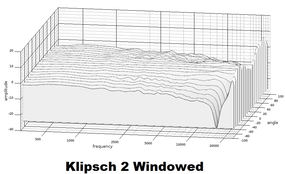

When it comes to the speakers influence on the room at midrange and high frequencies, I’m a big fan of controlled dispersion. Since the timbre we hear is a combination of direct and reflected sound, it’s important that the reflected sound is spectrally similar to the direct sound. The speakers I’m currently using have a controlled dispersion of +-45 degrees up to 14khz. within this 90 degree area the response measures nearly the same off and on axis. Further out than 45 degrees the high frequency response falls off evenly, with no major anomalies. The speakers are two feet from the side walls, 3.9 feet from the floor, and a little over 4 feet from the ceiling. Since these distances are well within the coverage pattern, the sound is more or less the same no matter the location in the room. The reflected sound is similar to the direct sound, and outside of normal aberrations at lower frequencies, I can measure a +- 5dB response from anywhere in the room.
All speakers will narrow in dispersion as frequency increases, and widen as it decreases, it is nearly impossible to build a speaker with perfect directivity because single drivers must cover frequencies that vary in wavelength in proportion to the diameter of the driver, however, reasonably good control over the highest frequencies can be achieved with horns and waveguides, while matched directivity across woofer and lower frequencies can be achieved through the use of multiway systems, and smart crossover points, a majority of systems are crossed over at 2.5-3khz, at frequencies this high, many 5.25” and 6” driver begin beaming, while the tweeter has a very wide dispersion because it is small in relation to the wavelength. Using a crossover lower crossover point can help maintain similar directivity between the tweeter and woofer, which reduces lobing off axis. Lenard from Lenard audio is a big supporter of 4 way systems for this reason. See http://education.lenardaudio.com/en/05_speakers.html
Another great article on directivity http://www.acousticfrontiers.com/category/blog/acoustics/speaker-directivity/
A speaker with increasingly directional dispersion at high frequencies , or worse, uneven dispersion and lobing, is going to vary significantly from room to room, and from seat to seat, a speaker with controlled dispersion, void of lobing off axis, will provide spectrally similar sound to every seat within the defined coverage pattern, and the effect on the timbre from room reflections will be minimal. A majority of cinema speakers are designed with a coverage pattern of 90x60 horizontal/vertical. The two major providers of cinema speaker systems are JBL and Klipsch, I believe QSC also designs cinema systems, but I don’t know enough about them to comment. Both companies have put a great deal of effort into achieving controlled directivity with an even off axis response across the coverage pattern. This is why the timbre sounds more or less the same regardless of whether you sit all the way in the left or right seats(horizontally off axis), or in the front or back of the cinema (vertically off axis)
Floyd toole advocates speakers with wide dispersion, geddes advocates speakers with narrower dispersion, but both of them agree on one thing, that controlled directivity and an even response off axis is paramount to getting good sound in room. I think for the purposes of home theater, where there are multiple seats, many of them at least somewhat off axis, a wider dispersion is desirable up to a certain point. A speaker can have a flat response on axis within 2dB, but if the response rolls off steeply at high frequencies off axis, or becomes uneven, you’ll never hear that flat response in a real room, because that ragged off axis sound is what will be reflected off the walls.

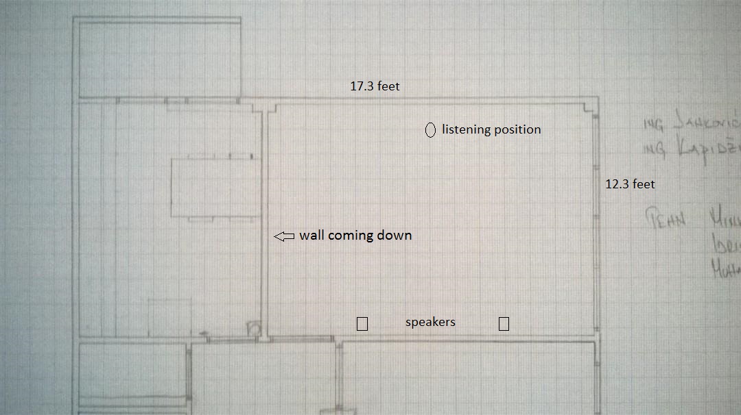

My room is not big enough not to matter. And "atomic shelter grade" concrete surely doesn't help.
What I did yesterday was to pull my speakers from the wall just for another few inches. I swear I'd rate them 15-20% better sounding. Even with my LP still being close to the back wall (as this is what the final listening arrangement will have to be). I think the shape is good, but it'll have to deteriorate slightly. One wall needs to be knocked down for non-audio reasons.
When that wall comes down, the right channel will have no side barrier, while the left will. We plan to connect the kitchen and the living room. The speakers will be removed from the back wall and one sub will be added. I'm suspecting the balance on my amp will always be tilted +1 or +2 in favour of the right channel just to keep the sweet spot at my LP.

Share what inputs you've made, and the exact placement of your subs in the room compared to the LP as well as what subs and how many are being used. A small room is just another room. Let's get it right!

Would you be able to rotate your whole orientation counterclockwise(as viewed from above) so it's on the 12.3' wall? That might give you some extra room to pull your speakers off the wall, and get the LP off the wall too.
