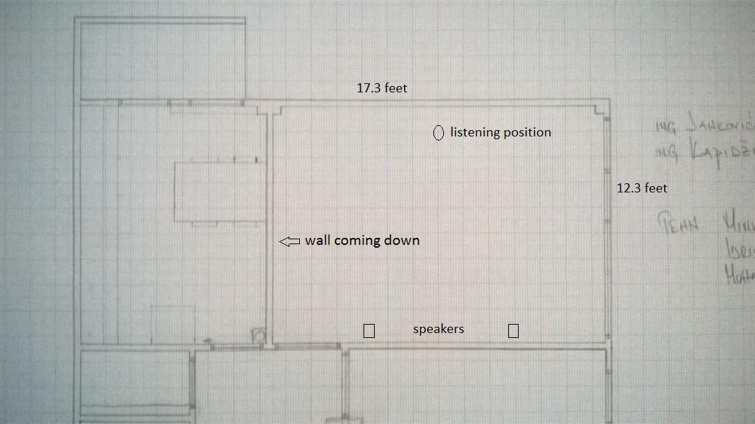

what dimension, shape and material is the ideal listening room?

Would you be able to rotate your whole orientation counterclockwise(as viewed from above) so it's on the 12.3' wall? That might give you some extra room to pull your speakers off the wall, and get the LP off the wall too.
He, that's an obvious solution, I've thought about it a lot, but it's not an option. One 12.3 is coming down and the other is wall to wall large windows and a central heating unit mounted on the wall. I also have a projector and at the moment I'm using the wall to project on (until I get a decent canvas screen). I watch movies on the 12.3 that will eventually come down because it's big enough and empty, I can have 125" screen, it's marvelous.
But if I do tear it down, the opposite 12.3 wall is good for nothing. Pulling speakers of the wall will not be a problem, they'll have their dedicated stands and at least 17" from the walls.

What I did yesterday was to pull my speakers from the wall just for another few inches. I swear I'd rate them 15-20% better sounding. Even with my LP still being close to the back wall (as this is what the final listening arrangement will have to be). I think the shape is good, but it'll have to deteriorate slightly. One wall needs to be knocked down for non-audio reasons.
When that wall comes down, the right channel will have no side barrier, while the left will. We plan to connect the kitchen and the living room. The speakers will be removed from the back wall and one sub will be added. I'm suspecting the balance on my amp will always be tilted +1 or +2 in favour of the right channel just to keep the sweet spot at my LP.
