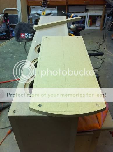

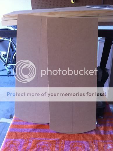

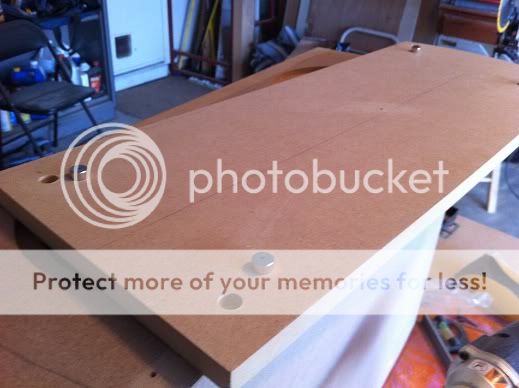

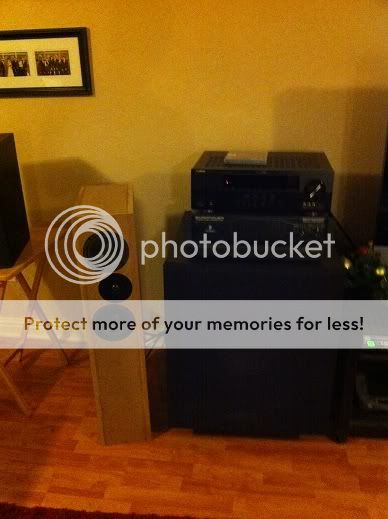

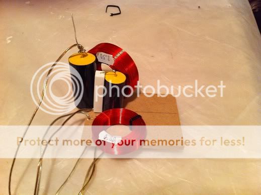

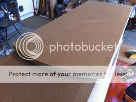

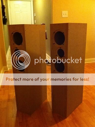

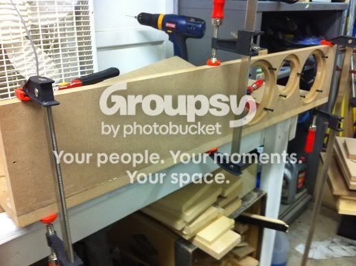

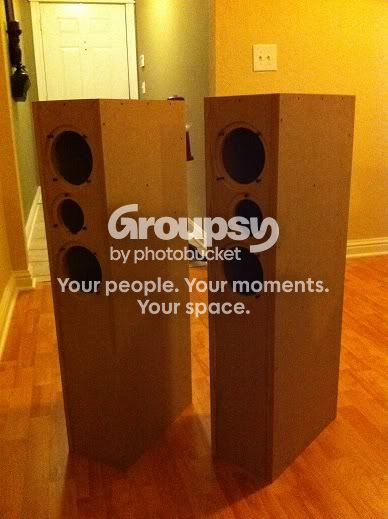

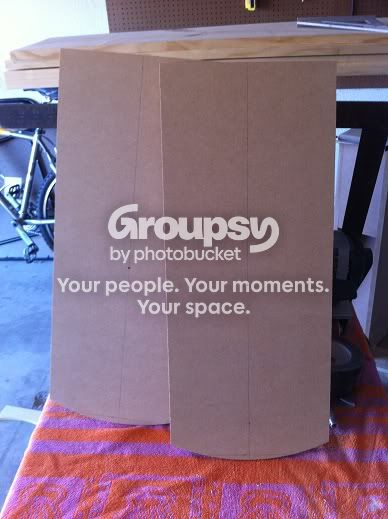

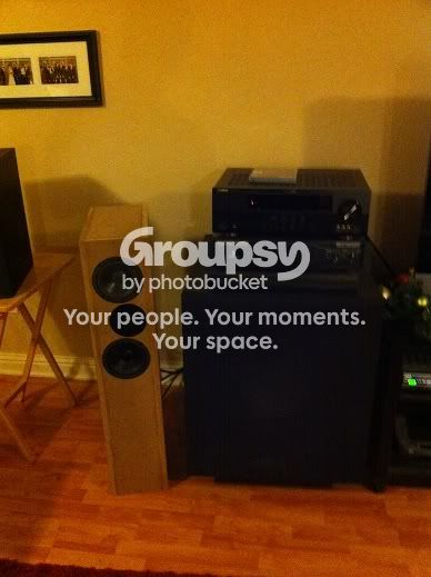

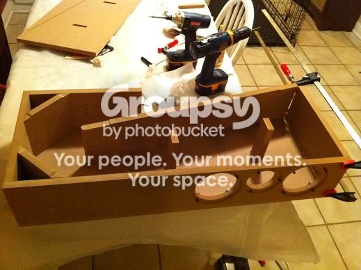

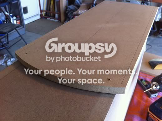

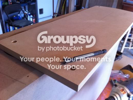

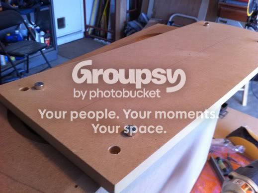

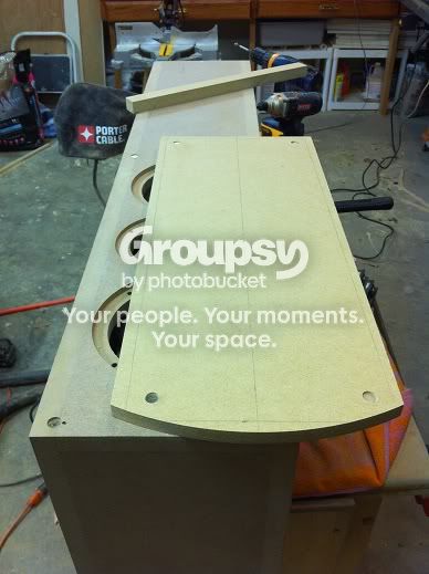

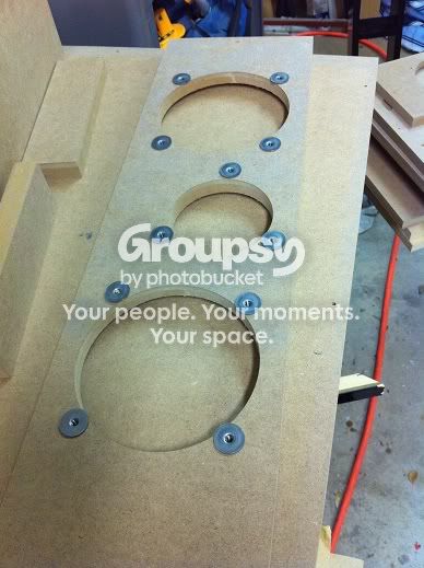

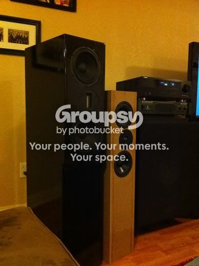

I built this TriTrix TL set for my Mother for Christmas to go with her new computer (I know I'm a little late :eek:). Also, my sisters like to watch movies off the hard drive so I thought they could use some decent sound. I've also been itching to hear these speakers for myself because they've gotten such great reviews and cost very little. The entire kit, including cabinets, was about $200.
Curt Cambell designed these and says they produce usable bass down into the 40 hz range, quite impressive. I was most surprised at how well they imaged and how low they played. I think they lack a little detail in the mid range compared to my other speakers but they're still a pleasure to listen to.
I'm currently powering these with the Sherwood RX-4105 Stereo Receiver
and they played very loud with very little distortion. I was really impressed. I would highly suggest this kit to anyone who is toying with building a set. Also, there are two very good video tutorials on how to construct the crossovers and the enclosures.

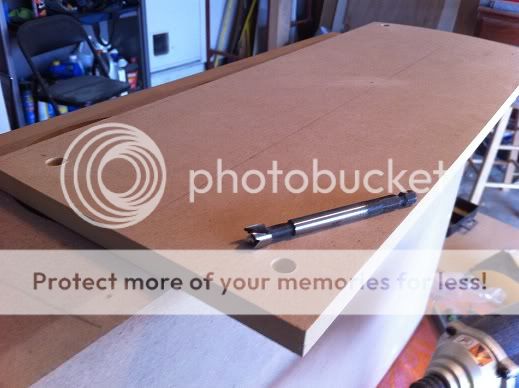

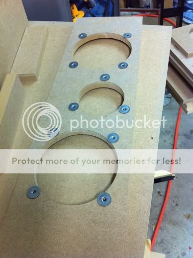

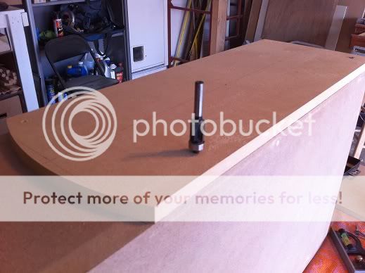

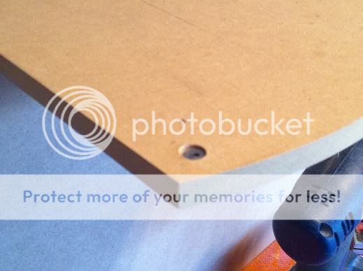

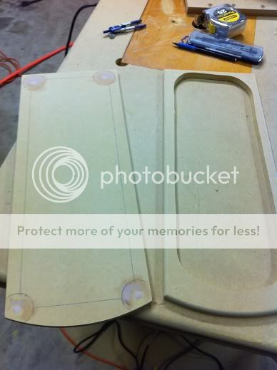

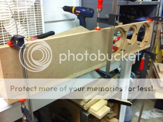

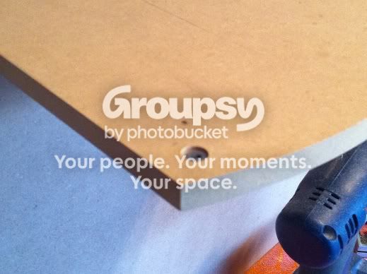

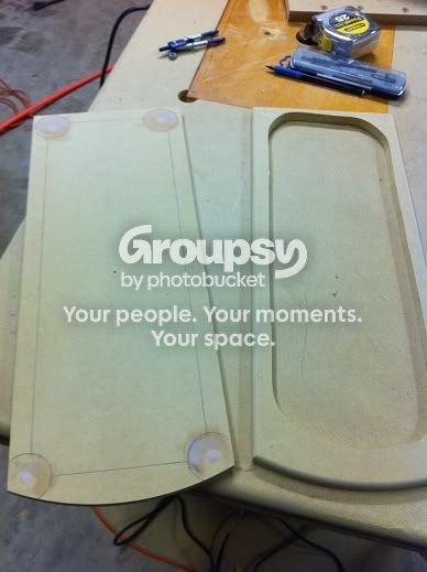

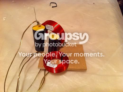

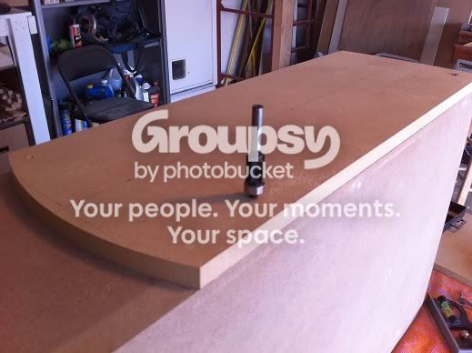

Here are some pictures of the construction process.

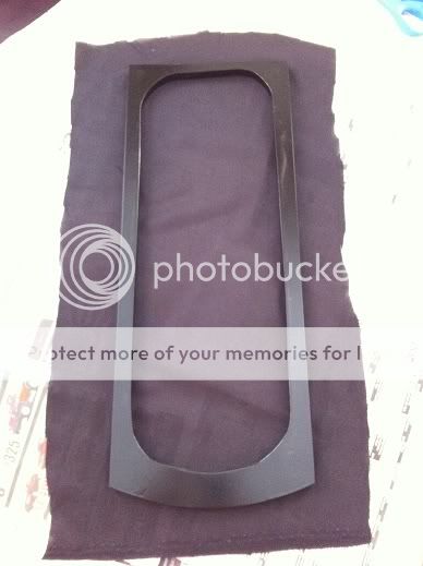

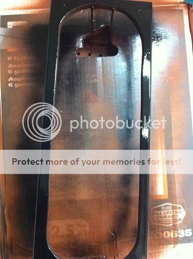

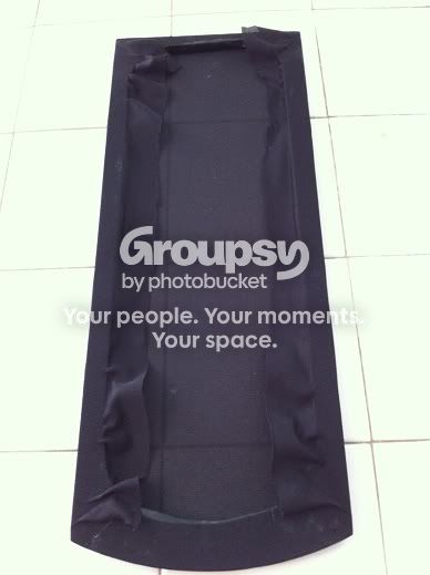

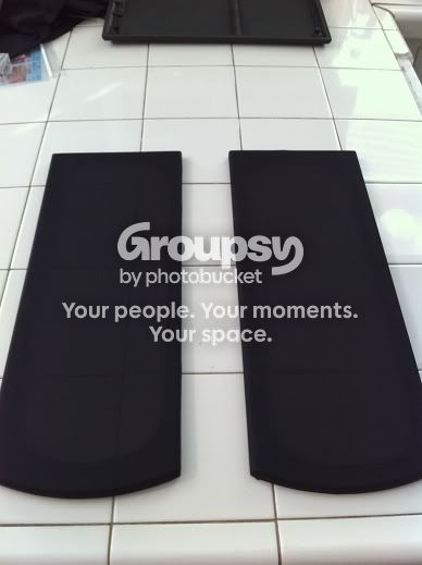

Wow ... that's amazing! The grill assembly is genius and looks killer.
Way to go. ;)
Swerd
Swerd
Sean - Great build photos - thanks!

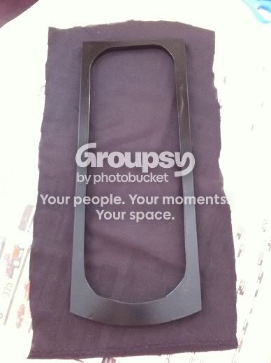

It looks like those grills are made from ½" MDF. Those magnets must be plenty strong enough to hold them up. Are they the ones PE sells? The grills I've done used much thinner (~¼" thick) masonite or plywood.
I like the use of hurricane nuts to mount the drivers, even for the tweeters :D!

Thanks! You should see the people's faces when I ask them to put the grill back on. You'd think I just showed them how to clone money. :D
Thanks Richard. Yes, the magnets are from Parts Express and they are STRONG. You can place one on each side of your hand they'll stay put. I was initially worried about vibration when the speaker are playing and thought they might chatter but they're solid. Great Value too!
I like the 1/2" MDF grills because it allowed me to put a small round over on them. It gives it a nice touch. When I was deciding how I wanted to construct my grills, I tried to get some ideas by looking online at what other DIY’ers were doing but there wasn't much out there. If you have any photos of your grills, I wouldn't mind seeing them.

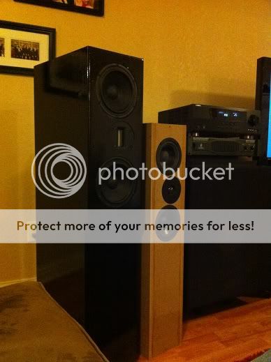

All the reviews say the same thing about how great they sound and how they're such a great a value and it’s true. The price really does add a level of enjoyment. I like to audition expensive gear when I go out to stores because I like to fantasize about stuff I’ll never be able to afford, much like car shopping. So I think I have developed a certain expectation when it comes to listening to new speakers. When I know the price of the gear, I have an even greater expectation (which is bad and often leads to disappointment) and that was part of wonderful surprise that the TriTrix offered. If you have friends come over who know something about audio, they’ll never believe you when you tell them how much they cost.
In my ER18 build thread, I compared them to the TriTrix and wrote a little something about them. I thought it was a little unfair to compare these because of the price/size difference but they are both MTM TL Towers. Just look at the size difference.

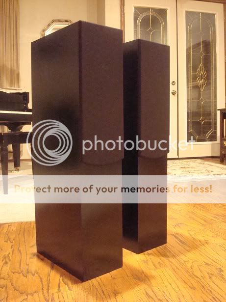

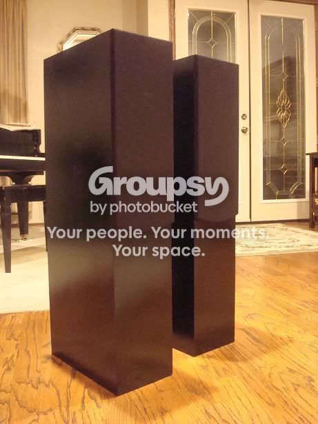

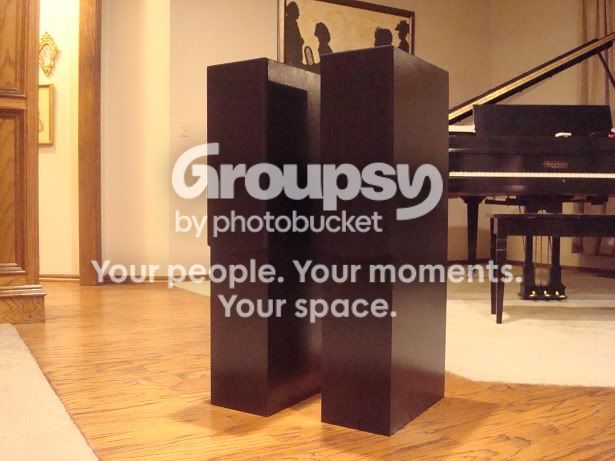

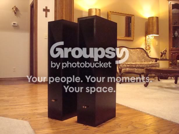

Very nice work, and they have a nice simple look to this kit. I didn't realize they didn't include grilles. I've been thinking about building a pair for my dad. I thought Matt34 was looking to build a pair of these also at one point?

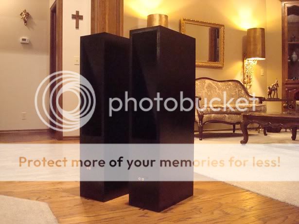

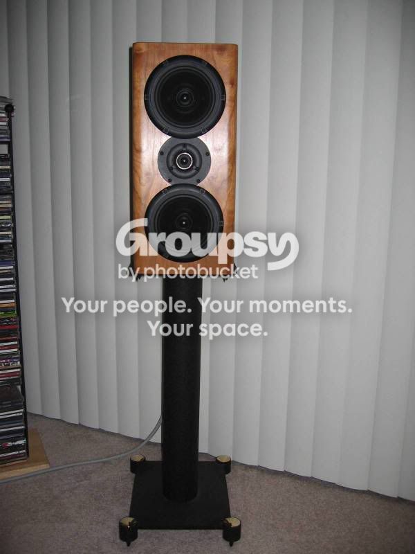

I've always loved that "no holes" grille look. Here are my mains. Note the lack of mounting also:
There are metal slugs flushed into the MDF just under the veneer and magnets in the grilles. The grilles are cut to match the edges of the midrange drivers so they automatically self center. I didn't build these, a friend of mine who happened to be the cabinet builder for GR some years back did them.
Great looking speakers there! I too am a fan of the no holes grill look. It gives the appearance they were made for being naked but wait, they're both.

I can't seem to get past that hidden magnet grill business. I'm thinking that little felt self adhesive sticky thingies on the grill magnets would work well to keep the grill cloth and paint from wearing. They have tiny little fuzzy wuzzies probably 1/4" in circumference at Home Depot.

Those fuzzy wuzzies are a good idea. My guess is that mom and the sisters aren't going to be showing off the drivers to their friends very often so wear won't be much of an issue. If they were in my house, I would need those pads.

For what its worth, Jim Salk builds his grills with the same hidden magnet method. On my STs, which I've had going on 3.5 years, there has been no visible wear on the paint on the front baffles. There are no fuzzy pads. There are four pairs of magnets involved, one in each corner of the grill, and four more buried under the front baffle that line up with the grill magnets. All together, they are strong enough so nothing moves when the grills are on. The grill cloth doesn't extend far enough to get between the magnets.
