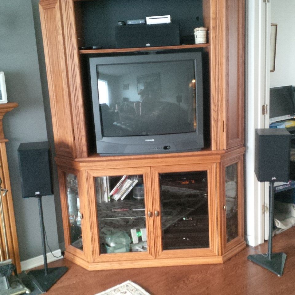

I need to post a pic tonight. I finally found one location where a center sounds good. I built a box and put the center out in front of the tv with the top just below the bottom of the tv and it sounds good. I just need to upgrade the center and I think I should be ok
