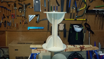

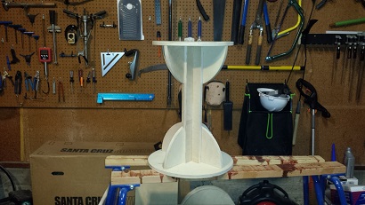

LOL I saw the pics on your sub thread and was wondering where that was going....
I made a stool out of some of my old sub leftovers, wanted to use the less useful baffle cutouts particularly. So your pic may inspire something else now....
LOL not sure I'd read the whole thread, but yeah I think I even made a thread for that too....think that puts you in a fairly small group having read the whole thing.
MrBoat
Must have been a link to the stool in that thread. I recall you saying the seat could have been smaller, again, IIRC.
It is large but large drivers need large cutouts... Now if I'd built the 12"s first I woulda had some more choice....
MrBoat
LOL. . .that's the first thing I thought was, that's what you get for using larger drivers. I remembered eyeing the cutouts for the drivers in the cabinets and it being large. :D
