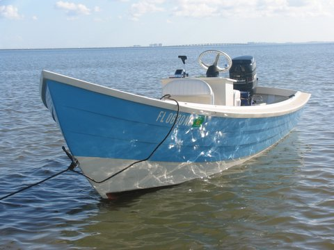

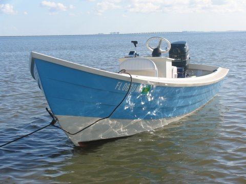

It's a worthy project and thank you for the kind words. I am surrounded by a lifetime of DIY and my career/s have always involved building things. My mom reminded me here recently of how when I was younger, I used to go pillage the scrap piles on construction sites always bringing wood home and building things with it.
Now I work in marine fabrication. When it came time to get a boat, in spite of all the boats I work on, all the deals I could have gotten just from being in that network, I opted to build a wood one. I could not find a factory boat that suited me in my price range. Found an old set of plans from a museum, and spent all my nights out in the back yard with the 'possums, owls and coons into the wee hrs.
More a glutton for punishment than skilled.
What ever floats your boat. :p
Sorry. I couldn't stop myself.
Speakers are one thing. But if you can build a boat, you are seriously skilled. That's an age old, honorable craft. I feel like I should have a famous quote ready. Sorry. All I can do is say I am seriousLynn impressed

Well, it's again, not all that revealing. Where I grew up, people built wood boats in their back yards all the time. The other thing is, most people can do anything they want as long as they don't have to make a living at it.
I was taught woodworking in a rather crude, yet profound way. An old man I used to pal around with set me down with a dull pocket knife, a bolt of wood, and a board with a hole drilled in it. Said to make it fit the hole. When I complained about the crappy knife, he handed me a sharpening stone. Anyhow, that's it in a nutshell. Start out with sharp tools, your parts a little bit bigger than they need be, and manicure them to fit. . . . eventually. :D

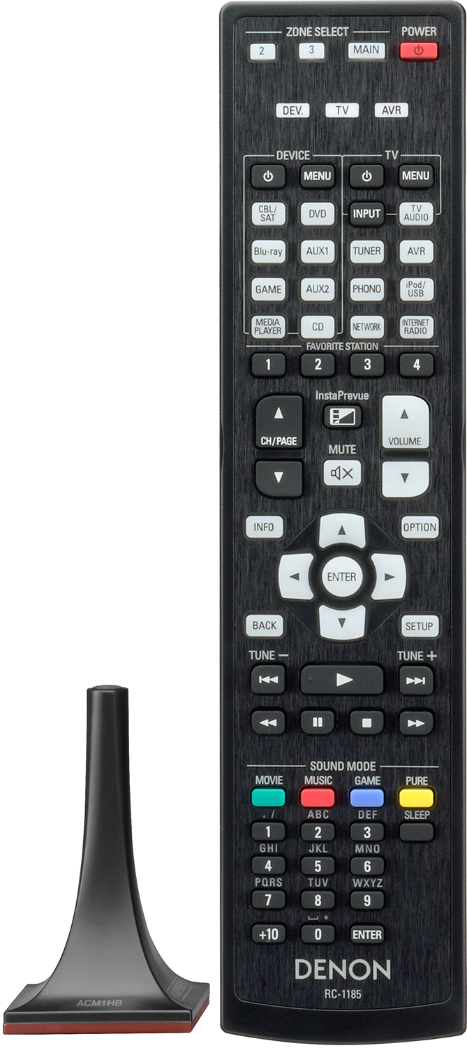

I was hoping to look at the RC for your unit and see how it manages different setups, but given looks to be a touch screen remote, it is harder to know what controls it offers.
My older Denon has buttons on the remote for "Music", "Movie", "Game", and "Pure" like the colored buttons on the remote below.
It sounds like you only use yours for Music, but you can program the Music, Movie, and Game settings however you like. I'd bet yours has a similar feature, and you can setup the volume of the sub at different levels. For example, you might program the "Movie" setting for the sub to play volume matched with the rest of the system, the "Music" setting with sub at -3dB for songs recorded a little bass heavy, and "Game"setting with sub at -6dB for songs recorded a lot bass heavy. Essentially, you are using these controls to have remote control of you sub volume! For me, remote control of sub volume is very useful. It took me a while of envying the people who bought subs with remote controls before I recognized this feature could do the same!
Also note that since your mains have solid bass, you can play with your crossover frequency to allow the sub volume to be effective at the frequency that works best for you. IOW, my old Sansui '79 AU-717 had buttons next to the bass control to determine whether the bass control was effective at 400Hz or 200Hz. With the crossover, you can look at the above sub volume control as a "sub-bass control" which is effective at 50, 60, 70, or 80Hz.
