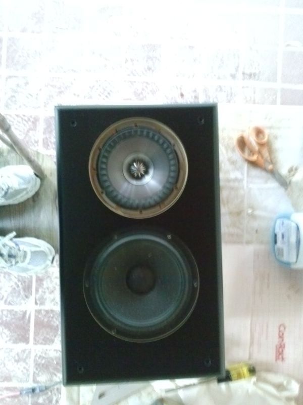

Speaking of teases, the drivers are mounted and Dennis will be beginning his work before too long. The ER18 will have a net of about 16L to work with, and a 2" diameter port w/ 6" in length for a tune of ~45Hz.
Look at them just floating in mid air...I'll bet they'll sound magical!:D :eek:
Dennis is definitely an audio wizard, though I'm a little concerned about his focus; he's talking about making soup out of it all, and I'd really just like a pair of speakers :D
