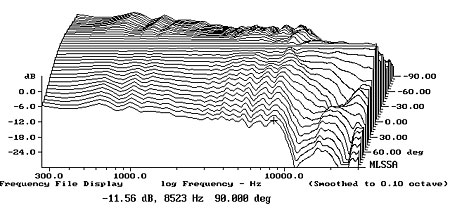

Limited by electronics? Lack air above 8K due to directivity? Congestion and lack of coherence in the upper bass?

The lack of air above 8K can be seen from the Stereophile measurements. If you want the airiness over 8K you can always go with the Revel F228Be.
Irvrobinson
Irvrobinson
My hearing is good to at least 16KHz, and there is no "lack of air" above 8KHz. In fact, I have the tweeters on my Salon2s set to a reduced output setting, which is probably due to my room not being as dead as most are because we don't use draperies. One of the methods I used for adjusting the system was recording various cymbals in the room, and playing them back to compare the output to the live recording, and the Salon2 makes the recordings sound quite realistic. Also, unlike some Salon2 owners, I do prefer the tweeters aimed at my listening seat rather than straight ahead. I find imaging is more realistic that way, but I think people who point their speakers straight ahead need more tweeter output. (A guy in my neighborhood uses Salon2s in his dedicated HT room, and I noticed he had them pointed straight ahead, I suspect to increase the perceived size of the sweet spot, which I don't care about.)
I do find that the Salon2s draw a lot of criticism from people who like speakers with saddle-shaped response curves. (The B&W 80x series comes to mind.) In my limited experience nothing convinces them either; recording comparisons to live sounds or measuring their systems and showing them how far their systems deviate from flat. I gave up any such discussions with friends about that a couple of years ago.
Soundstage's measurements don't show the upper treble off-axis drop off to be quite as severe, although it is there. Those who want to hear very high treble should listen near direct axis. The thing is, most of the people in the market for a speaker like this, older men, don;t have very good hearing in that range anyway, so who is really being affected by this? What's more, there isn't that much important content in that range anyway. One other point is that higher frequencies are less subject to room reflections, so a dead room vs lively room wouldn't matter as much for frequencies in this range. Another thing, the Performa F228Be isn't that much better in very high frequency dispersion.
The Performa F228Be looks worse...
