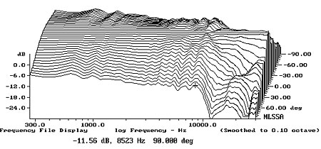

If any speaker is going to have a wide sweet spot (outside of omnidirectional speakers), it will be the Salon2. Their off-axis response is superb:

where does one find that off axis response curve? I'd like to see that data for other speakers too!
Ascend Acoustics and Philharmonic offers such measurements for all their speakers off the top of my head.
That is indeed impressive (the above is for 45, 60, and 75 degrees). Here is the graph of on-axis, 15, and 30 degrees:
However, the best off axis performance I have seen is the Philharmonitor BMR. The red trace is on-axis and the green trace is for 80 degrees off axis and never deviates more than 5dB!
http://philharmonicaudio.com/BMR Philharmonitor.html
