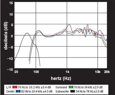

Note, that they used the SBS-01's as mains but did cover the SCS-01 for the center channel speaker. I use the identical SCS-01's for my mains as well, but in vertical position. SVS sold those as SCS-01 (M)'s, which were pretty much the same exact speaker as the center, just reconfigured for vertical placement. So the grill's logo is at the bottom and the terminal posts on the back are vertically oriented vs. horizontal. Otherwise same exact speaker.

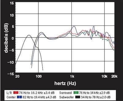

TLS, which speaker was that FR curve for? I assume it was the SCS-01? I'm confused. It seems to contradict the graph from the bench test KEW posted. Although there is indeed a trough in that octave, it's not nearly as severe as the one you posted. Maybe one or two db in a gentle slope but certainly no where near -10db.
Edit: Sorry maybe "contradict" isn't the right word. The general shape is the same, but that severe dip in your graph is clearly not represented quite as significantly in KEW's.
Actually the curves are very similar, the octave smoothing is different. My curves were by Tom N. He said the center measured almost the same but did not publish it.

Actually the curves are very similar, the octave smoothing is different. My curves were by Ted N. He said the center measured almost the same but did not publish it.

Not sure what you mean by "octave smoothing", could you define please? I just see two graphs representing different measurements. Yours obviously has a bit higher resolution, containing the logarithmic scale (though the other is logarithmic as well looking at the Hertz axis and values they represent) but I see your -10db lag beginning to fall off at the 250Hz mark (82db to 72 db), whereas the other one from the Sound & Vision bench test requires more of an estimation in that range because it's not marked, but I see at most, a dip beginning around the 1kHz to 2kHz range and sloping down to maybe a -1, -2db level around what seems to be the 200-300Hz region, then coming back up again before falling off past the low frequency limits of the speakers.
Octave smoothing is the flattening out of wiggles in the response done by the measuring program. If you use no smoothing, you can't see the wood from the trees. 1 1/6 octave smoothing which I suspect Kew's is, makes everything look a bit better than it is. A 1/24 or 1/12 octave smoothing is more honest. I would bet the curve I posted is 1/24 octave smoothing.
Anyhow your report of how the speakers sound is compatible with the curve I posted.
TLS, where did you pull your curve from? I'm curious - the one KEW posted was from Sound & Vision which I see get referenced a lot here for their independent bench tests of AV products. So it doesn't seem like they have any kind of stake in the game other than to provide an honest, accurate set of data - I've no reason to mistrust it. And the lack of warmth and mid-bass presence could very well be represented by the Sound & Vision graph too. One notable thing, your graph seems to have a peak between about 250 and 300Hz, which I have always found (through mixing music) to produce a rather "boxy" sound. I usually cut these frequencies by a few db to soften that undesirable tonality. The speakers may lack in certain areas for sure, but they have never sounded boxy. That's at least one audible inconsistency with your graph.
I'm certainly not challenging your finding in any way to be clear, I'm just trying to better understand the differences in numbers I'm looking at between these two graphs and where to better place my trust in the numbers being represented. You stated earlier that in order for my old AVR to offset that -10db loss in that band it would have come at the expense of my HF drivers, which simply never happened in the 9 years I owned that setup. The Pioneer made it work. Somehow. I don't know how but it did. :)

Lets look at the FR.
Top line is 1 meter, lower is the listening position. The purple line with the 29 Hz peak is an artifact, I'm certain.
These speakers are starting to fall off at 250 Hz. They look to have inadequate baffle step compensation. This may be to try and keep impedance near 8 ohm, or to prevent thermal damage, quite likely both. Then there is a sharp tuning peak at 80 Hz to try and paper over the the deficiency. I would bet these speakers sound distinctly on the thin side.
They actually need crossing over at 250 to 500 Hz. That deep 10db notch between 80 and 250 Hz will be highly audible. That is over an octave and a really crucial one at that.
The speakers are of low sensitivity, which will compound thermal compression issues when trying to push the speakers.
I am sure if he ran Audyssey XT32 Sub EQ HT properly (I believe he did), the 30-200 Hz range would be looking much better, especially when his L/R are actually SCS-01(M) that has two 5.25" woofers and a larger enclosure (almost 50% larger) than the SCS-01's.
