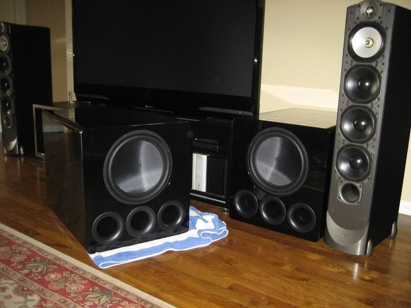

Yep, I loved this driver and sub:

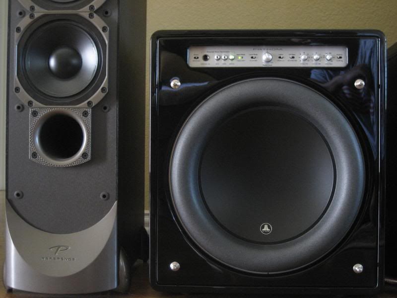

This one was good:

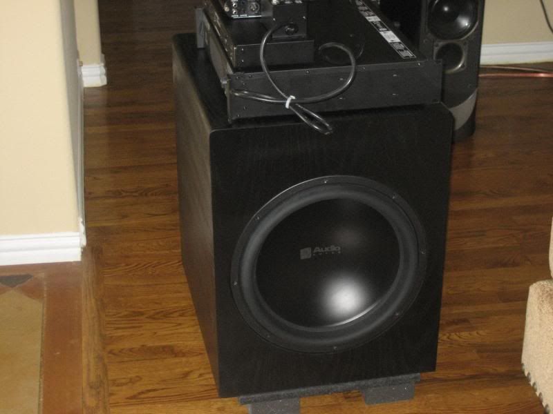

This was likely the most expensive and worst:

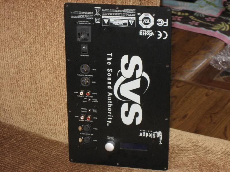

And this one stayed:
