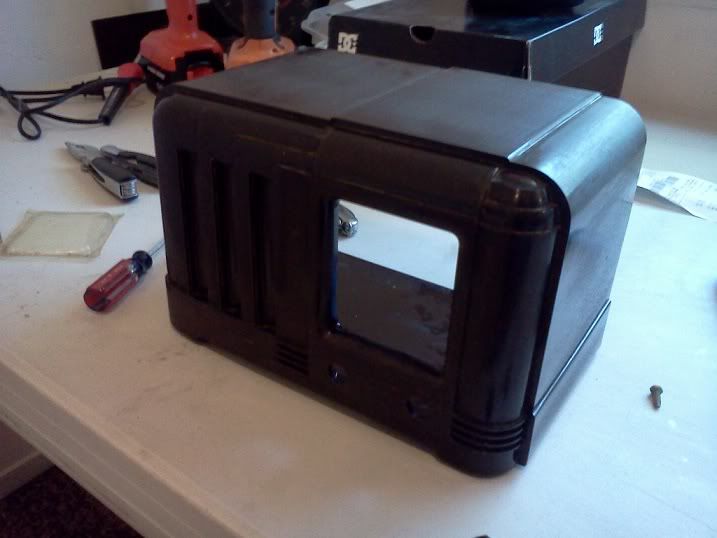

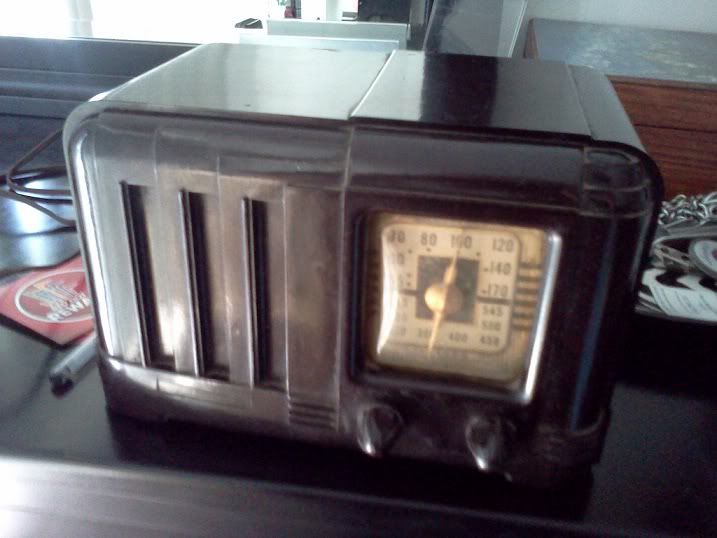

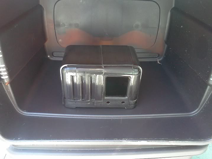

Started with this:
1948 Arkay Build-it-yourself type tube radio.
The board was fried and none of the tubes lit. $15.00 on Ebay.

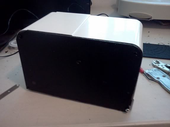

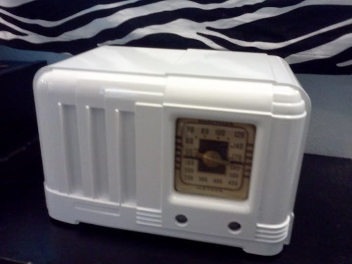

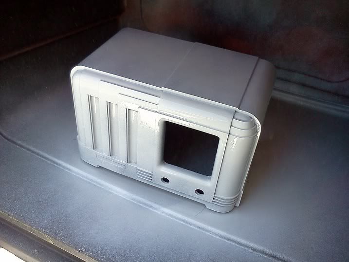

Took it apart to "hot rod" it. Sanded with 220, then 400 (wear a mask) bakelite is part formaldahyde...
Dust coated about 5 coats of hard white gloss.

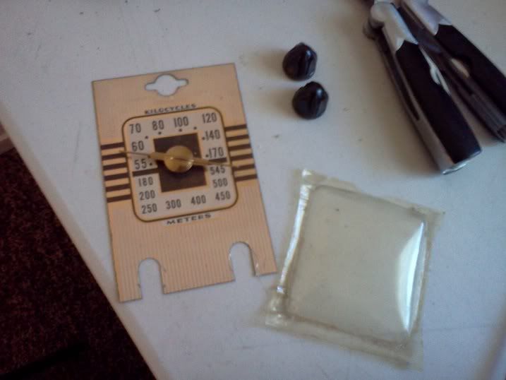

Cleaned up the little display pieces and knobs:

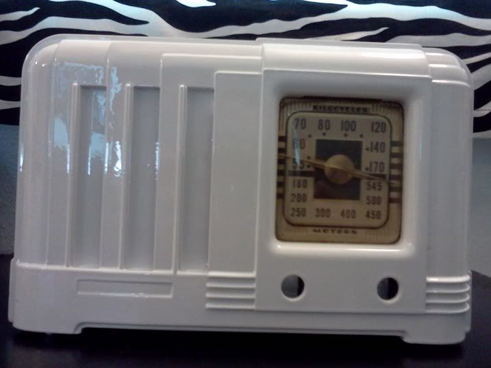

And then cleared, waxed, and assembled

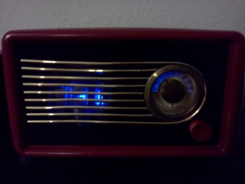

And then ordered the "sub" off ebay. A 1951 Airline Montgomery Wards radio, also in bad shape.
Pulled the face plate out, and removed the burned up tube holder with cut wires everywhere (mess)
I wrapped black fabric around it, then added some car molding trim, that you can get from pep boys, around the dial and across.
And painted the cabinet classic red
SOme quick 12v led backlighting:
Serj22
Serj22

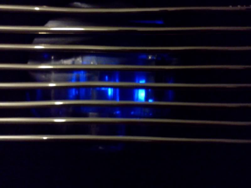

Then cut a hole where the speaker was originally, and put some of the tubes on a wood block behind it, and set blue led's behind them:
I thought it looked interesting.
Ignore the warped trim, I fixed that right after...
BOught some ABS from a warehouse in town and made a frame for the speakers, and a backing:
The subwoofer I just glued inside the red radio. Assembled both and adjusted the volume knob on the Arkay to work with the amplifier from the speakers. Then I added Pandora to the mix, turned on the 1950's rock station, and to my great satisfaction, it sounds ancient and plastic-y and distant, much like an "old" radio would be with terrible speaker vents. I love it.
