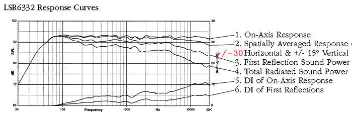

I don't know, not a JBL fan, even if they measure better. I wouldn't mind hearing a pair, there are a few Guitar Centers near me, so I could check them out. I have to go out of town tonight but I'll look into them when I get back.
You probably won't be able to find the LSR6332s at a guitar center. The LSR6332s are about accuracy above all, check this graph out:
The on-axis response is just dreamy, but the off-axis response is more impressive. You will have a difficult time finding a more linear speaker at any price. MAYBE the M2s are more linear, and that is a big maybe. Of all manufactured speakers, the LSR6332s are among those that I admire the most. Extremely flat response, highly uniform off-axis response, THX PM3 certified- meaning they are certified to mix THX sound tracks on, not just reproduce. They were used in Harman's reference room for years. And, while not cheap, they do not cost an arm and a leg. They are like buying a Salon2's performance but without the pretty looks. One of the best choices for those who want pure performance for the dollar.

I'm not a fan of any particular brand, in fact I didn't even consider Klipsch until their newer series came out because of the brightness, but if a speaker achieves a flat response, constant directivity with a flat off axis response, all while being capable of reference level output into a large room, it's basically met all of the requirements of a perfect speaker.
The maximum SPL of the LSR's at 1m is rated at 102dB. At 3m, which is close to the average 10' distance for home theater viewing, that translates to about 95.5dB. I've measured the RP-150m's outputting 105dB with a maximum of 3% THD (3.17% THD at 76hz) from 63hz-20khz at a distance of 3m. Above 200hz distortion never exceeds 1.5% at this level. Obviously I don't have an anechoic chamber, however with room treatments I have a +-5dB response unsmoothed at the listening position (9ft from the speakers), which is as close as I can get for a living room. Since we're comparing based on a speakers ability to accurately convey what was recorded, reference level listening requires a 105dB output of each individual speaker at the main listening position, if the JBL's are truly limited to 102dB @1m, that rules them out.
I am not sure where you are getting your information from, but the LSR6332s are obviously well beyond playing 102 dB at 1m. Even the cheapy LSR305s would be well beyond 102 dB at 1m. I have seen the 6332s used in dubbing stages, so of course they can play much louder than that. They are mid-field monitors. They probably do not have quite the dynamic range of the Fortes, but I am sure in a typical living room they will get way louder than most people would ever care to listen at. I would not suggest them as an alternative to someone looking at Fortes if they couldn't stay clean at very loud levels.
