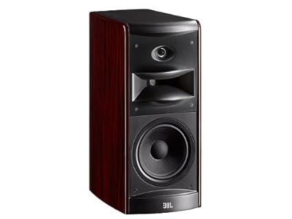

On a lark, I bought a pair of JBL LS 60's. I'm a sucker for a deal. These listed at $1100 each and are discontinued at $300.
https://www.amazon.com/gp/product/B001GQ3D88/ref=oh_aui_detailpage_o00_s00?ie=UTF8&psc=1
http://www.audioholics.com/tower-speaker-reviews/jbl-ls-series-speakers
When I researched these, there were a couple of interesting points:
1) Most speakers with horns let the horn carry all of the high frequencies, but here they cross to a 3/4" ring tweeter (super tweeter?) at 8kHz! I am wondering if the most audible aspects that distinguish a horn speaker will be effected by going to a more conventional (for consumer audio) tweeter?
2) Both the LS60 (6.5" woofers) and the LS80 (8" woofers) have the exact same compression/horn and ring drivers. Strangely the LS60 crosses from woofer to horn at 2kHz while the LS80 crosses at 2.5kHz! That is not a typo! The larger woofer is crossed at a higher frequency. From my reading, I gathered that the LS80 is designed to play louder and handle more power, but the compression driver could not handle the power to match the woofer and ring below 2.5kHz. IOW, in order to meet the Max SPL design criteria for the LS80's they had to cross to the horns at a higher frequency. I interpreted this as an indication that the LS60 probably sounds better than the LS80 as long as I don't need the greater SPL (and I won't).
3) At 87dB, the efficiency of the LS60 is not so great as I'd normally expect from a speaker utilizing a horn!
I would welcome any comments or experiences with these speakers.
