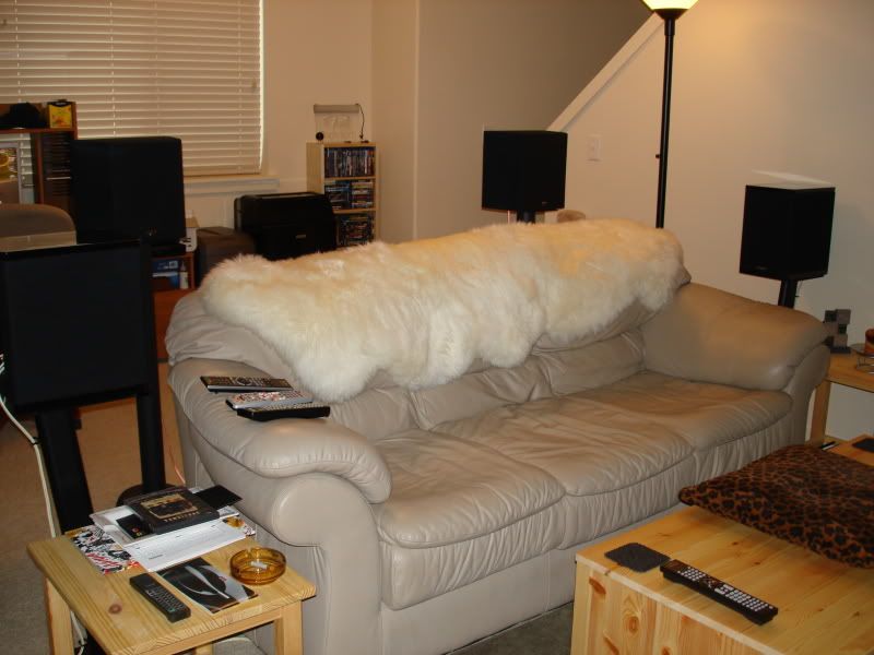

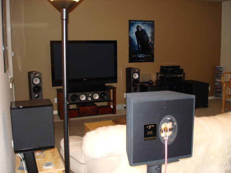

Well I think its time to take it to the next level even though i've been putting it off and get some room acoustic treatments and I only want to spend around 300 to 400 dollars so nothing to intense but just some basic room treatments and was wondering what brands would work the best and most economical im guessing Auralex is at the top of the list. Also placement as far as weres the best place to mount them for my application . i've attached some pics, also I'd like to mount them not with the tube glue but prefer Velcro or some type of hook system .I hoping to to get started with this project within the next month or so Any links and placement options would be much appreciated. Thanks in advance guys :)

My guess is as follows:
Directly behind the main speakers, vertically, on a hook. You'll have to move the movie poster, most likely.
Just left of the left speaker, below the thermostat.
Perhaps another behind your left side surround speaker.
Perhaps a 2pack of GIK 244, and 3pack of 242, totaling $320 before shipping. They also have (larger) room kits/combos, the smallest busting your budget by about $150 maybe.
If the 244/242, I'd use the 244s for directly behind the mains, and a 242 for below thermostat, another 242 for directly behind left surround, and the remaining 242 for somewhere else on that same wall.
Again, that's just my educated guess. Personally, I'd wait for b pape to chime in. ;) He may or may not mention the ceiling as a candidate.

Should they be above the speakers or directly behind them ? and should I use any for behind the subs ?
More as directly behind, than above. If it was me, I'd have them off the ground still if only for aesthetics. OTOH, where boundaries meet are places to become even a bigger bang for buck spot to treat.

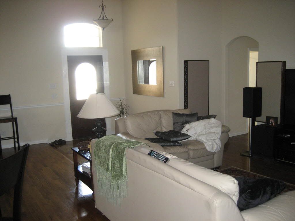

Now, if you want to go overkill, you could use GIK to do behind, above, and everywhere else. lol, as with rmk's PIC.

Yes you are correct but :p my speakers are a little over 3 feet so not by much :D I've saw pics were the bottom of the treatment pads are above the speaker and looks great, maybe i'll comprimise and go halfway behind and above since my lowest speakers sits a little above the halfway point in the box.

This is how I had mine. Excuse the various pictures as they were taken at different stages.
