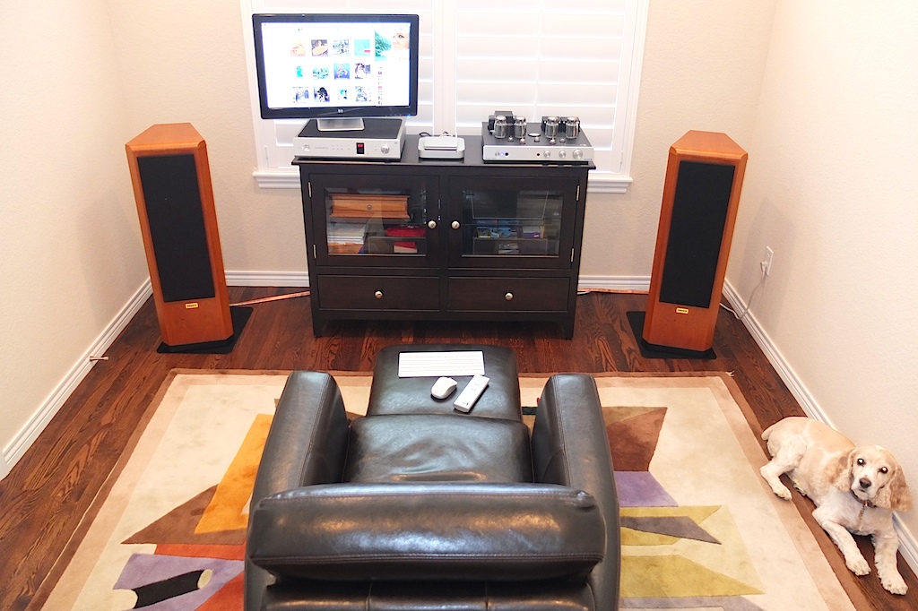

Here is a random photo I found just now searching near field. It was concentrating more on the sweet spot than the actual distance. The distance was adjustable to a certain degree.

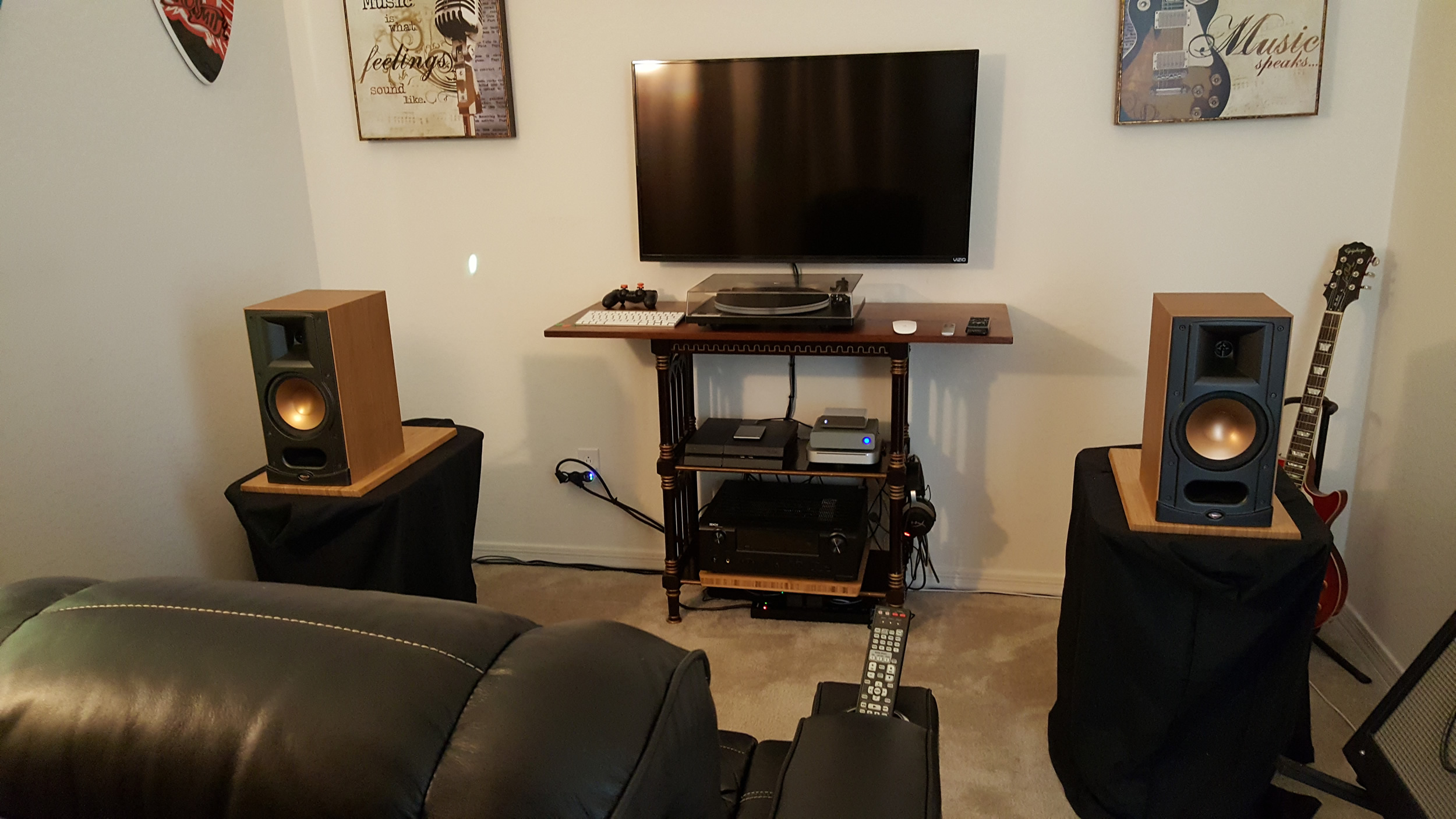

Mr Boat:
I will attach my picture of my listening space because I think it qualifies as a near field listening space.
My media chair, when fully extended and I have assumed the position, places my size 11's between the speakers. That to me, is near field listening. You could do it with your Tempests because you built them and you love them. But, if you were going to choose something new for a near field set up, you might choose something more timid.
What you have is awesome. How you enjoy it is also commendable and worth emulating. You also have some great music pumping out those Tempests. Mr Boat, you have a great setup and are wise enough to enjoy it amidst the chaos of life. It may or may not be near field listening as a technical definition. We are a dying breed.
Bucknekked
Bucknekked
Also, when someone says they are only interested in 2 channel listening for music. More often than not, they seem very cemented in that requirement. I think there's a reason for that. And I think a lot of it has to do with it being more easily obtainable in many cases without much technical sorcery and that perhaps resides somewhere between say, headphones, and surround sound.
MrBoat:
That's me in a nutshell. When I decided to take over a dedicated space for music I knew right out of the gate it was going to be 2 channel listening. This is a personal decision for me based completely on my own desires. I have tried and enjoyed many musical setups from simple 2 channel to having a room full of speakers all around. For my money, the best and purist musical sound is a well executed stereo.
You mention nostalgia for the day when we got together and listened to music as an actual activity. Certainly nostalgia plays a role because if I was just starting the journey today, I would probably have implemented a much more complex system. Why did I choose simplicity? There is a straightforward answer, but not a simple one.
MrBoat
Mr Boat:
