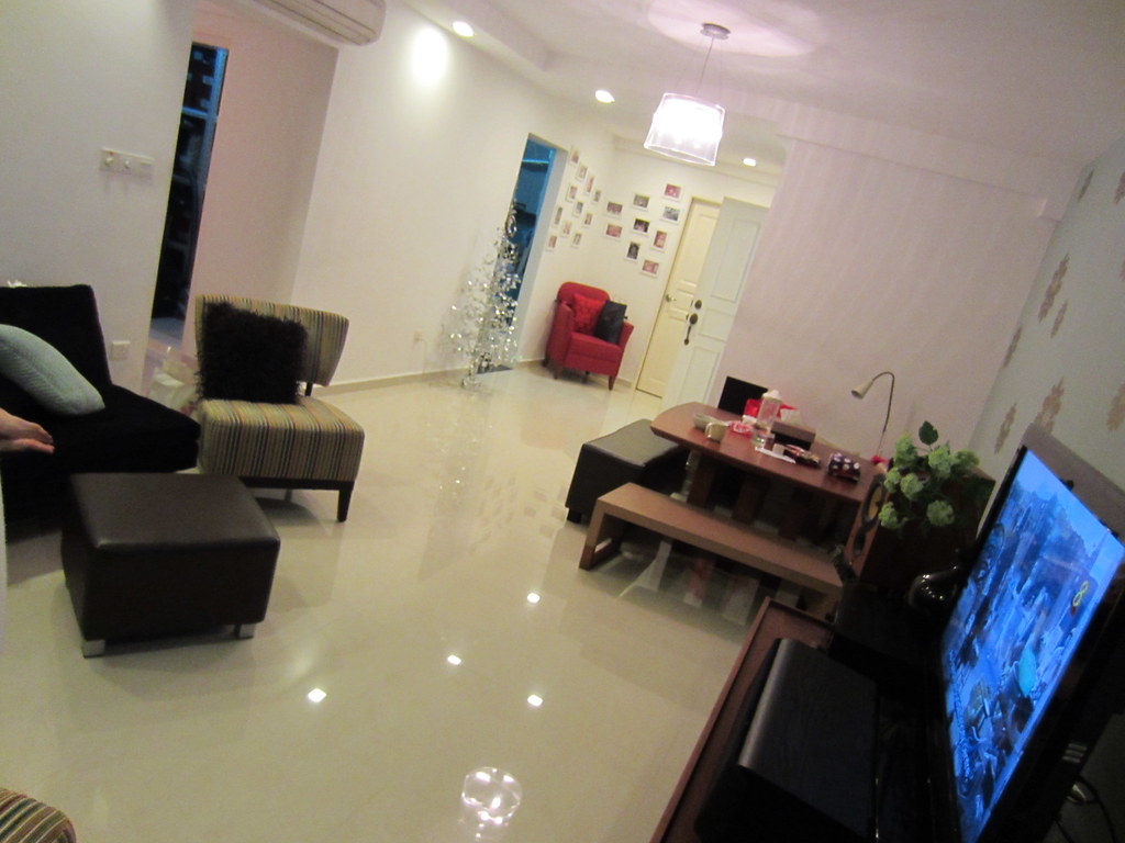

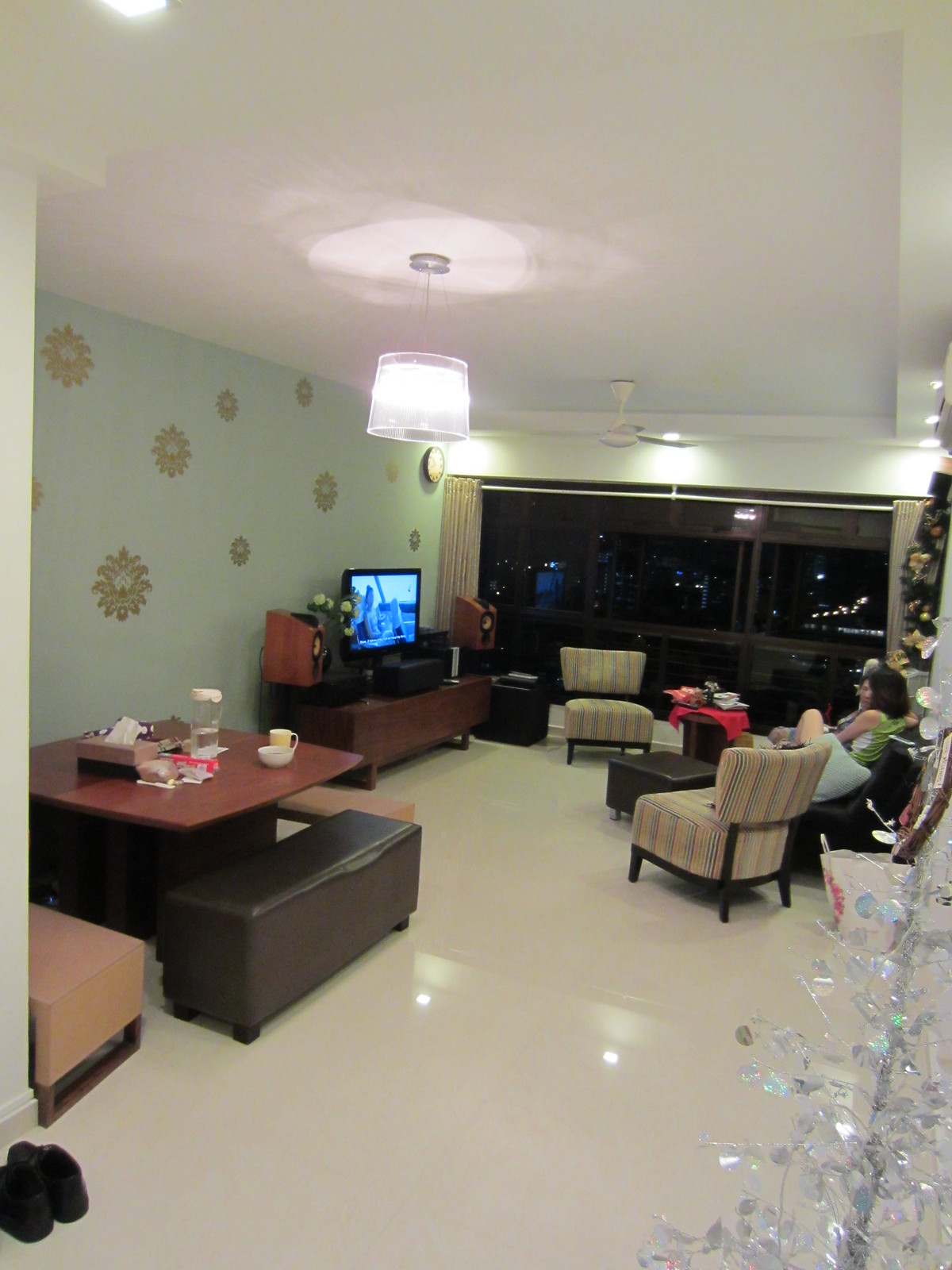

hi everyone, currently i'm using a 40" LCD and upgrading to a bigger TV for better HTS enjoyment. Most of my usage are for movies and concerts, no gaming and no soccer. For HTS, I have read and seems like plasma is better than LED TV for HTS? Have a few queries below...... :
1) Can someone help to share a little further what are the adv for plasma over LED? My current understanding is plasma is better in PQ, naturalism of colors and refresh rate, but LED is better in terms of power consumption and aesthetics, and no reflection?

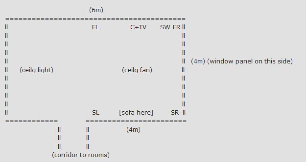

2) My setup is uncontrolled (as in my setup is in living room), and my TV console is kind of beside my window (with curtains), plus there are some lightings in the living room. I have attached layout and pictures below for better illustration. If i get plasma, would reflection be a problem in my setup? What are the potential issues that I will likely face in the day and night?
Photo 1:
Photo 2:
TheWarrior
TheWarrior
I would say get a plasma and rotate your entire living room clockwise. Those speakers are way too nice to be sitting that close to glass. If you position it all in the corner (or just to the right of the corner) you'll be able to enjoy your outdoor view, indoor view, and have a cleaner high frequency response from your speakers.

I agree that the room should be rotated to sit in the long direction.

Thanks warrior and westcott! Yes rotating it would make sense for the SQ. But unfortunately due to cosmetic and wife reasons, I guess the existing layout has to stay. And I have to make the best out of it.

Oh.... Are there plasmas with anti-reflective coating? Sorry for asking this basic question cos all along I thought plasma were all reflective panels. If it is then it would be good for me! haha :D
2. Regarding reflections, that's a function of the specific TV model and not the choice of technology (LCD versus plasma). I have a lot of ambient light in my living room like you do, so this was also important to me. One of the reasons that I chose my plasma TV (a Panasonic TC-P50G10) was because of it's anti-reflective coating.

There are hits and misses with both plasma and LCD, but with plasma it is the issue of bright rooms and reflections that cause the most issues I believe.
First, plasmas just aren't as bright as LCDs. They have better contrast, better black levels, and produce a better overall image, but when you are in a really bright room, they will never look as punch as a LED/LCD with the brightness turned up. They don't look bad, they just aren't as bright. They look a LOT better than rear projection which can't compete with daylight rooms at all. But, we don't really have rear projection anymore... So, it is plasma which is the 'weaker' display when it comes to brightness in a lit room.
Second, plasmas all have a glass screen. Some do come with an anti-reflective coating. This is a direct reflection issue. You sit to the left of your TV and there are windows right behind it, you will see those windows reflecting off the TV screen. The anti-reflective coating helps, but doesn't get rid of the glass which is still there. It just helps. We have windows to the right of our plasma and when I sit in the seats to the left I get reflections. I either move or ignore them. Likewise, at night, lights in the room can reflect off the glass.
It's a bit annoying, but I can turn lights off and I can move if I am really irritated (sometimes I am, so I do move).
