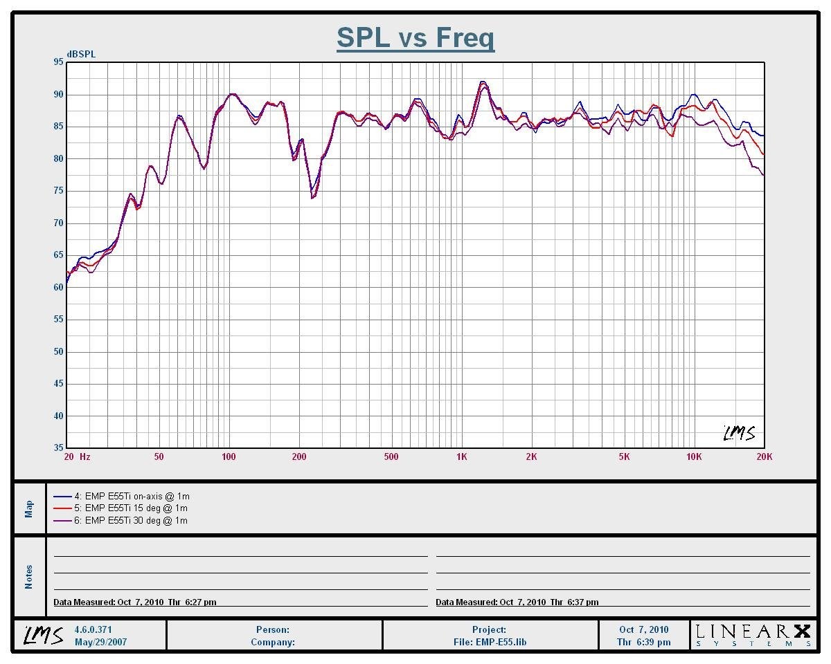

Gene's in-room measurement for Audioholics review:

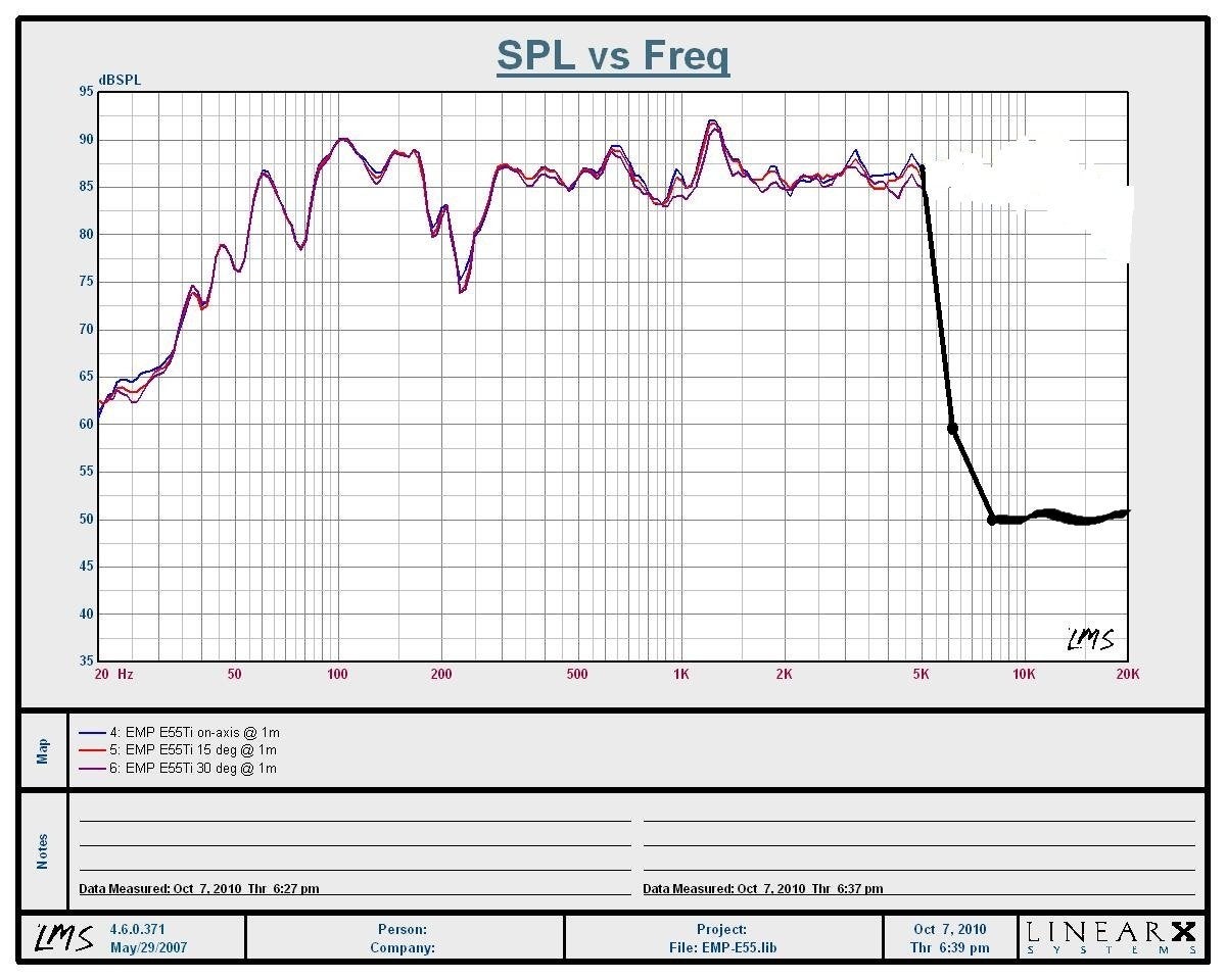

What my in-room measurement would look like in my room from 5kHz to 8kHz and out to 20kHz (applied to gene's curve; -25dB from 5k to 6.3k and another -9dB from that to 8k)
Could this be a result of a defective AVR? I don't remember these sounding this 'dull' on my Yamaha 663 (no eq applied; same room). I would think it 'could' be the speakers, but it's boosting the crap out of EACH of the 5 speakers up top. Not just the mains. Can anyone please help? My AVR warranty runs out tomorrow, though I've been contacting A4L for a month now trying to get them to contact me & they won't. Pretty shady, but I've got record of it so I'll call Denon directly. Anyways, any help is greatly appreciated!
