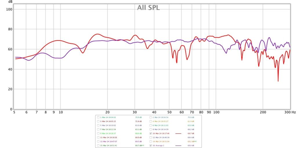

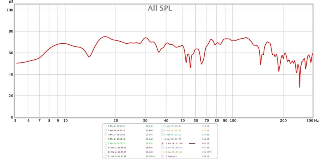

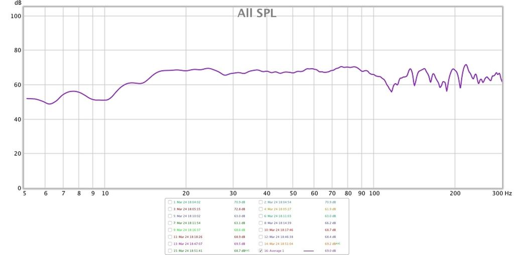

Got bored trying to recapture that magic of the miniDSP 2x4. This is where I ended up. All no smoothing.
Before Audyssey
After Audyssey (average of two measurements)
Overlay
fuzz092888
fuzz092888
Overall the system is much more balanced, the front L/R are no longer at -12, and I fixed something that was causing the center to blast as well. Subs are leveled much better than before as well.
