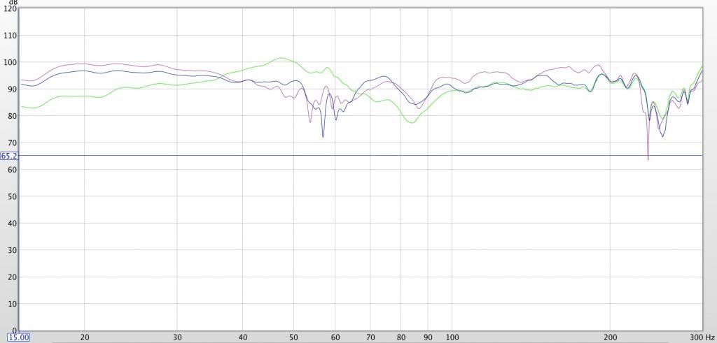

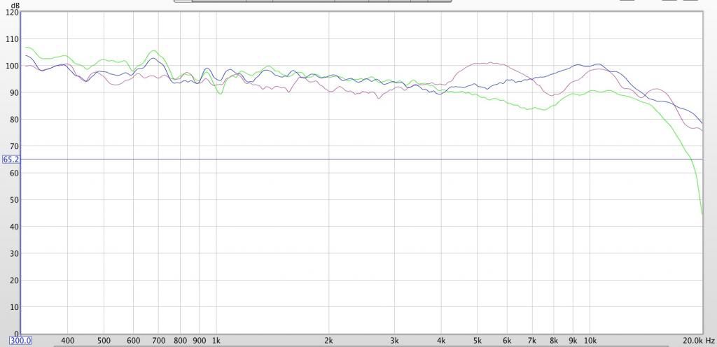

Challenge accepted.
The green trace is no audyssey, the pink trace is with 6 measurements from the main LP and the blue trace is from 6 different positions within 2-3 ft around the main LP. It's pretty clear to see that audyssey does a much better job of smoothing out anomalies when the mic is moved around vs staying at a single position. 1/12 smoothing.

Your green trace is better than most people's response even after Audyssey. Question, did Audyssey get the same number of measurements at the prime LP? That is, did you run it 6 times at the exact same spot to make it apples-to-apples? Second question, are these post-Audyssey results measured at the prime LP only?
But those things in mind, my chief argument for single-point Audyssey, or any Audyssey for that matter, is the bass regions 200hz and below. Your graph cuts off at 300hz. I'm not trying to be a jerk or a troll, but if more non primary LP measurements really is better at the prime LP... then my understanding of physics and Audyssey is flawed, and I want to correct it.

I took a measurement with my mic and REW. Then I ran Mult XT32 with 6 sweeps all from the main LP, after which I took another measurement from the main LP. Then I re-ran mult XT32 with the first measurement from the main LP and then moved the mic according to the audyssey directions from their website for a total of 6 sweeps. Then took another measurement with my mic and REW. All measurements with the mic and REW were from the exact same position as the audyssey mic when it was at the main LP.
Based on how a multi-point measurement did for the given range, why would you expect it to perform differently below 300hz?

Colors are all the same. Yet again audyssey multi-position did a better job of maintaing a tighter tolerance. I'll let that be my final word on the subject. No smoothing.

Challenge accepted.
Just curious, are these and your other measurements done as single-position REW measurements with smoothing, or multiple REW measurements averaged and smoothed?
The 300-20Khz measurements were single position, multiple measurements (since there it was only for the front L/R) that were then averaged and smoothed. The bass measurements are single position, no smoothing, with all subwoofers and the front L/R playing together (since that would have been 6 individual measurements that I didn't have time for). I believe without audyssey I had the crossover in the receiver set for 80hz and both times when I ran audyssey it set the cross to 40hz. So from 15-80hz on the green trace are the subwoofers and from 15-40hz on the other two are the subwoofers. From 15-50 on the pink and blue trace, the multi-position (blue) trace is obviously better, although not by a huge margin when compared against each other. However, when you take into account the original as well, IMO it is clearly the winner.

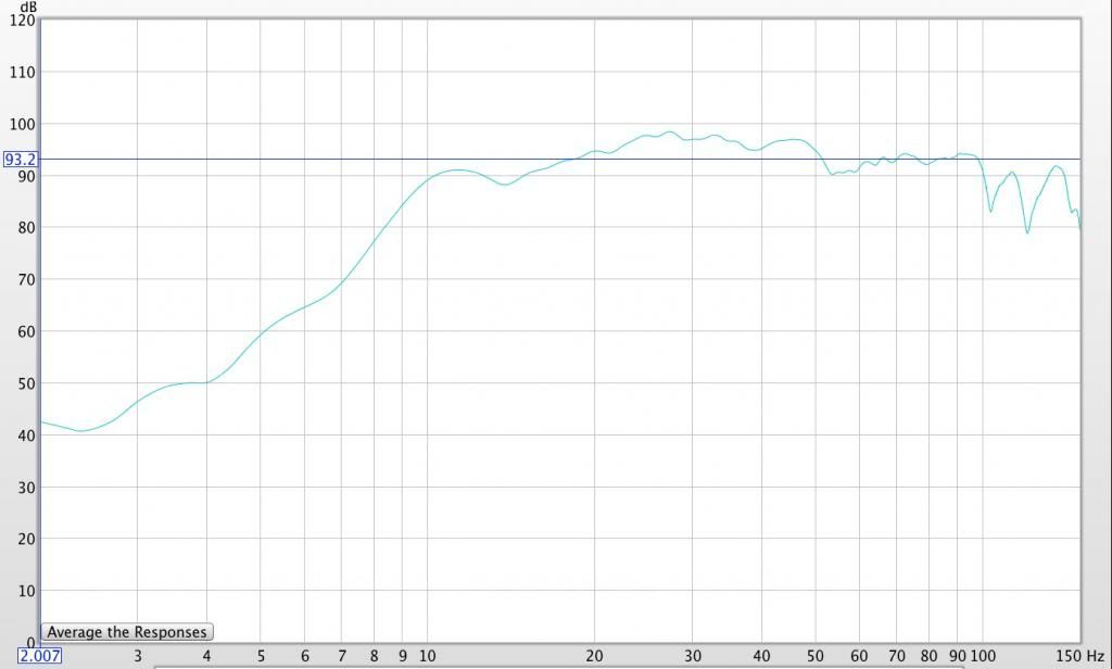

Thanks, but I should probably thank you as well. It's always a pain to set all the measurement equipment up, but since I had it out I spent about an hour and a half playing with the miniDSP and the big dual opposed. The bass response should be even better now now that I've gotten that thing to within +-5 db from 10-100hz. Someday I'll get around to redoing the other 3 subs as well and then I'll see how it all looks. FWIW here's what the DO looks like now, compared to the green line above. The other 3 might be causing the peak at around 47hz (on the green line) and the dip a little above 80 has something to do with the crossover that the receiver is doing. The rolloff below 10 on the graph below is a natural 24db/oct, there is not HPF.

You appear to be flat down to about 10hz? Jeesh!!! :) Warning, I heard the "brown noise" is between 5-10hz, so be careful or you'll soil yourself.
