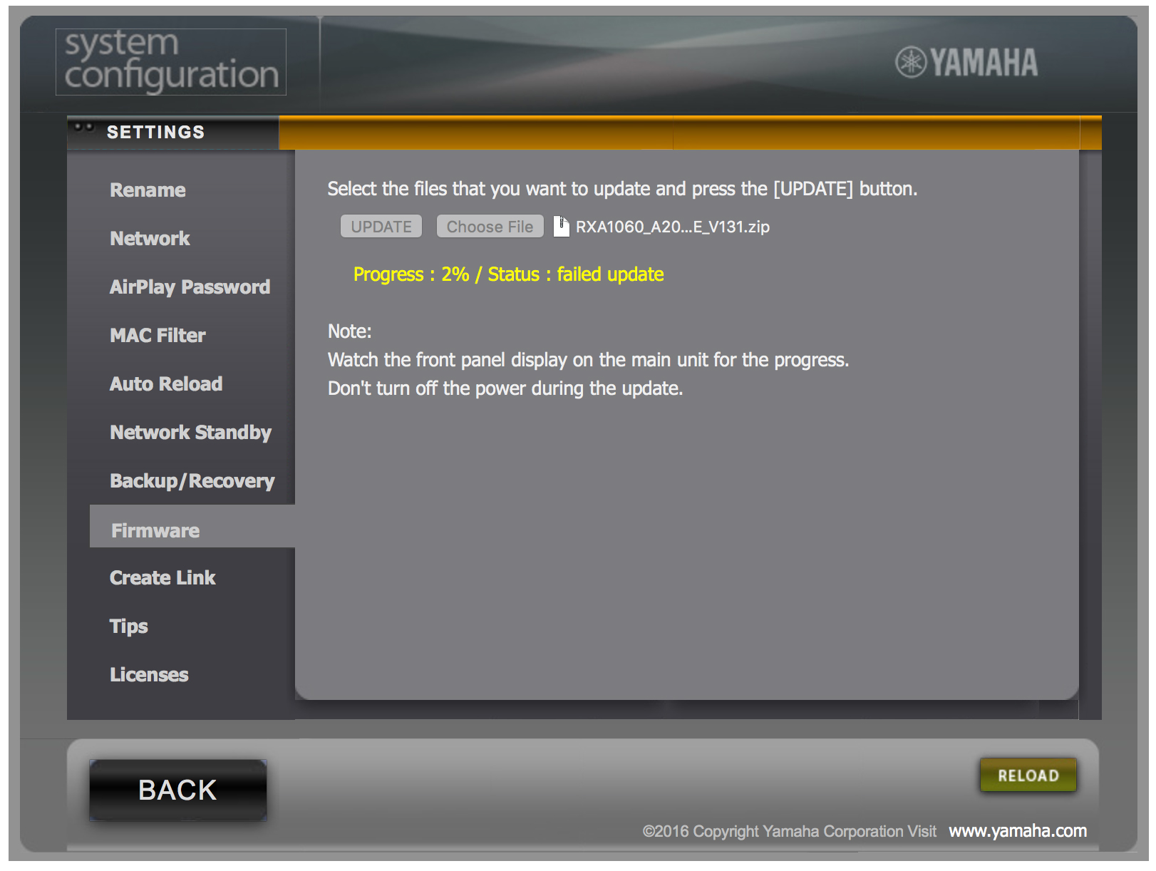

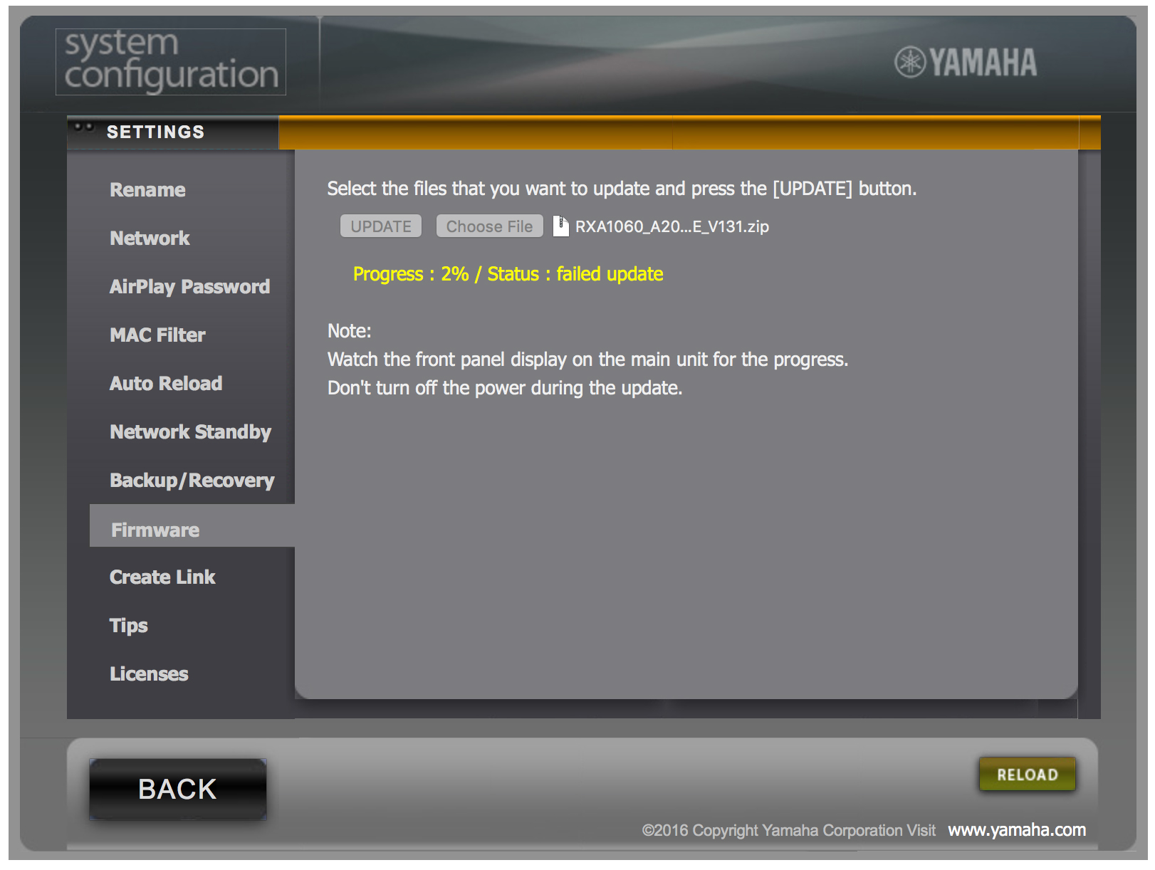

I accidentally chose the .zip file instead of the .bin and now I am stuck on this page.. the status bar on the avr says invalid file.. what should I do now ? I can't reload the page or go to another for its telling me by pop up it's updating the firmware..
Did you save the page shown in your next post before you tried to update?
Can you navigate to other pages?
I have seen updates fail when network/internet speed was slow or had dropouts- I would do an internet speed test to find out if that may have caused the update failure.

The tech guys just came and saw the tone test and said it needs to go to the workshop.. when I asked him about the cause he said its a firmware issue and they have some yamaha copyrighted file to kind of format the avr to it clean state which they will do.. then install a different file of the same firware i downloaded which contains no errors.. now Im waiting for thier feedback
At least they can do so themselves without shipping elsewhere. I do wonder why they simply don't offer you a new unit, or have you asked?

Seems strange to take it back to the shop to do a wipe and clean. They should have brought a laptop and did it on site. Hopefully it’s under warranty and they don’t charge you.
If it is fixable I can’t ask for a new one that is the standard policy .. if they couldn’t fix it then I’ll ask
