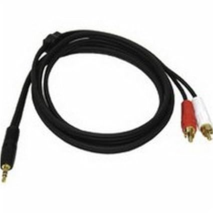

I do see what everyone means with the Blu-Ray feeding into the TV with HDMI and from TV a 3.5mm stereo to red/white on receiver because the sound is low.

- 3.5mm to RCA is not a good idea.

given the options, if you have a red/white analog audio output on your source, feed it directly to your receiver. That should be your first choice.
If that's not an option (like your Blu-Ray player), run the HDMI to your TV and take the TV's red/white analog audio out and feed it to your receiver.
Of course, this assumes your TV has a red/white analog audio output, like you said it does. If not, then you're forced to use your headphone output.
