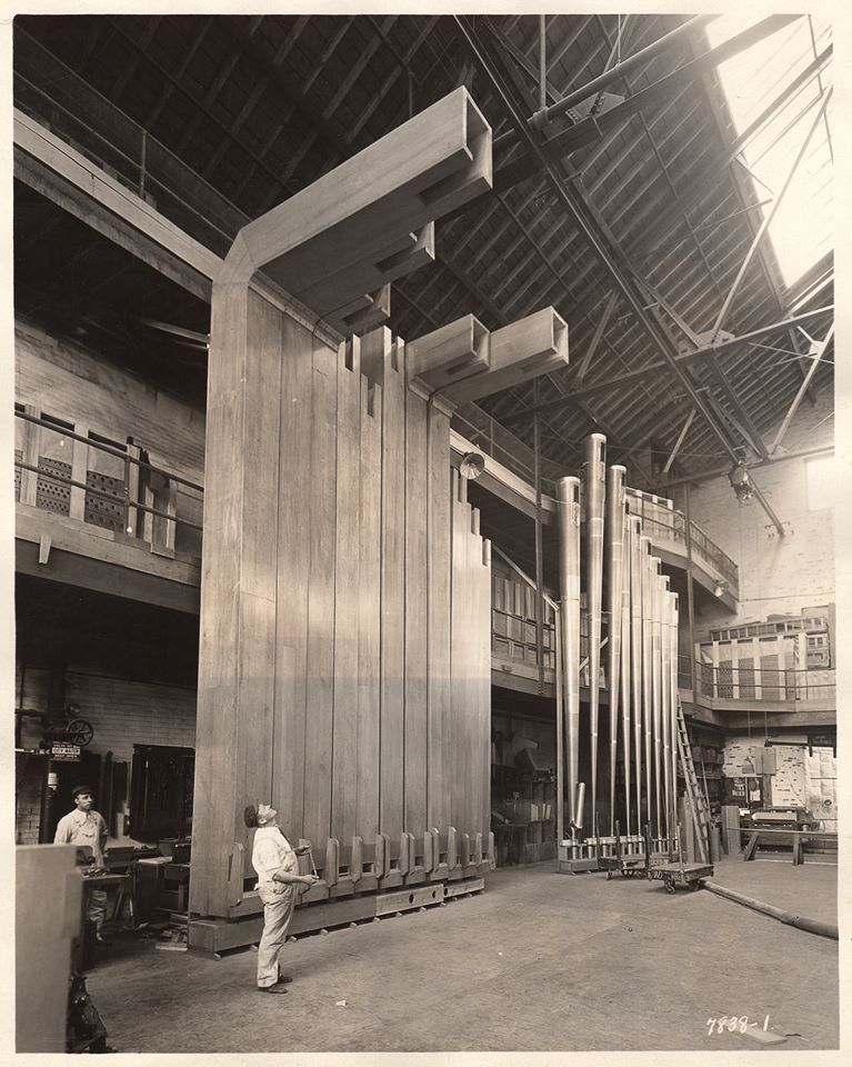

Well now, I am about to reveal something that maybe I would be wise not to divulge on a forum devoted to confirmed Bassoholics. Just today I received a completely unexpected $5000 cash Christmas gift from a relative. Suddenly I am feeling very flush. To tell you the truth, I am starting to scare myself a little fantasizing how much of that money I might be willing to spend on a subwoofer (or 2). Actually, the SVS PC-13 Ultra has caught my eye. https://www.svsound.com/products/pc13-ultra It plays deep, it's tunable, and it's relatively light (90 lbs). If need be, I could probably roll it into place and tip it upright (with the help of a buddy). So, gents, let me know if there are other subwoofers I should be considering (though the really massive models are probably out of the question for me...) Have a very merry Solstice Festival, one and all...!
32' Organ Pipe. Let's try to reproduce the sound it makes, with the help of a good subwoofer...

Well now, I am about to reveal something that maybe I would be wise not to divulge on a forum devoted to Bassoholics. Just today I received a completely unexpected $5000 cash Christmas gift from a relative. Suddenly I am feeling very flush. To tell you the truth, I am starting to scare myself a little fantasizing how much of that money I might be willing to spend on a subwoofer (or 2). Actually, the SVS PC-13 Ultra has caught my eye. https://www.svsound.com/products/pc13-ultra It plays deep, it's tunable, and it's relatively light (90 lbs). If need be, I could probably roll it into place and tip it upright (with the help of a buddy). So, gents, let me know if there are other subwoofers I should be considering (though the really massive models are probably out of the question for me...) Have a very merry Solstice Festival, one and all...!
32' Organ Pipe. Let's try to reproduce the sound it makes, with a subwoofer...
