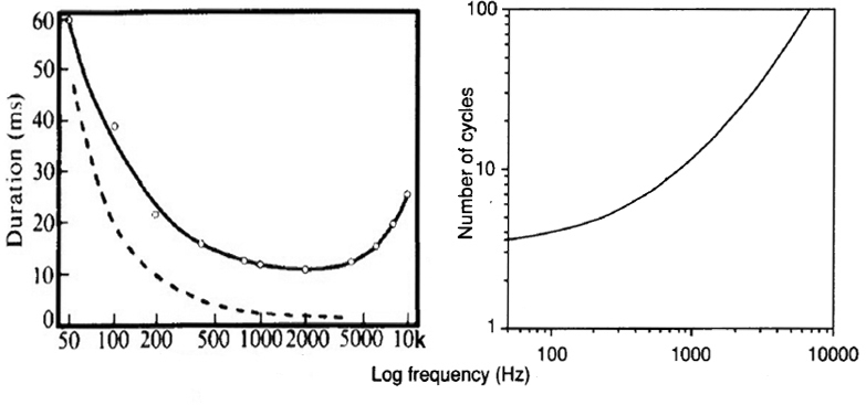

Here is an informative graphic related to the subject:
"Pitch also depends on duration. A tone must last more than a minimum amount of time (~10-60ms, depending on frequency and intensity) in order to sound more than a 'click' and convey a clear sense of pitch (see the figure, below)."
What this says to me is that audiophiles have a far greater estimation of the acuity of their hearing than the reality.
The duration of a tone to discern its pitch is interesting, but not the same as the duration of the decay to prevent music from sounding muddy.

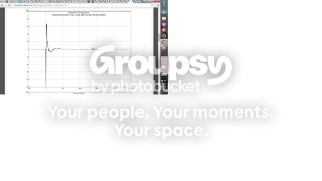

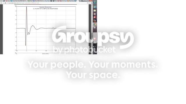

Lets keep it really really simple!
Here is impulse response for JL Audio E112 which did not sound good:
Here is Impulse response for XS15se which did sound good (to my ear):
I don't know if the above data reflects what I hear or is just coincidental, but the sound quality of the PSA XS15 is better than the JL to me. I'll welcome you speculation as to why that might be.
