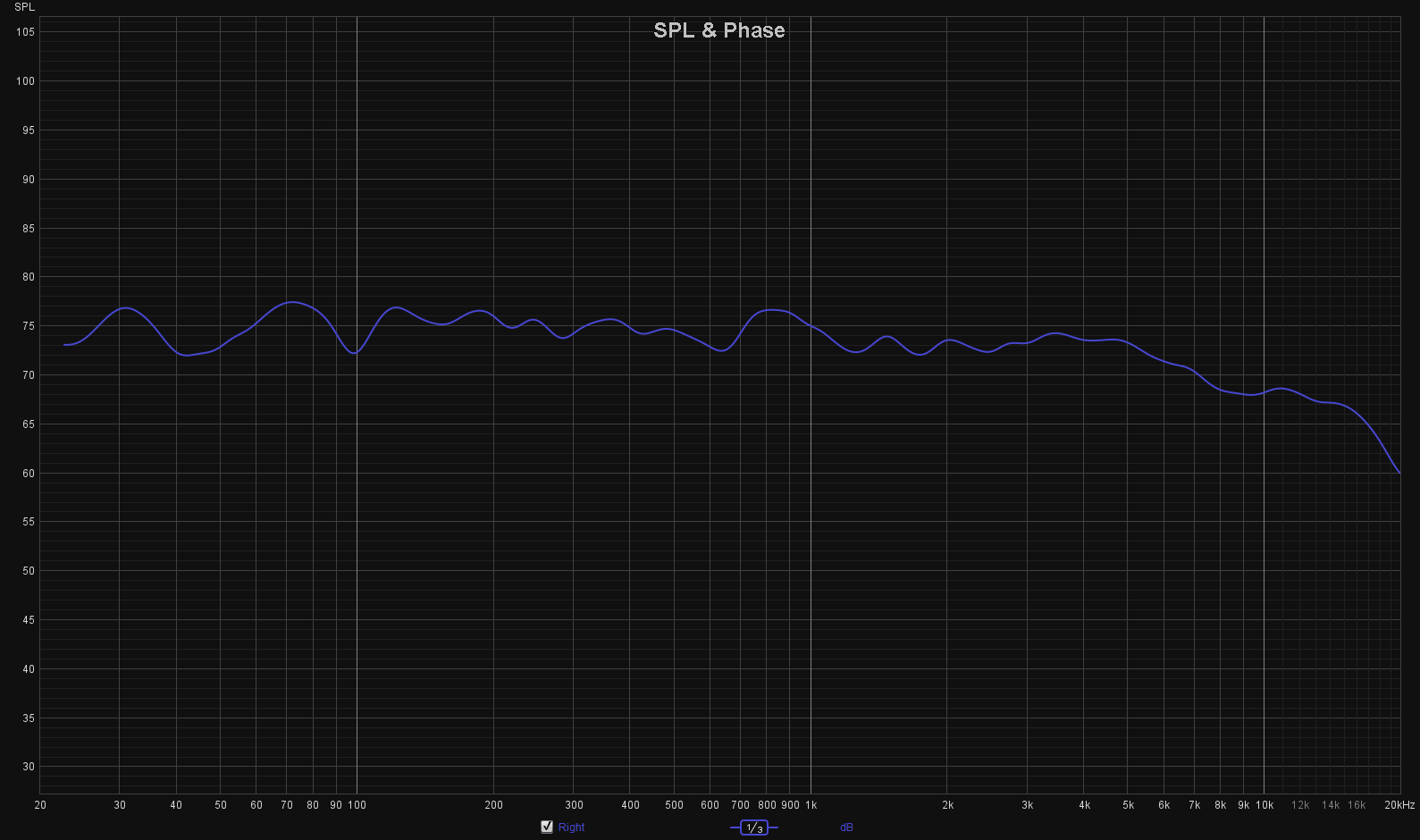

My room is 3.75m wide, 4.75m long and 2.35m high with my current speakers 55cm from the back wall and 45cm from the side wall.
You think that would give me enough room gain for the bass?
I would be driving the Arendal's with the Denon AVC-X4800H, given their 92dB sensitivity and 4 ohm load it should be sufficient enough?
I'm new to REW and made a couple of measurements a year ago with my old Onkyo TX-NR906 with Audyssey Dynamic EQ enabled.
I don't know if the scale is good, but it's from the front right channel which has the smoothest response.
I think the Arendals would work well in your situation. And if you end up wanting a bit more bass, all you need to do is move the speakers a bit closer to the back wall-- that tends to load the bass more. Angling the speakers to face inward or outward will change the soundstage somewhat as well, so you do have room to experiment.
Those are indeed things worth experimenting with. And the fact that they can be EQ'ed more easily, matching the desired target curve is also nice.
