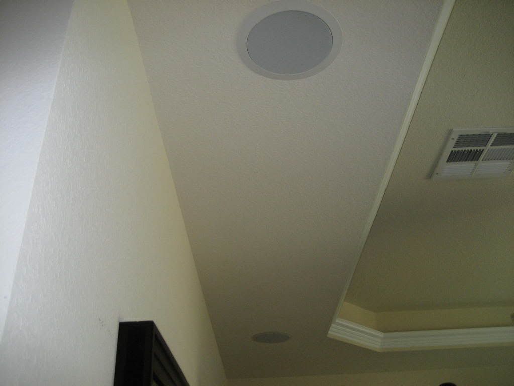

I also find that people try to do more with zone 2 and zone 3 than they really are able to, ending in frustration. You can't really do full distributed audio with just an AVR, you can only come close. Sometimes close enough, but usually not.
I took my AVR about to the limits of all 3 zones.
Zone 1:
Zone 2: Audio and Video
In ceiling of patio
This is zone 3 in the bedroom:
IR control:
It works pretty darn good for a multi-control set up; using just an AVR.
