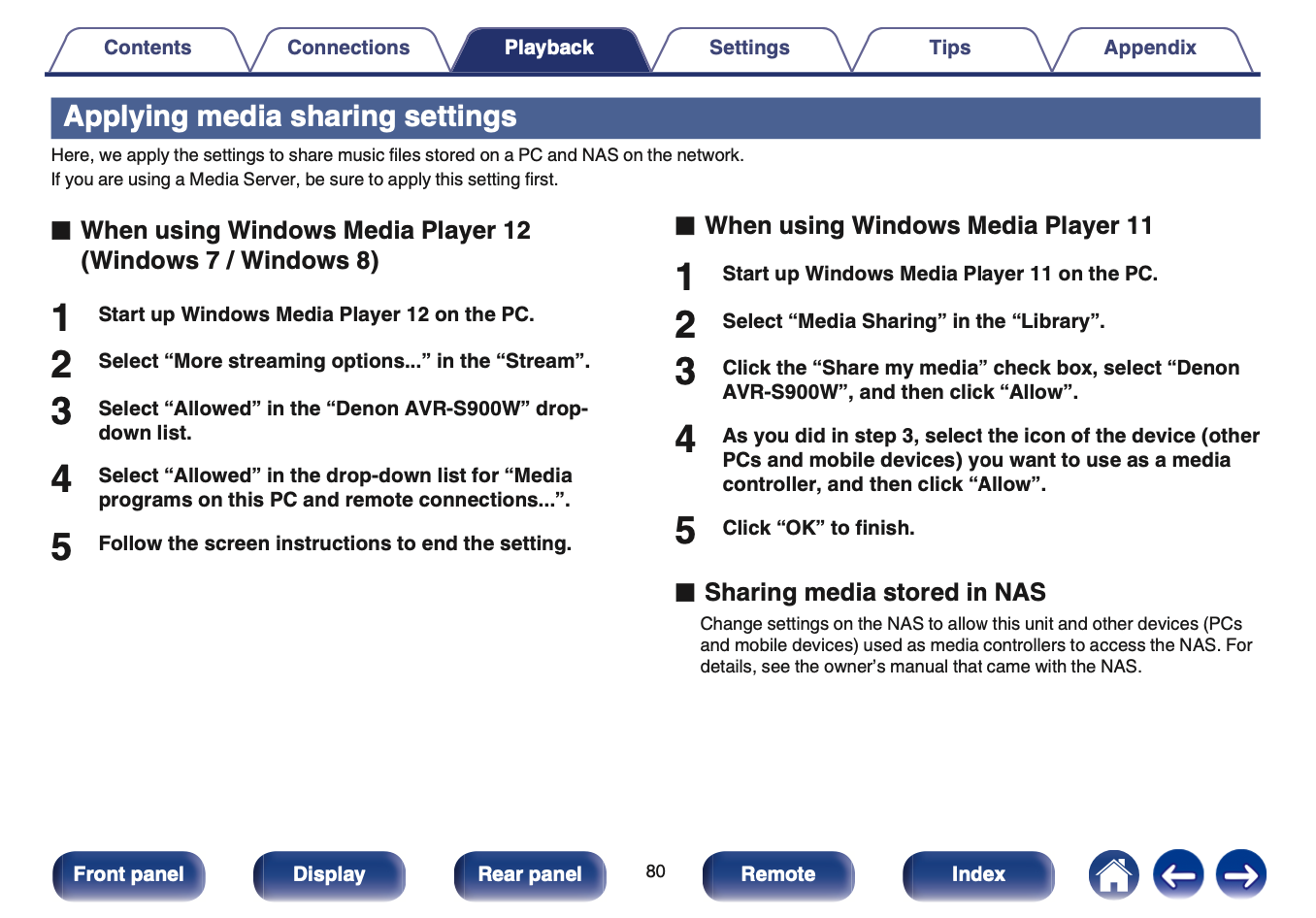

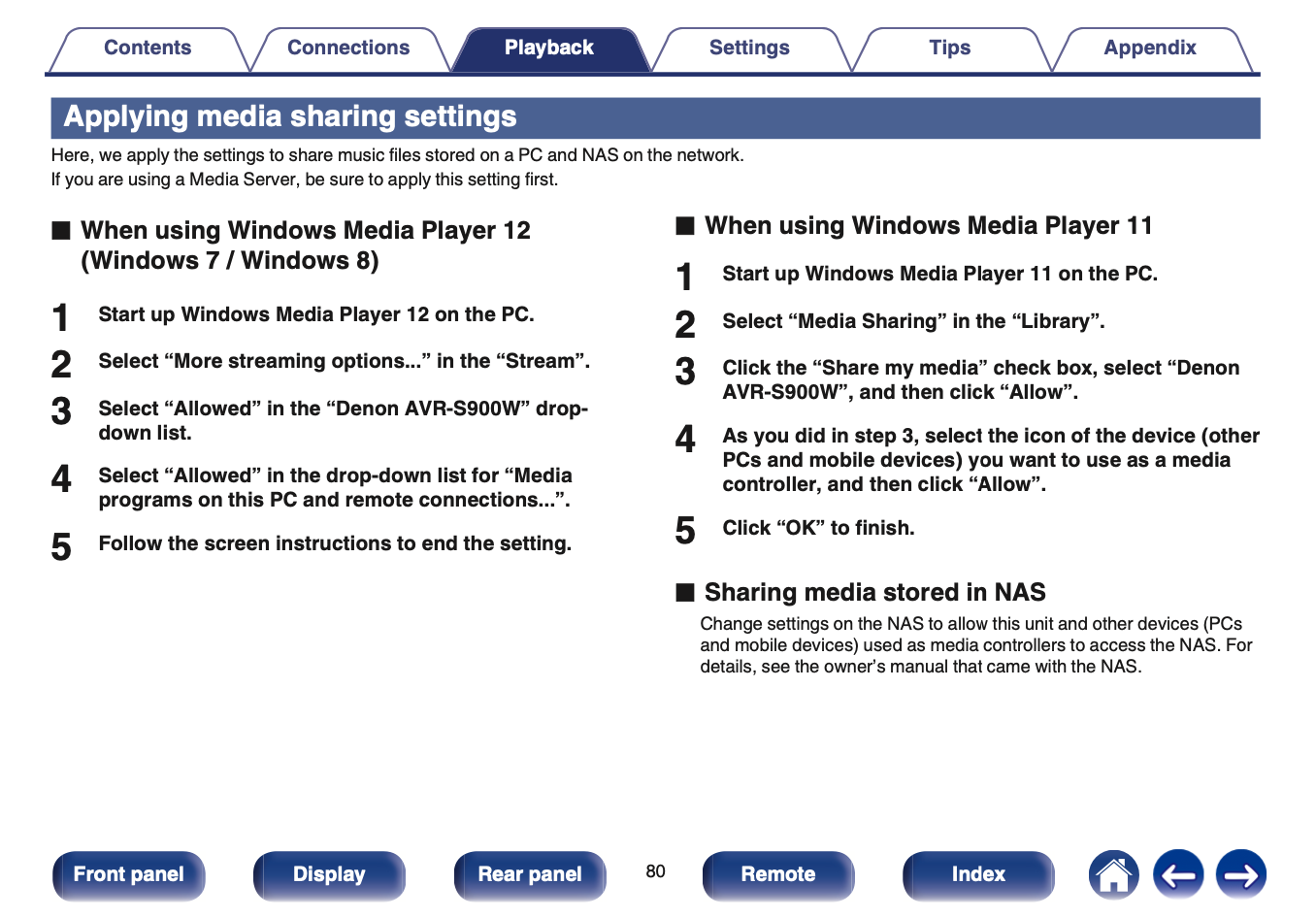

Maybe I missed it somewhere, but you also made the settings mentioned in the Denon manual for Windows Media Player?
I do have the permissions set correctly. But of course the manual is a bit out of date as it's looking at Windows 7/8 whereas my Box is running Windows 11 Pro.
