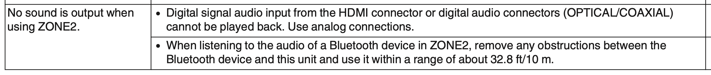

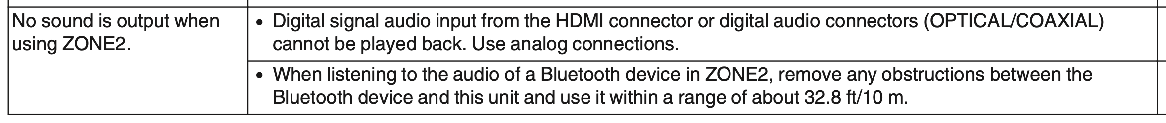

This particular Denon model does not support digitally connected devices at all in Zone 2 when using it separately from the "All Zone Stereo" mode with the Main Zone.

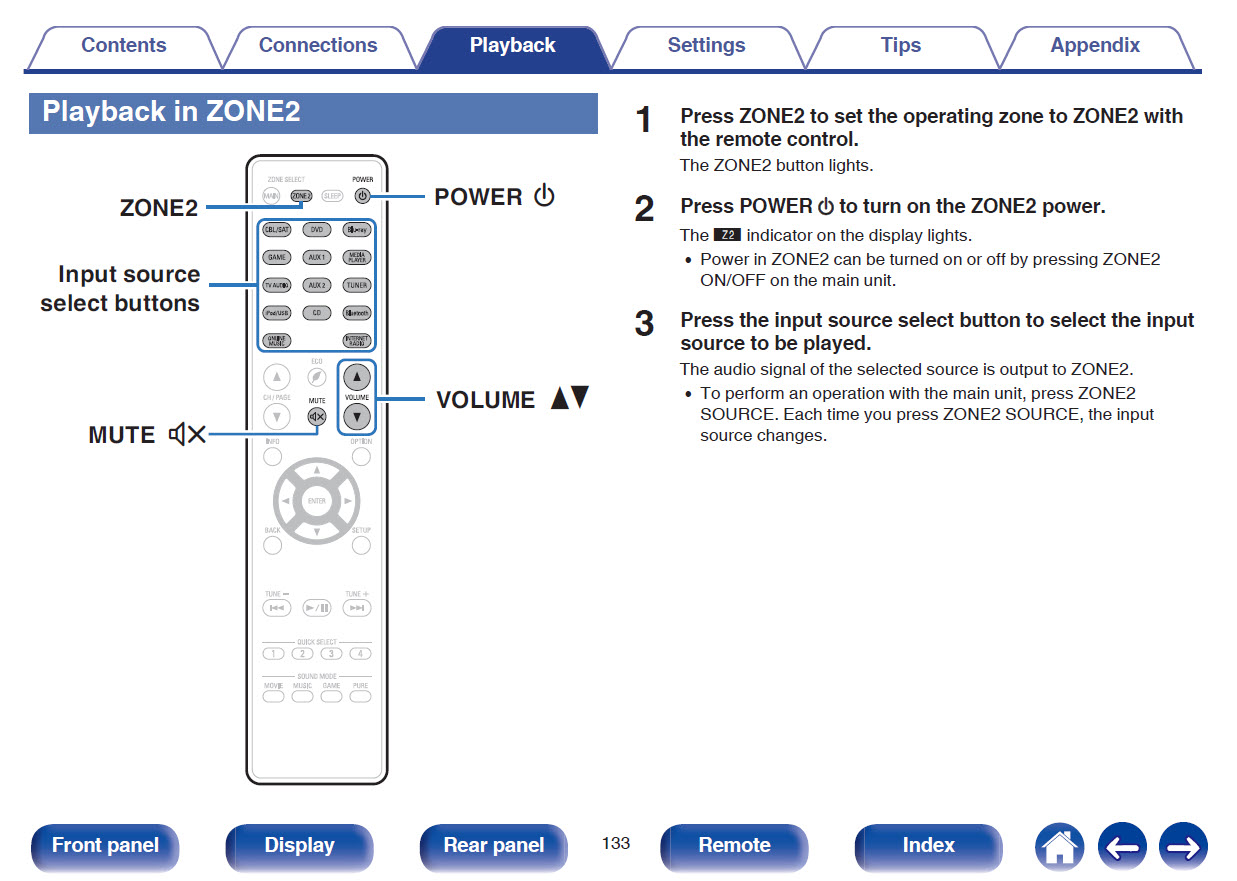

Thanks for your responses @Trebdp83 . I was dumb enough to believe all the Sources were available as indicated in the manual (see screenshot below) and they would work fine. There was no weasel words about HDMI sources but I was thinking that something was preventing it. (I was actually thinking a "Handshaking" issue.)
I didn't think to check the troubleshooting table on page 210. :oops:

Thanks for the advise. I wish Denon would have made this simpler, and been more up front about it in the manual, rather than burying it 200+ pages deep. :rolleyes:.

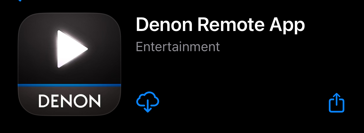

Do you have a Smart device that can be used to download the Denon Remote app that is compatible with the S900W? Not sure it’ll perform any faster for you using the Media Server function.
-Jim-
-Jim-
Thanks for the suggestion. The existing "Denon AVR Remote App" on my iPhone, which controls the Denon AVR-X4400H couldn't "see" the AVR-S900W. (It's too "new" an App I guess :p )
I had to download the "Denon Remote App" (I know this is silly o_O ) but it did see the AVR-S900W, and I can look at the Tunes faster and get something to play. It's a bit strange (at least so far) in that I need to have the Main Zone on to get into the Media Player. Then I can shut it off and play just Zone 2. It still won't let me open my Main FLAC Library (still too large?) and pick a tune but I can go to a smaller folder of Temp Tunes, or one with MP3s and play something there. There is a provision to make a Playlist but that's too "klunky" for me as I never play the same tunes twice in the same order. Of course if it's an Album I will.

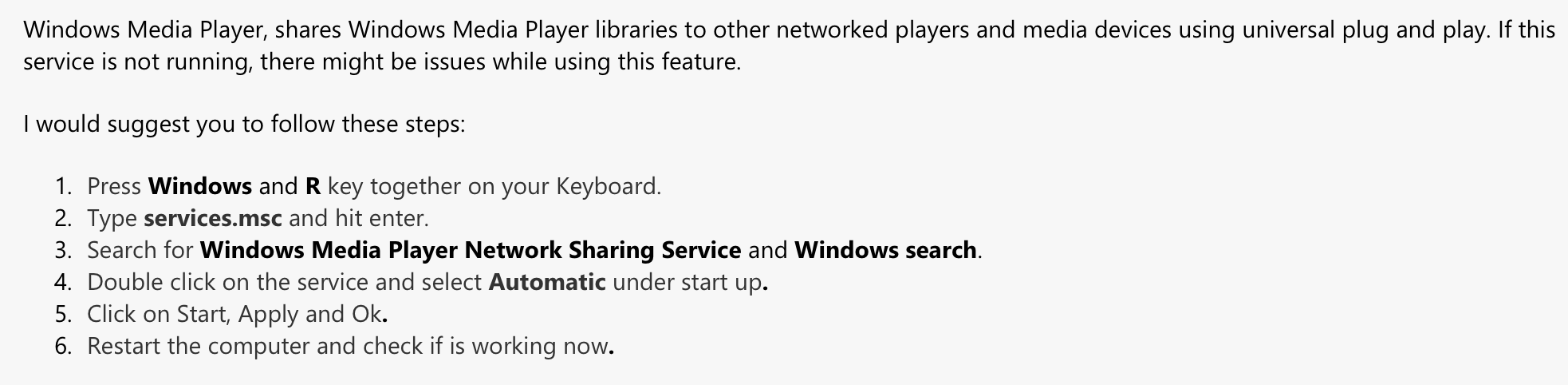

Shooting in the dark here, but try:
If that works, make sure the receiver is OFF. Then, open the Denon app and power ON just Zone 2. Select the Media Server and see if it will stream from your Windows library.

Wait, are you using Chromecast from Windows Media player when selecting "Cast?" The issue is that Chromecast does NOT support multi zone casting. So, that may be why you have to start with the Main Zone and use "All Zone Stereo." I didn't think that receiver supported Chromecast, though.

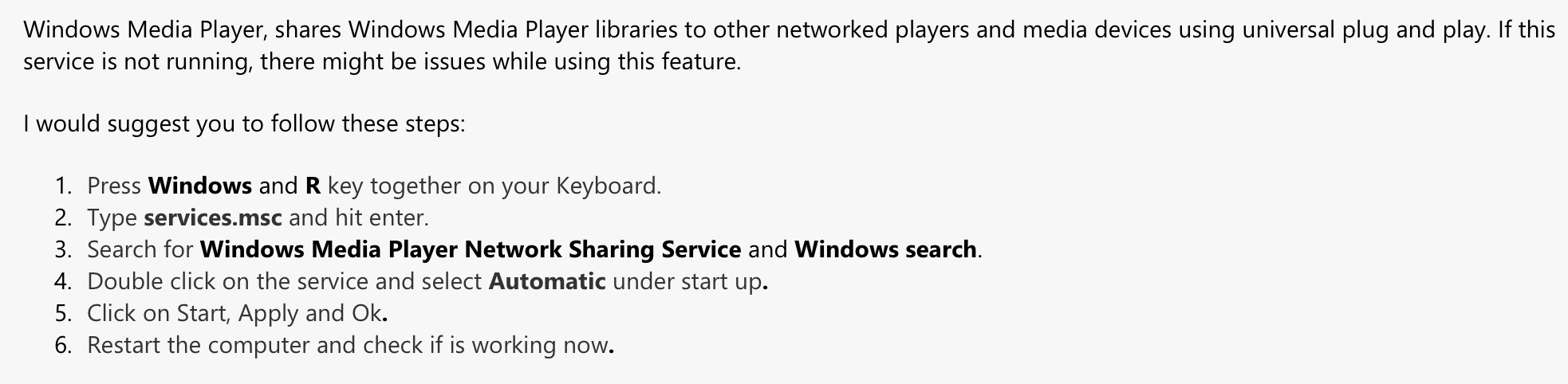

I was pretty sure I had Windows Media Player Network Sharing Service already running as Automatic, but I checked it as suggested and it is set to run that way.
I'll try your suggestion "Then, open the Denon app and power ON just Zone 2. Select the Media Server and see if it will stream from your Windows library." before I move onto something new.

Maybe I missed it somewhere, but you also made the settings mentioned in the Denon manual for Windows Media Player?
