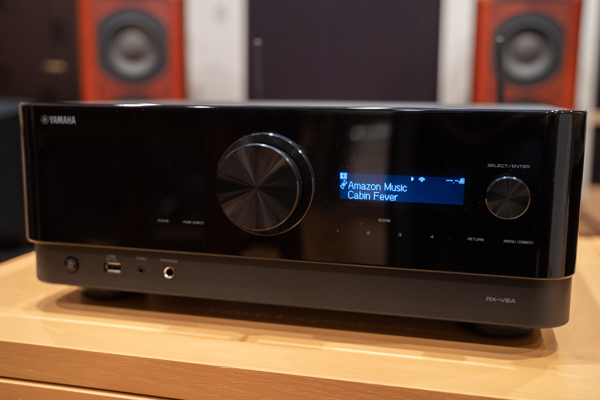

Google Chrome should translate to English. Only review at this point i know.
If you live in east coast you can get TSR-700 for 399$ which should be same machine as V6A. Great price!
Someone at AVSForum posted picture from Costco near fresno California.
