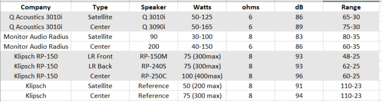

Ok, so these are my speaker options. Now to figure out the dB min Range (thanks lovinthehd for the link). Remove the ones that done make the cut and create a data sheet to help me decide. Once I'm down to a handful I'll try go in and have a listen.
Based on my budget and availability these are my top choices. What would be your top choice?
