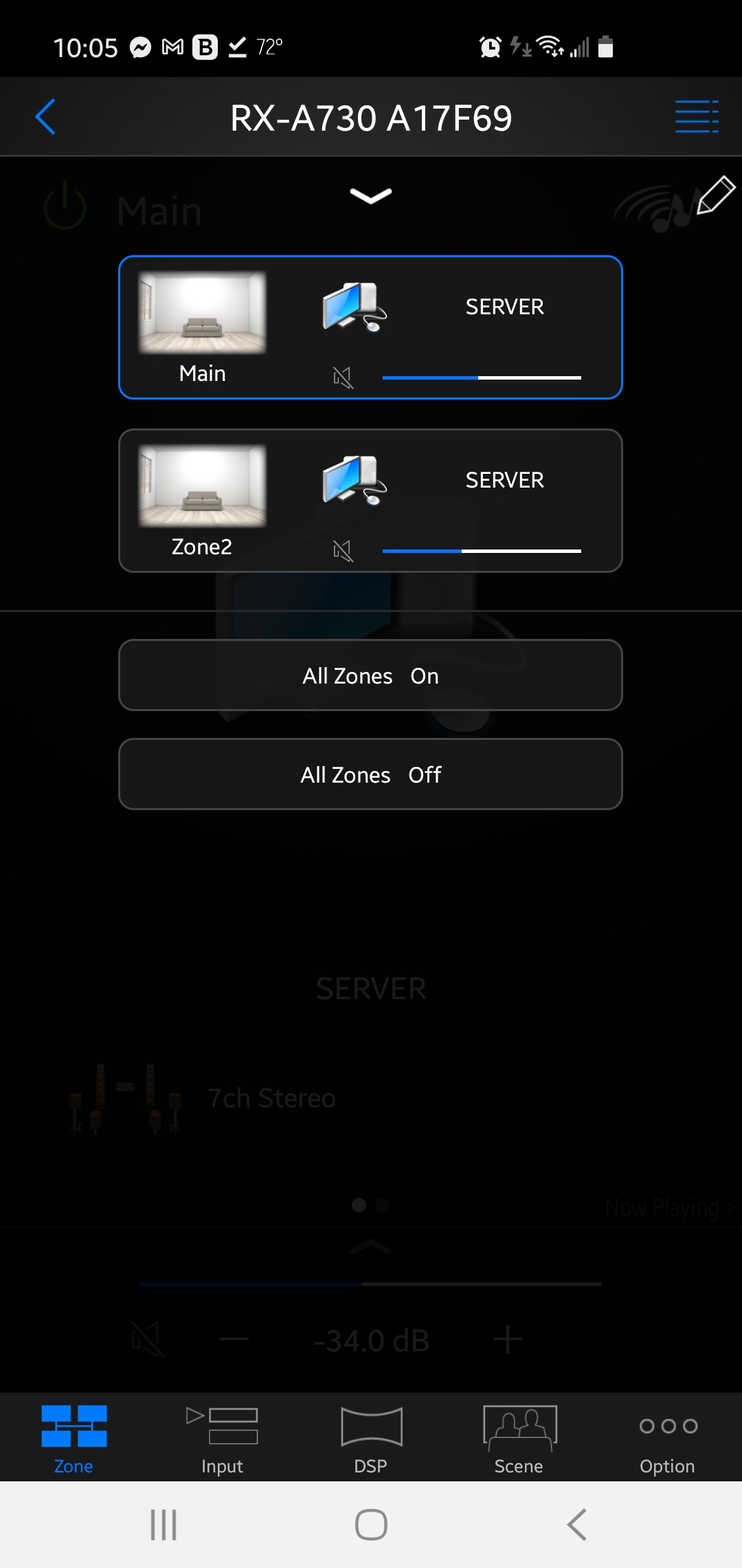

Here's a screen shot from the AV Controller Yamaha app...
That’s a screenshot of the regular Yamaha controller app. You could use that. Just click on zone2 and select source and adjust volume.
Did you download the other Yamaha app called “Yamaha Musiccast”? That’s the one you can use to separate them like 2 separate rooms. Like in my instructions. This is a much easier way because both rooms will have their separate control sections. It’s like having a 2nd Yamaha in zone 2.

However I had used the regular controller app for zone2 for almost 2 years before I started using the Musiccast app. The screen shot he gave was the controller app. Main thing there is to make sure party mode is off. Then from his screenshot click on the zone 2. It should then open up and allow him to change source for zone2 and adjust volume. (You just have to access it this way instead of separately)

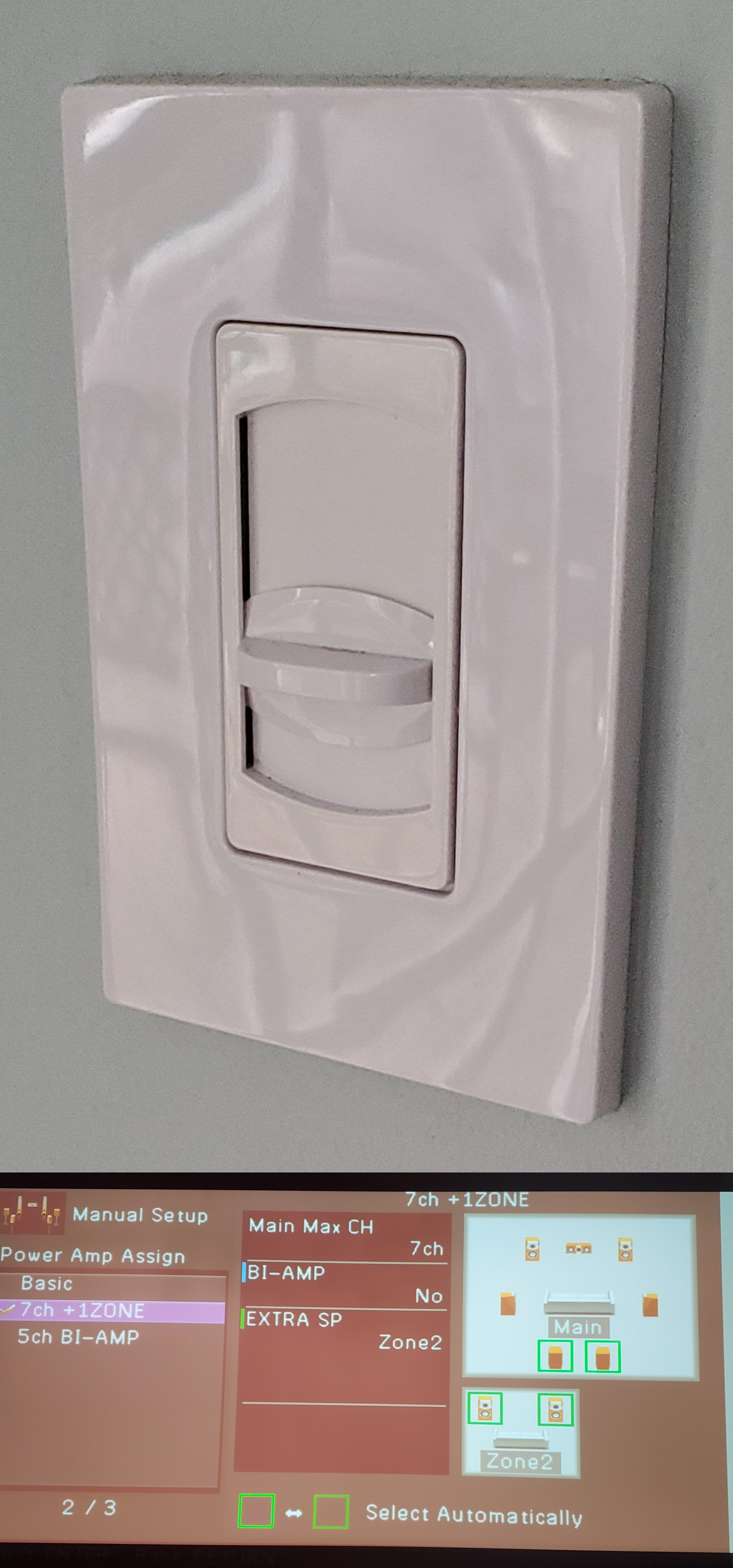

I've went into the settings and it seems to be configured correctly, I've attached a pic..
Also they other pic is the volume slider that is downstairs, no matter what way it's set, still nothing plays on zone 2.

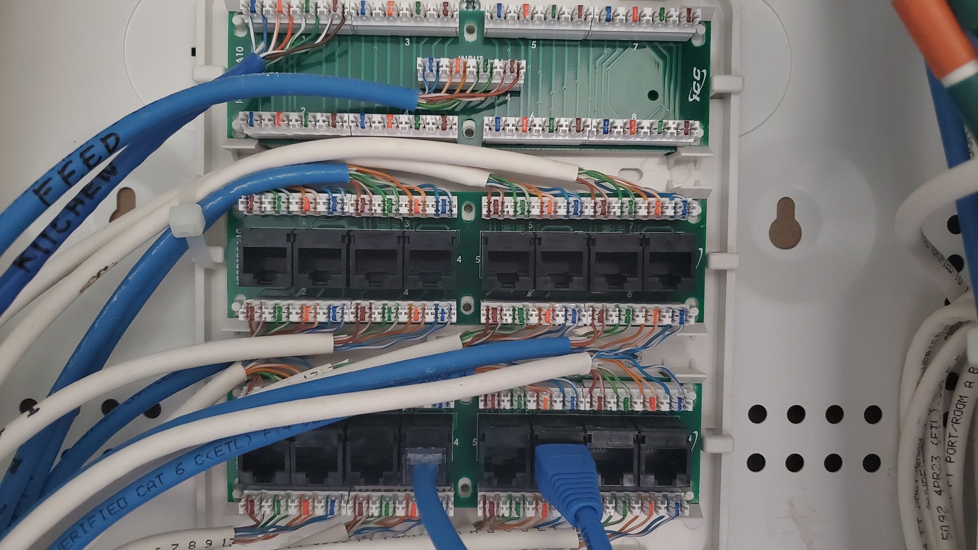

The only other thing I was at while trying to figure it out was the home "network" panel, which is a mess and I`ve yet to get someone in to tidy it all up, but I`m not sure that has anything to do with.
