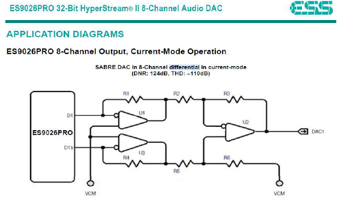

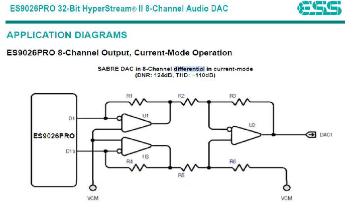

The R-N2000A that utilizes an (minimum 1 obviously) 8 channel ES9026Pro chip that is not Sabre's reference DAC but is still one of their high performance chip for audiophile and studio equipment applications.
So my educated guess is that Yamaha utilized all 8 channels (or just 4, if they have to use the same chip for the subwoofer outputs) of the ES9026Pro IC to implement your favorite double differential scheme to implement this chip for the L/R channels (not sure about the sub outs). The SINAD spec of that chip is 110 dB, that's high enough but not SOTA as those used in the AV10 and AVM90 you also measured, DNR is a whopping 124 dB when implemented differentially, something like what the diagram in the datasheet and in the case only 4 of the 8 channels would be used for the L/R channels, but still in differential current-mode.
ES9026PRO-Datasheet-v3.5.pdf
If they implement such differential scheme perfectly, including using higher end opamps and volume control IC, it could boost DNR/THD by up to 6 dB right?
I remember Oppo (such as the BDP-95 I used to have) used to stack dacs, such that it would use all 8 channels of an 8 channel ES9018 chip to implement 2 channel stereo (4:1 ratio!), in order to achieve even higher DNR than the basic differential scheme, not sure how effective that would be but imo just academic in terms of audible benefits.
By the way, the R-N1000A'a ES9080Q dac IC has very good DNR/THD specs, 120 dB/-108dB and measured so well on your bench too, indicated that it should be a quiet one overall. So I would love to hear your take on why more affordable 1000A would have audible noise even when used with the you bookshelf that has only 84 dB/2.83v sensitivity, or you used different speakers for that comparison?
