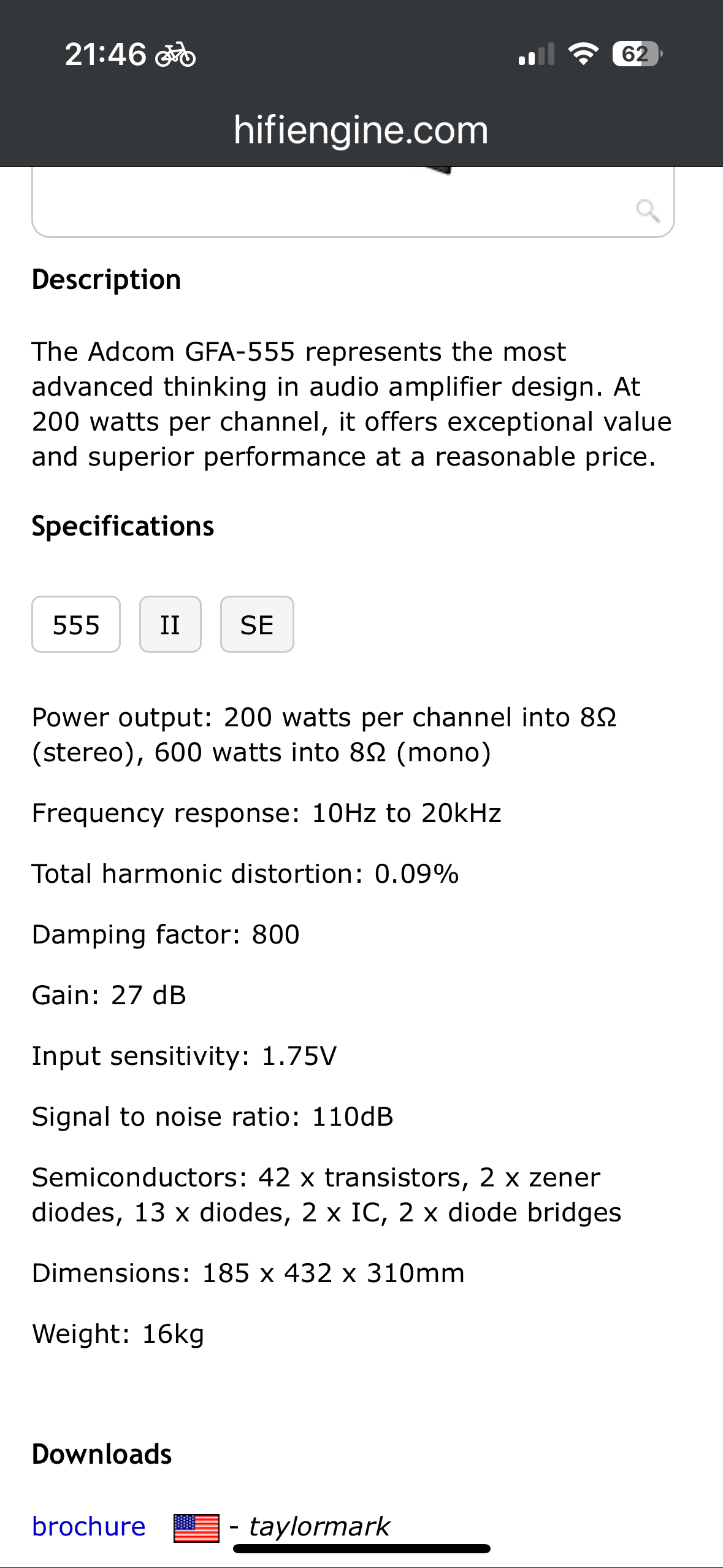

I previously used the volume control with the n303. I attached the specs and manual for the GFA 555 (1985). Perhaps this will help.
Thanks for the input. I found additional info. I’m connecting from pre-out directly to the amp.
