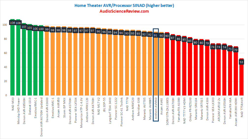

I just read the ASR review on the AVM60 and remember you are a fan. From that review, I thought if you are considering switching back from Marantz to Anthem, you probably should wait until the 2020/21 models are reviewed/measured by ASR or Hometheaterhifi. I am sure the AVM60's much poorer measurements than the AV8805 and the Denon AVRs in just about all categories (THD, noise, IMD, linearity etc.), would not sound worse, or better as such in real world use though so if it is the look, perceived reliability etc. that are more important to you then it doesn't matter, but then you never know how bad, or good the new models would do on the bench.
Anthem AVM60 Review (AV Processor) | Audio Science Review (ASR) Forum
Note that it actually did better than the AV7705. The 92 dB SINAD as shown is for reduced output voltage, if based on the apples to apples 4 V XLR output the Marantz would be about 75 dB iirc. So on this criteria it did just about as good as you Marantz, but IMD and DR were much worse.

I know, but the only one reviewed/measured was the 60 and I just wonder if you have seen the measurements that's all, and just in case.. The 70 will obviously have additional features but audio quality related stuff would likely (not sure of course) not changed much if at all. The measurements (from both HTHI and ASR) seemed to show noise might have been the cause of the less than SOTA bench performance. For HDMI inputs the results were very close to that of the AV8805/8802A and I don't believe there would be audible difference. I am not so sure about the results for the analog inputs, that does look a little high for my comfort but ymmv..
All you have to do is look at the scores of some of the craptastic processors he has at the top of his score list to understand his lacking abilities to measure an amplifier.
The AVM60 was the most rock-solid and best-sounding processor I've owned, and I've had a pretty long list of them. My only hope for the AVM70 is that it is just as good, but with 15 channels.
Processors have amplifiers? You have a better understanding of measurements/measuring? It's not a preference rating or a "how does this sound to me" type of ranking.....some like distortion apparently. Just look at tubes and vinyl (which are lo-fi I suppose if there's a use for such a silly term).
