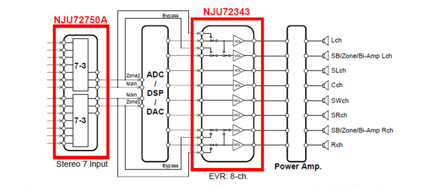

Yamaha's BD34703KS3 for volume control and other functions:
If you buy one of that chip, it costs $11.76, if you buy 1000, it drops to $3.92
BD34703KS2 Stock and Price by Distributor (findchips.com)

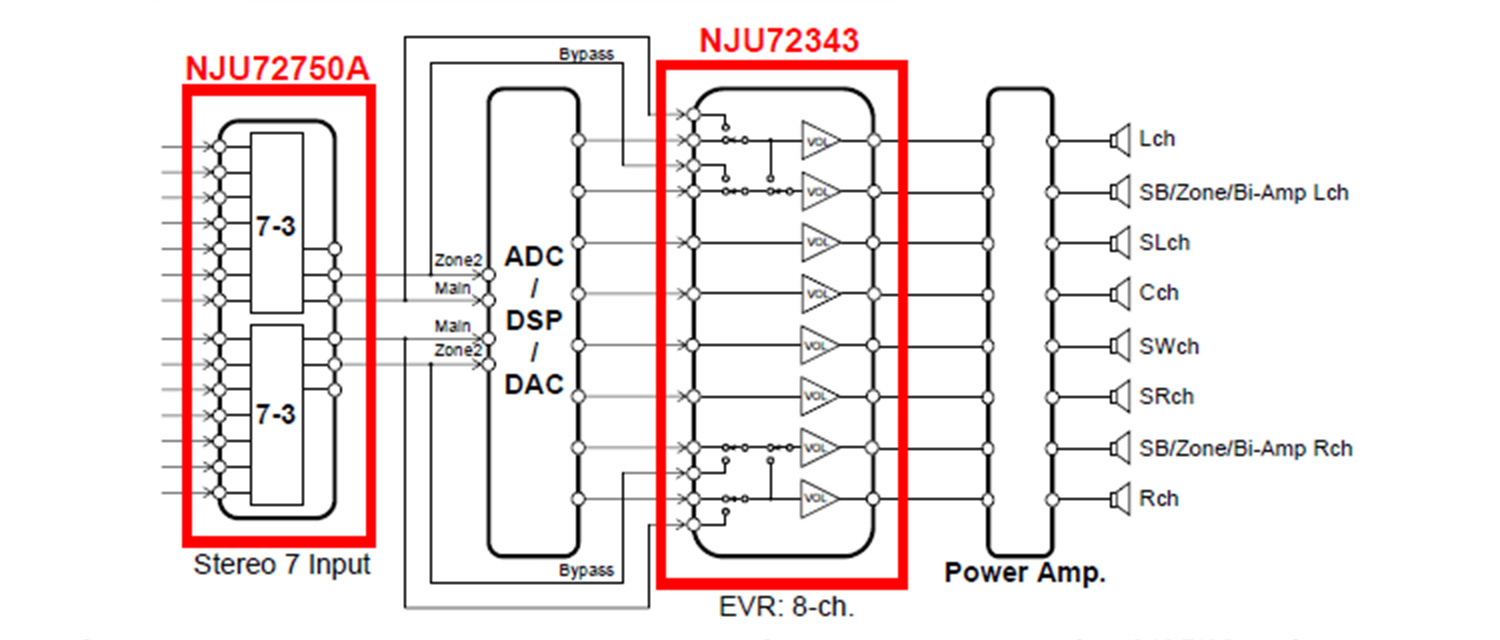

D+M's MSI chip for volume control only:
NJU72343
$2.89 for 1, $1.73 for 500
NJU72343V-TE1 NJR | Mouser
Overall D+M's cost would be a little higher, all else being equal, because that chip is for volume control only and will have to be used with several multiplexor/switchers, as explained in the HTHI article:
NJU72343
