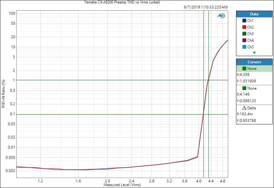

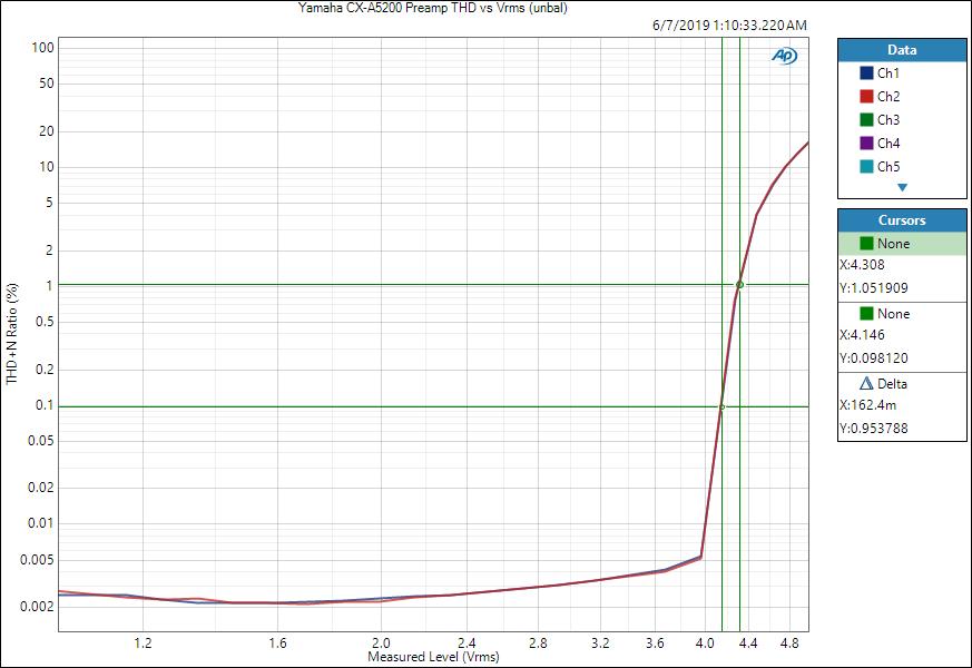

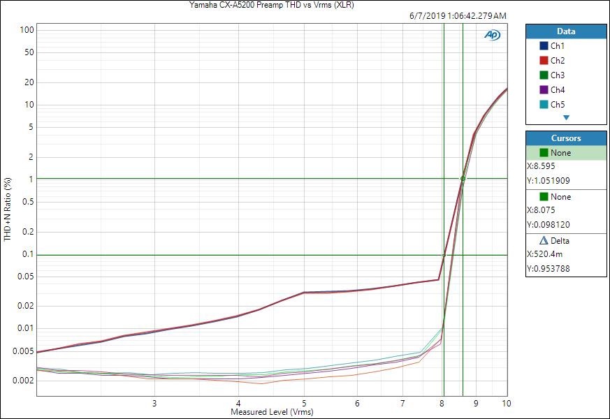

Gene, what is the distortion at 2Vrms output?
2Vrms is still pretty good at .005% even at 4Vrms it's under .02%. But look at how good the other channels are in comparison. I know I'm picking nits but Yamaha has the capability of better.
The unbalanced measures better than balanced as seen below.
It is strange but not surprising to see unbalanced measured better. I remember seeing better measurements for even SNR in a few S&V bench tests in the long past. I understand in this case it is about distortions and most likely for totally different and distinct reason(s). Hopefully you will hear back from Yamaha about the root cause, if not yet..

The Balanced Front L/R Output's is about 0.005% THD at 2Vrms (capable of 315W on 28dB Voltage Gain Amps),which is pretty good.
But Gene is doing Yamaha a favor by expecting SOTA - which means 0.005% at 4Vrms.
