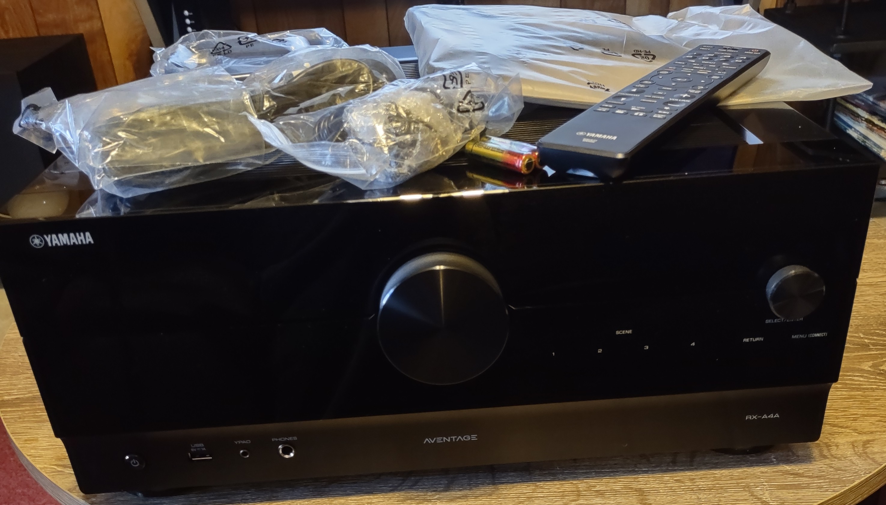

Dude, your gonna love that Beast!! My A4A just came in today. All good No issues, no CEC issues, no audio or video dropouts. I did take the Hood off to do a look see, it's jam packed in there! The OSD is easy to use, tons of settings if you choose to mess with. I tried to upload some pics, but can't there to big and I can't resize because all I have is a smartphone.
