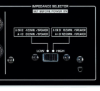

Here is my confusion and frustration. My Yamaha has two settings (below) and the 4 OHMS setting is the same setting as the 8 OHMS. The other options is 6 OHMS. There's only two settings. This is exactly what the two settings are n the back of my Yamaha.
(A or B 4 OHMS minimum/speaker) (A+B 8 OHMS minimum/speaker)
Or
(A or B 6 OHMS minimum/speaker)
Please help my frustration and share which setting I should be on. I have tried them both, don't notice a huge difference, just don't want to fry my amp & speakers. Thank you!

This is the switch:
Again, just leave it be and you will be fine. From Gene in his review: "You see that impedance selector switch on the backpanel? Don't touch it! Leave it at its factory default ‘high’ setting regardless of the speakers you connect, or else you will be starving your speakers of power just to validate a UL heat dissipation test that is required to list 4-ohm capability on the silkscreen." Another quote in the measurements section of the review: "There is a dreaded impedance switch on the back of the A-S801 that reduces the output power of this unit for certification purposes only. We recommend leaving it at the default 8 ohm setting and NEVER changing it."

The "High" setting according to the back of my amp is for it to be set to 6 OHMS.

This article cleared it up for me. Several people said set it to high, which I assumed was 8 OHMS, but the back of the amp says high is 6 OHMS.

Thank you for this. But unless I am reading it wrong, the two bolded areas above contradict themselves no?
"Don't touch it! Leave it at its factory default ‘high’ setting regardless of the speakers you connect"- The high setting is 6 OHMS
"We recommend leaving it at the default 8 ohm setting and NEVER changing it."The 4OHMS/8 OHMS setting is low setting.
Sorry...just confusing.

The reason it says A or B 4ohm and A+B 8ohm is that 2 sets of 8 ohm speakers running at the same time(A+B bindings both used at same time) looks like and behaves like one set of 4 ohm speakers to the amp and the same for high 6 ohm setting (12 ohm divided by 2 is 6)

To be clear, if you have 8 ohm nominal speakers then leave it in the default 8 ohm setting.
If you have 4 ohm nominal speakers then the manufacturer clearly wanted you to use the 4 ohm setting because they have to cover their rear end, i.e. regulatory, legality issues.., that does not mean you would do damage to the amp if you ignore their recommendations. Conversely, if you do follow use the 4 ohm setting, it does not mean you will get poorer sound quality, because it depends on your actual power (voltage/current) requirements.
The fact is, amp output specs are not perfect, no even close. Yes some amps have higher current capability and will therefore be more suited for low impedance speakers, but ultimately it depends on the individual user's actual real world power requirements.
You can have an amp that is rated for 4 ohms such as the A-S2200, but if you crank it up high enough driving even 8 ohm large towers that has power handling rating of over 500 W, you can still risk damaging the amp if you are not careful.
Or you can have an amp not rated for 4 ohms (such as the A-S801), but your power requirement never exceeds 30 W (just an example I pick) driving your 4 ohm nominal speakers to the loudest level you can tolerate during the maximum peaks, then your little amp will be fine regardless of where you set the impedance selector.

Leave it at 8 ohms! Of all of the replies that's the one constant, consistent recommendation. The lower impedance switch (4 ohms) is there to limit power to meet the aforementioned UL Lab heat dissipation requirements.
