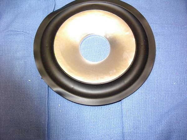

The JW driver had a very strong niche following from 1959 to 1979. The company was sold to volt who did nothing with it and sold the name to musical instrument retailer. I have tried to buy the name back with the help of my brother who is an attorney. However the owners want a ridiculous amount of money.
The driver had a very strong following and sales in the Far East where the driver has always had "cult" status.
Mark Audio of Taiwan have basically copied/developed the driver and it is available from Madisound.
It is the Mark Audio ALP 10. It says it is 6" however they are counting the surround. The diaphragm of this driver and the JW is 88 sq cm. The driver is currently out of stock.
The driver has a standard suspension and not the unique suspension of the JW.
The JW MK II.
The MK III at the end of production has a cone with rolled rubber surround.
The T/S parameters of the Mark Audio ALP 10 and the JW are almost identical.
Both have an F3 of just below 90 Hz in a .25 cu.ft box and an F3 of 47 Hz in a 0.5 cu.ft vented box.
The JW is a slightly lower Qts driver and sealed the Qtc of the JW is 0.5 and essentially non resonant. The ALP 10 is 0.615.

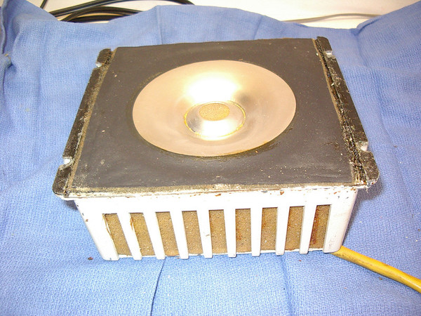

Interesting. That 4" diaphragm ALP 10 does not look as good as the original JW.
We never marketed the JW module in the USA as this has long been a rock driven high spl market.

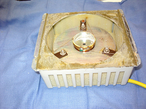

The module was not limited by the suspension excursion and compliance. It always was limited by the physical properties of the cone, which will "oil can" if you drive them hard with a constant thump, thump, thump. The cones are basically foil and if allowed to fall in the air, they fall like a feather.
I suspect the Mark Audio has a somewhat tougher cone, as it has a rise in output above 8 K and is ragged. The JW has a slight gentle roll off above 6 kHz. It does sound a little recessed, but is the only full ranger I know that is not shouty.
One used as a center in my system at Eagan has plenty of power to do the job as a center in that environment crossed over at 90 Hz, which substantially reduces the chance of "oil canning'". My measured sensitivity is 88.5 db 1 watt 1 meter. There are no crossover losses, so this is very reasonable sensitivity.
If used sensibly however you can get a lot of uncolored bass from these drivers. I put a 2.0 system together for Afterlife 2 after he was wiped out by Sandy. I was playing some choir and organ music through a pair in 0.5 cu.ft. ported enclosures, and an organ peddle suddenly made the windows rattle.
