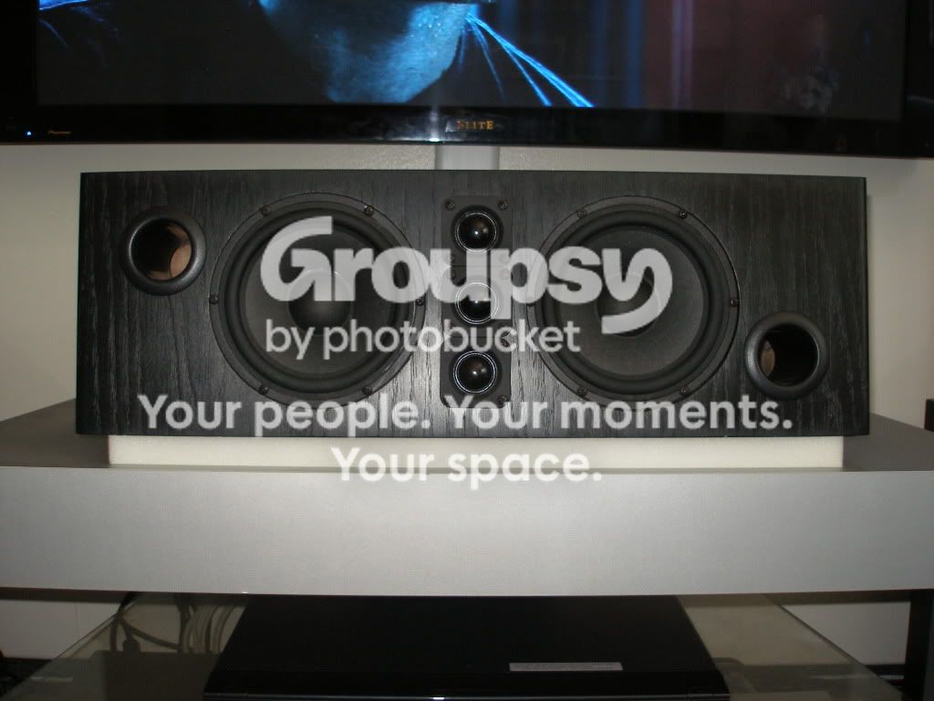

Now members on AH used to call this design as a train wreck (my last center, which BTW was awesome) And here you got 4 tweeters and it's great. You must have paid your dues to AH, or four tweeters are better than 1. BTW 4 tweeters are better than one, I think you've got something there. What is also impressive are the magnetic grills. I had magnetic grills on my speakers 15 years ago, that's nothing new.
Not sure what you're implying here as we've favorably reviewed many speakers with multi-tweeters including JBL, RBH, Dali and others. If a designer knows how to implement them without causing appreciable acoustical interference then it could be advantageous for achieving higher output and sensitivity.
If you read the XTZ review and/or watch Marshall's video you will learn that 3 of the 4 tweeters are BW limited below the wavelength where the physical separation doesn't cause appreciable acoustical interference and Marshall was quite pleased with the sonic results. A train wreck is when you place tweeters on opposite ends of the cabinet which separates them much further than their lowest common wavelength resulting in very poor off-axis response.
BTW vertically aligning your 3 tweeter speaker was the right thing to do to minimize lobing by keeping your mids closer together and also better integrating HF performance. I bet that center sounds good!
