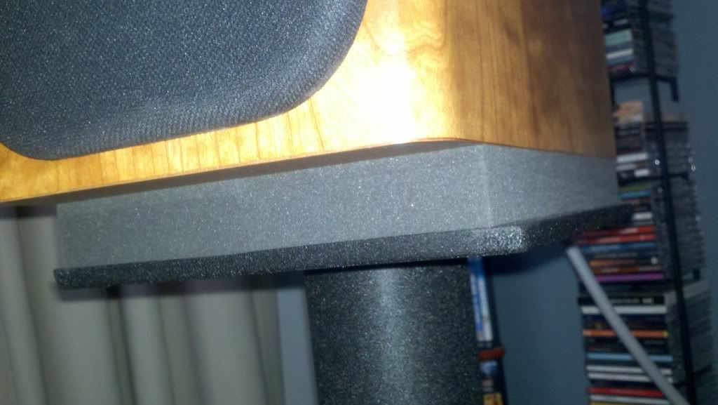

Can't you just take them off? Every set of stands I've owned come with them and all of them have been removable and not installed out of the box. And no, I don't use them. As long as the top plate is big enough, I use Auralex MoPads.

I used Home Depot rubber dots under the speakers. Mopads or similar high density form will give much better decoupling.
