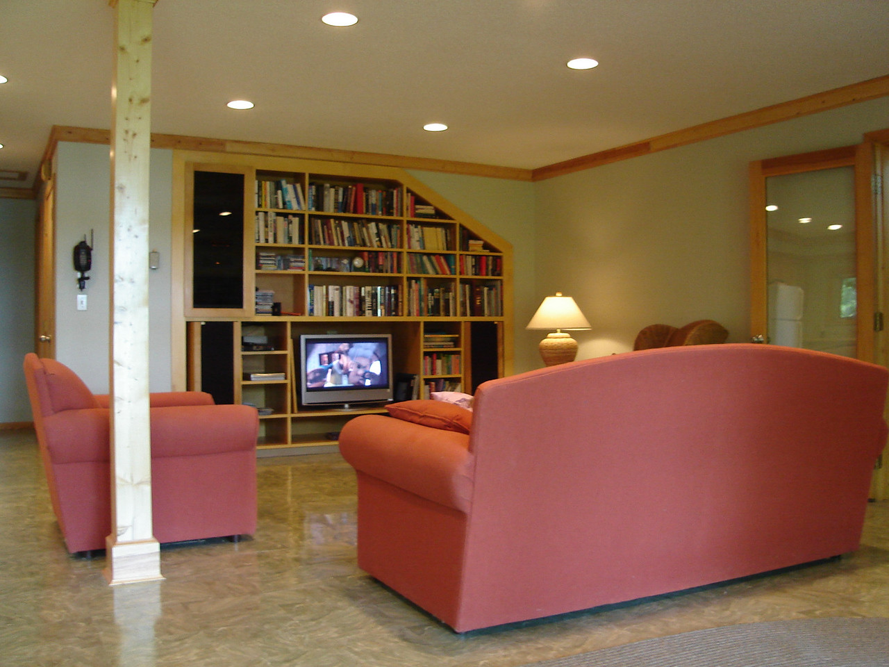

Apart from square rooms, which always sound awful, I have pretty much given up figuring out why some rooms sound good and some lousy.
I do know that an active echo does not preclude a room sounding very good. I have this room here that I thought would be a problem child. It turns out the room sounds excellent, especially for choral music.
It is very open. It has a substantial echo.
Even sitting right out by the fire, it still images well.
No way you could do 5.1 or 7.1 in that room, but you don't need it. It just envelops you in glorious sound.
Nice place- lots of short surfaces help a lot to disrupt the energy so standing waves aren't a problem. Also, SPL matters, a lot. When I met with the people who own the home in the photos, I explained that sound in a room similar to that is like ping pong balls in a hurricane or the balls on a billiard table: louder = longer time spent bouncing off of multiple surfaces. Below some point that's determined by the shape & size of the room and the sounds' energy, it will sound great but as soon as it reaches the threshold, percussive sounds will echo and in smaller rooms, 'flutter' echo can be heard. Clap your hands once and listen when you enter a room that is undergoing an audio system installation and you may be surprised by the echo. The lack of fatigue, better focus to the directionality and tonal balance all improve with a bit of judicious furniture placement. The photo of the wall where the TV is located tells me that the chairs are right where they need to be, in order to deal with the first reflections and if you were to remove them (leaving the sofa where it is), you would no longer say it images well but again, the source material and SPL are important in the sound quality difference. The need for treatments is largely determined by the application- if the music and soundtracks are often at high SPL, it's not optional, IMO. At lower SPL, it's not necessary to put something on the walls/ceiling that nobody wants to see.
