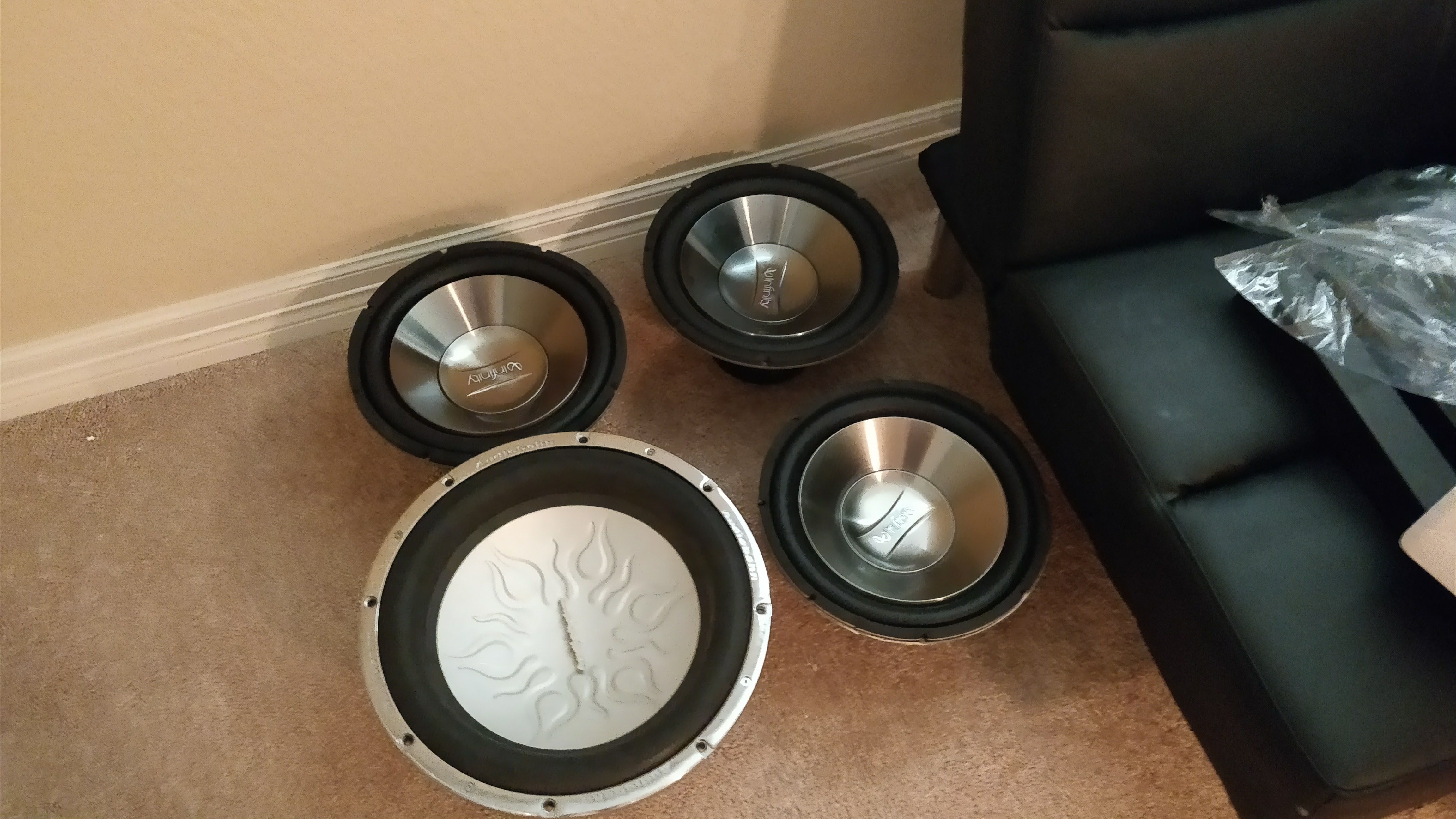

Subs are 2x DIY Infinity 12" 1260w and 2x 1262w each in their own ~ 2 cu ft box. Boxes will be finished in satin black.

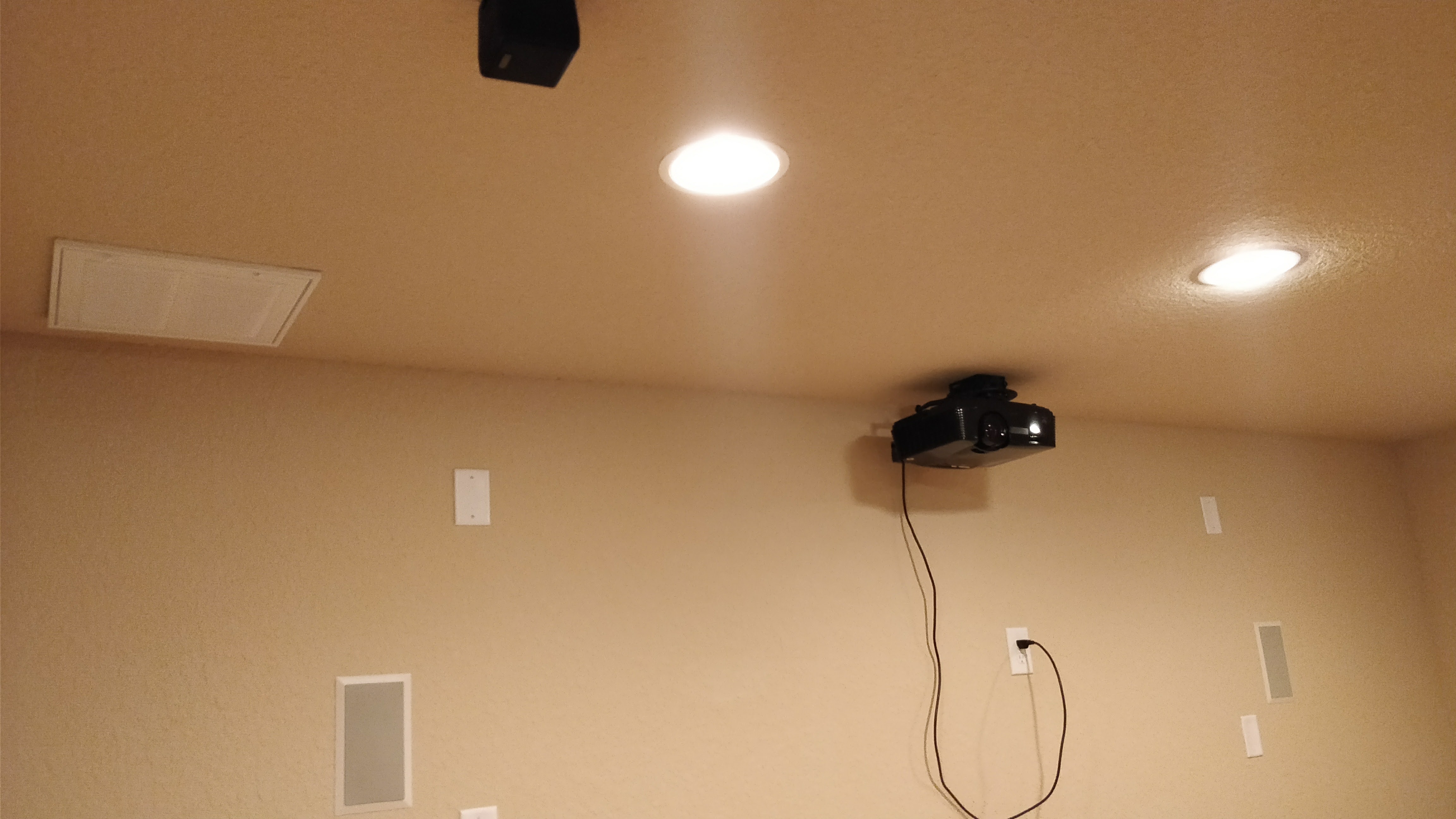

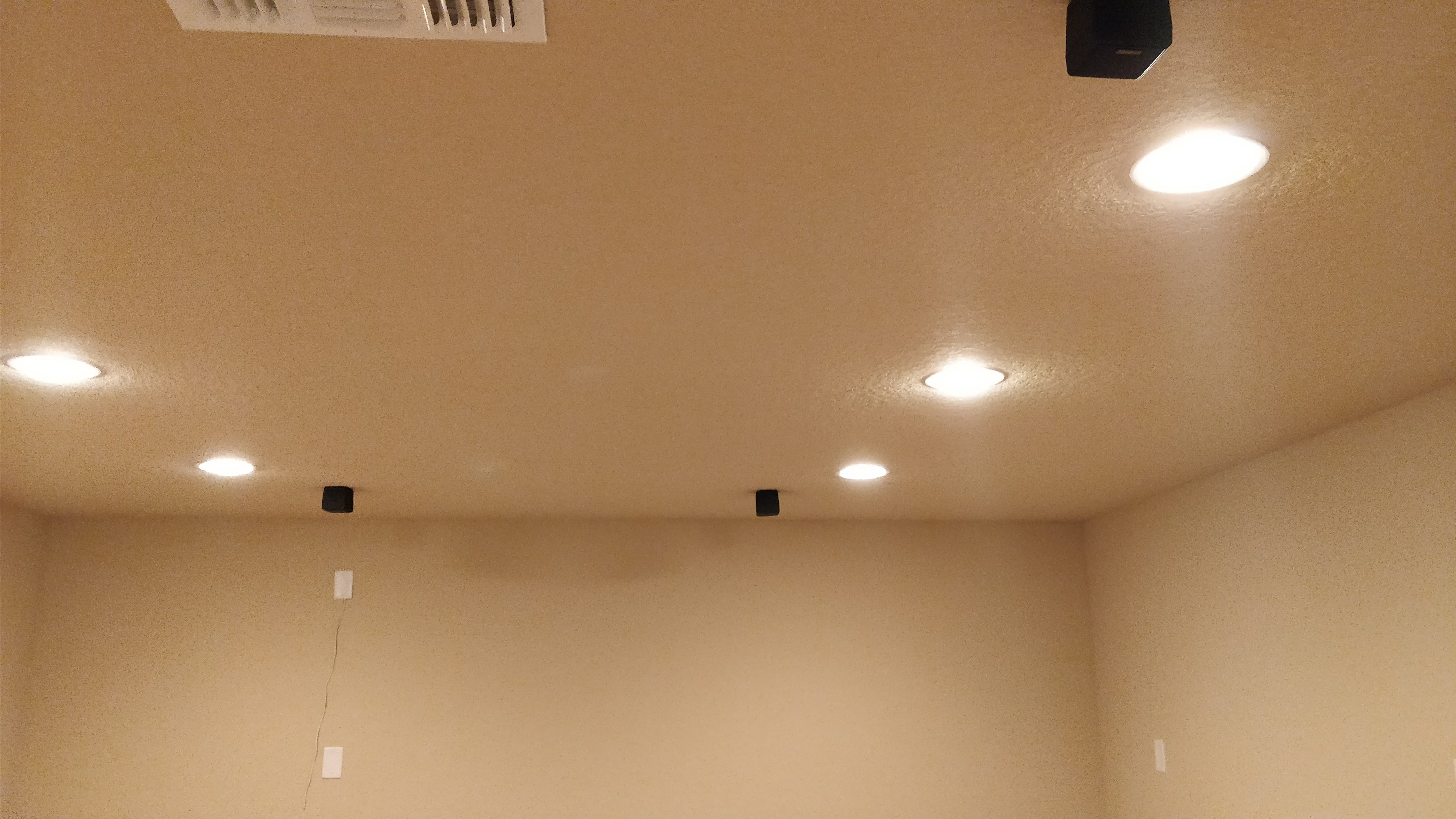

There are 6 can lights in the ceiling and an air intake and vent. Placement of Atmos speakers will be at the advice of everyone here. My brother works as an installer for Magnolia, but I'm not sure how much they've actually taught him.

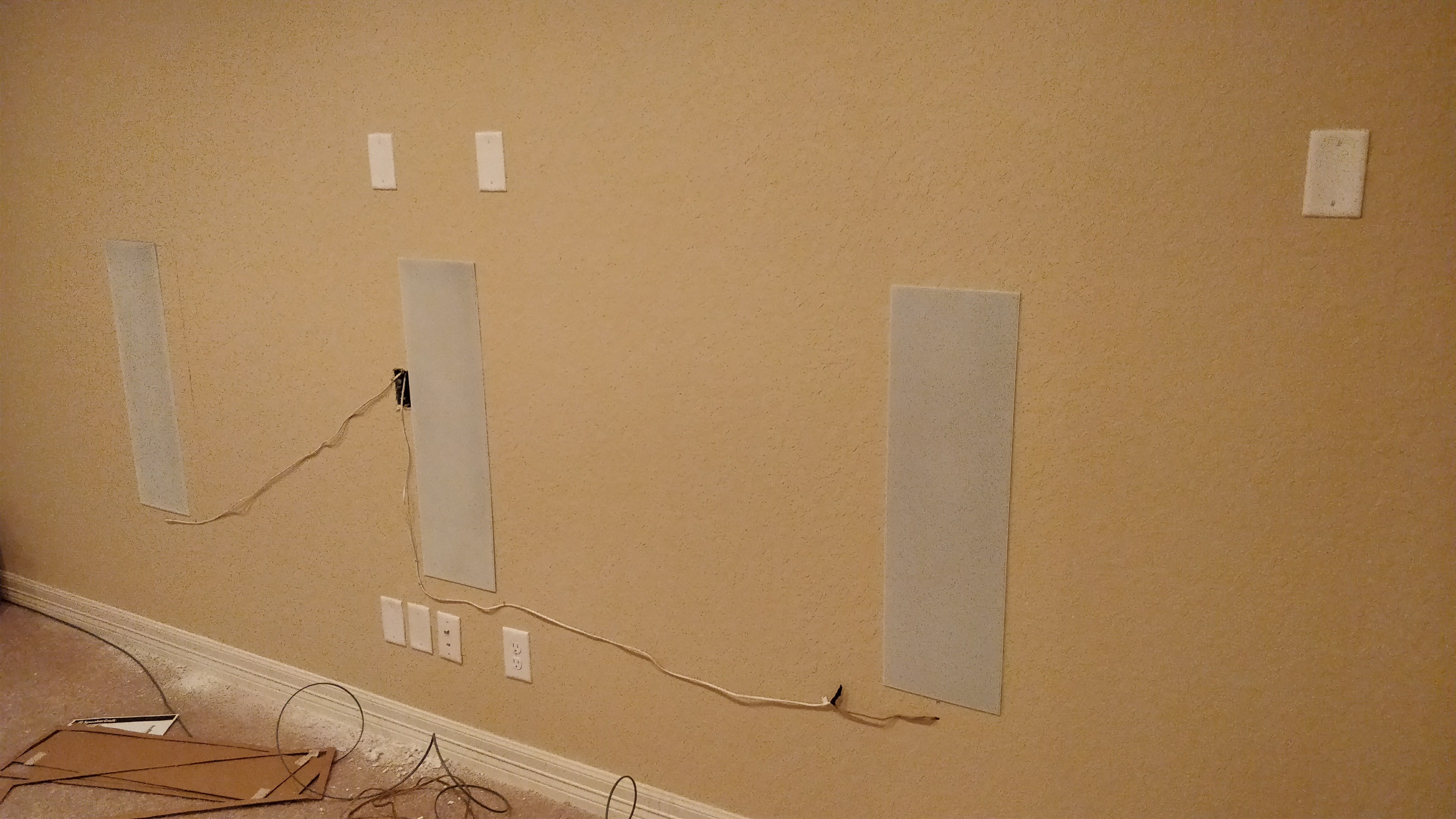

As you can see from the above picture there is the intake pretty much right between the left side and left back speaker on the ceiling. I think Atmos speaker placement will have me put it enough away from it that it will work, but I'll have to measure and make sure.

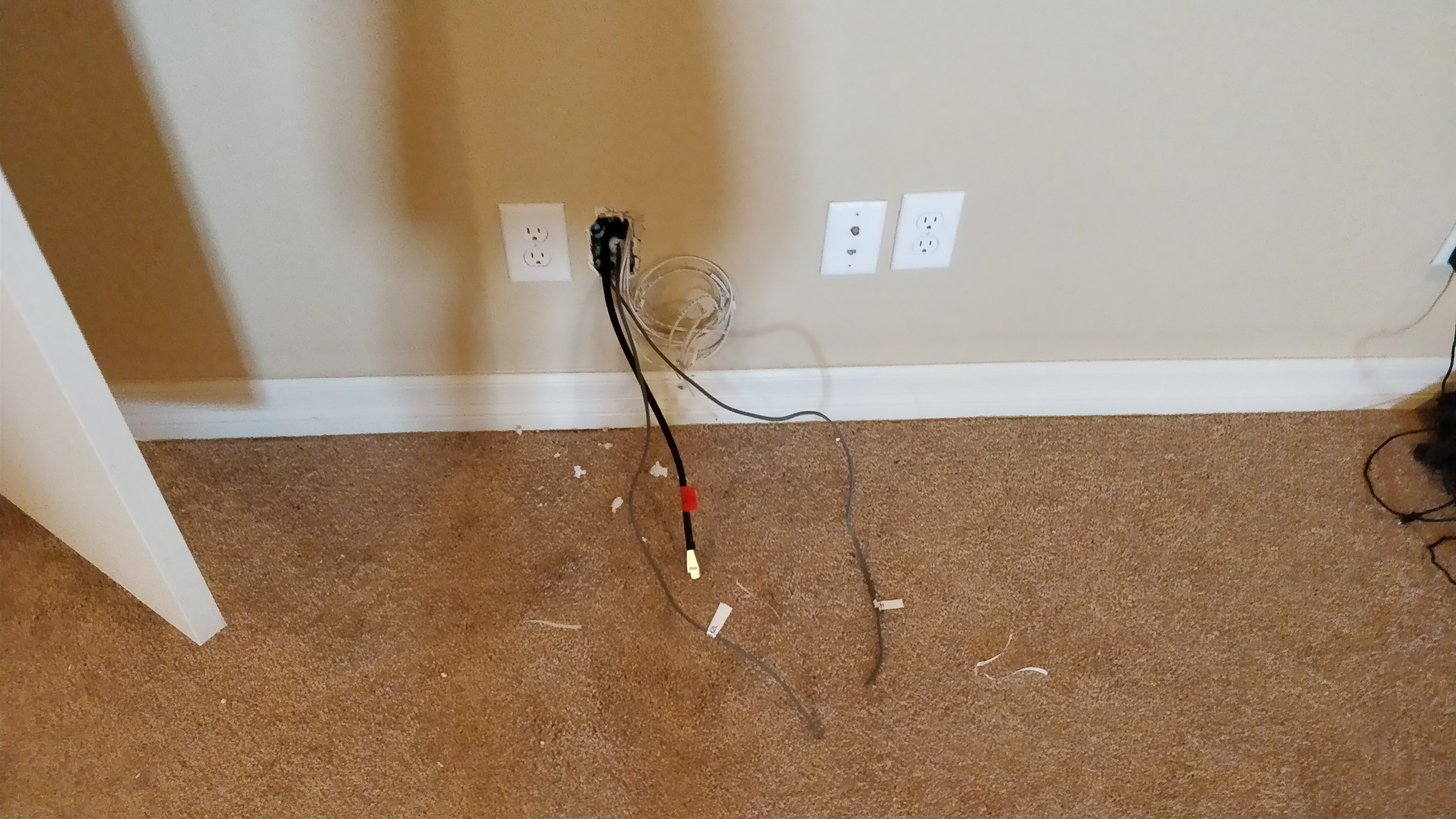

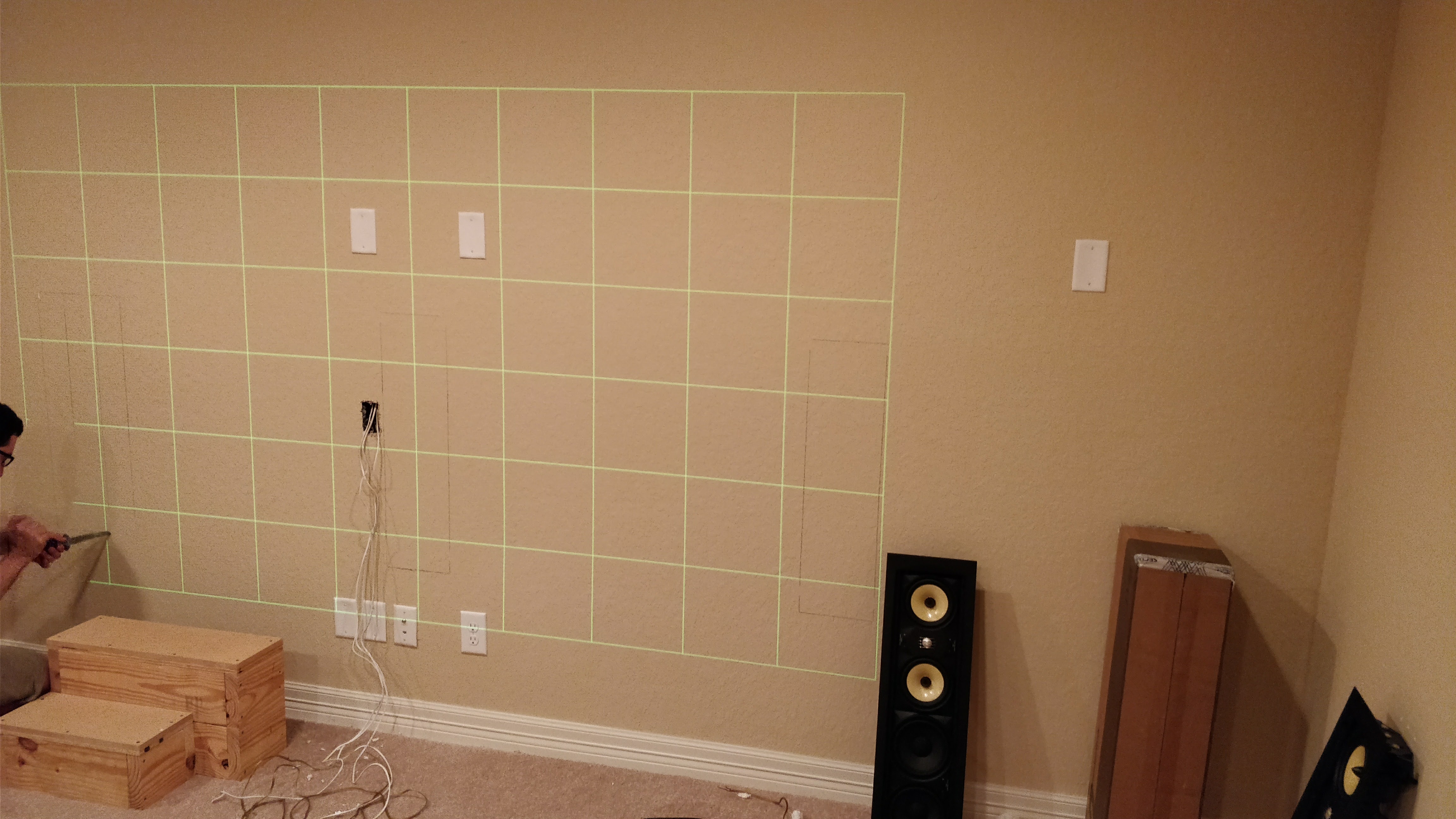

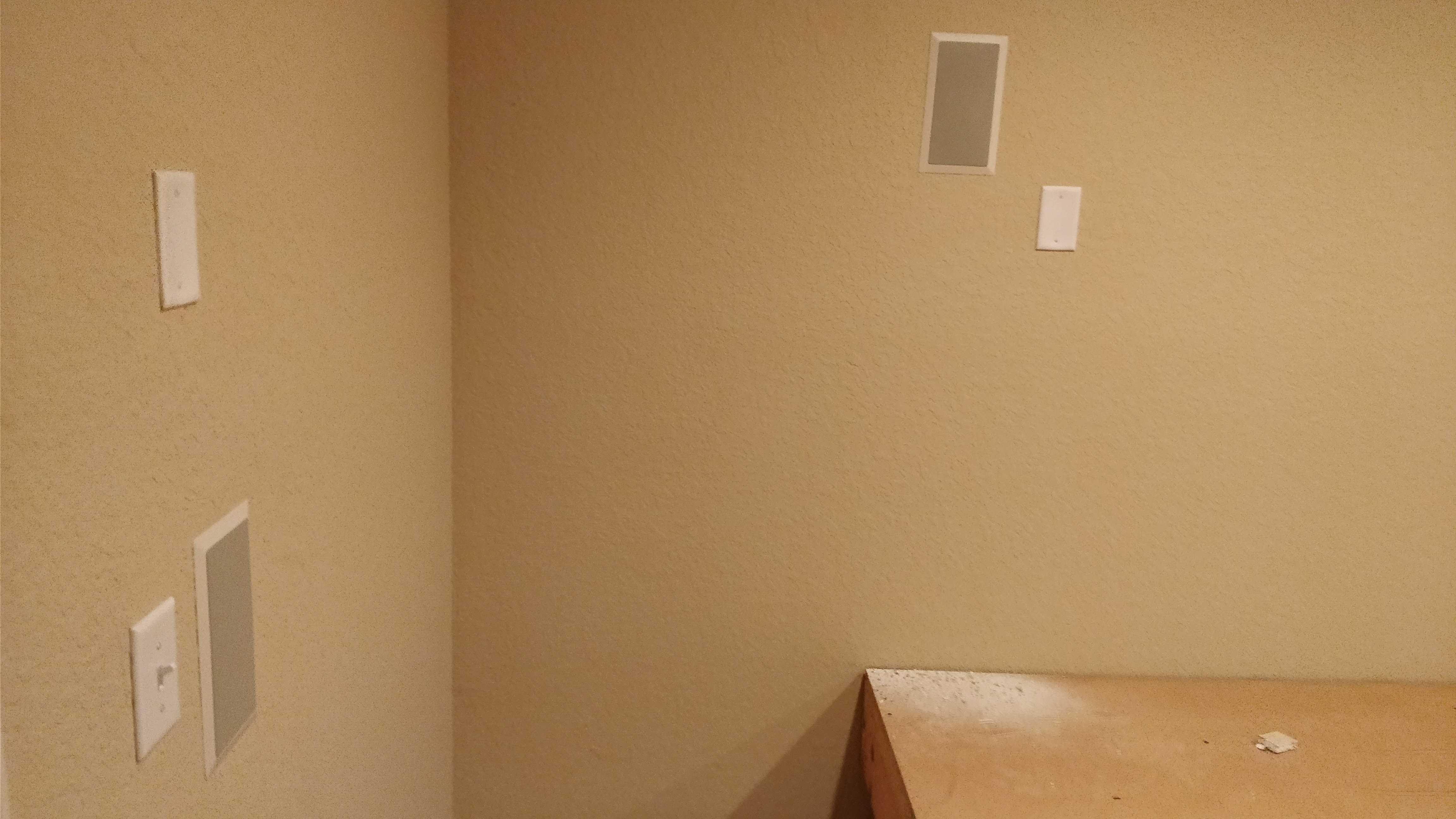

You can also see that the guy that did the prewire was...special. The lower plates are from his first try. I had him wire again because he assumed I was going to have all my equipment in the front of the theater. He was wrong. It goes on the outside of the room.
Above is the correct placement for the 7 channel pre-wire. I guess he didn't realize that labeling the wires is a pretty standard thing. Glad I paid them for the prewire. They wouldn't do more. For some reason. I did have them put two dedicated 20A circuits and cat6/RG6 in place. This is outside the theater in the Game Room. Good location.
I told him to just have the front three channels come out of the same hole. No labels again. Thanks crappy wire puller guy. I have a toner so I got them all identified, but still.

Ok. Made a ton of progress since I got to get an unpaid week off from work so they can make more profit....I digress.

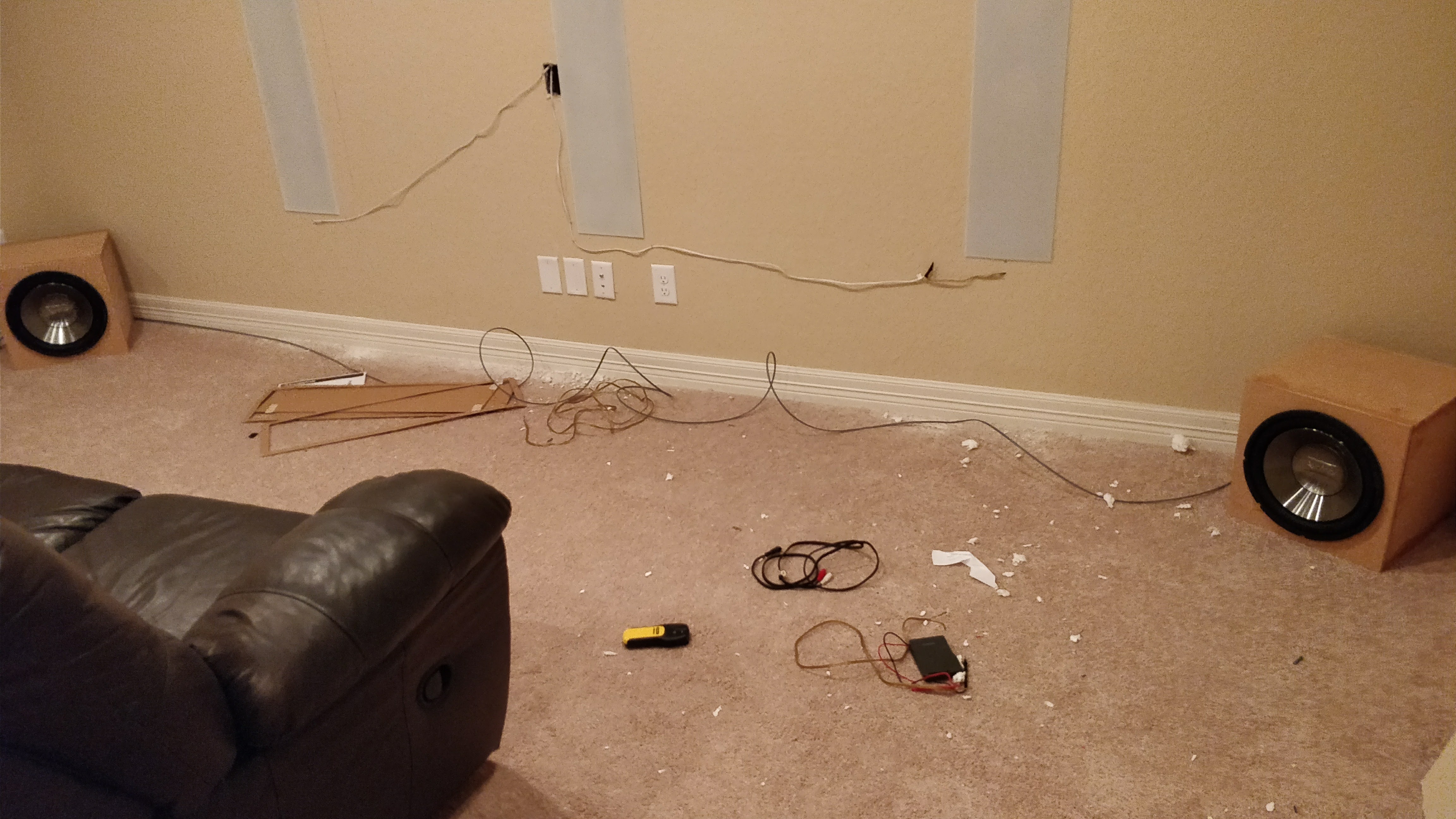

All these drivers need boxes built. The theater will have 4 infinity 1260w/1262w subs. One in each corner. Right not there are two installed and the boxes for the other two are almost done. The big Audiobahn is for something else. One of the 1260w is going back in the living room.

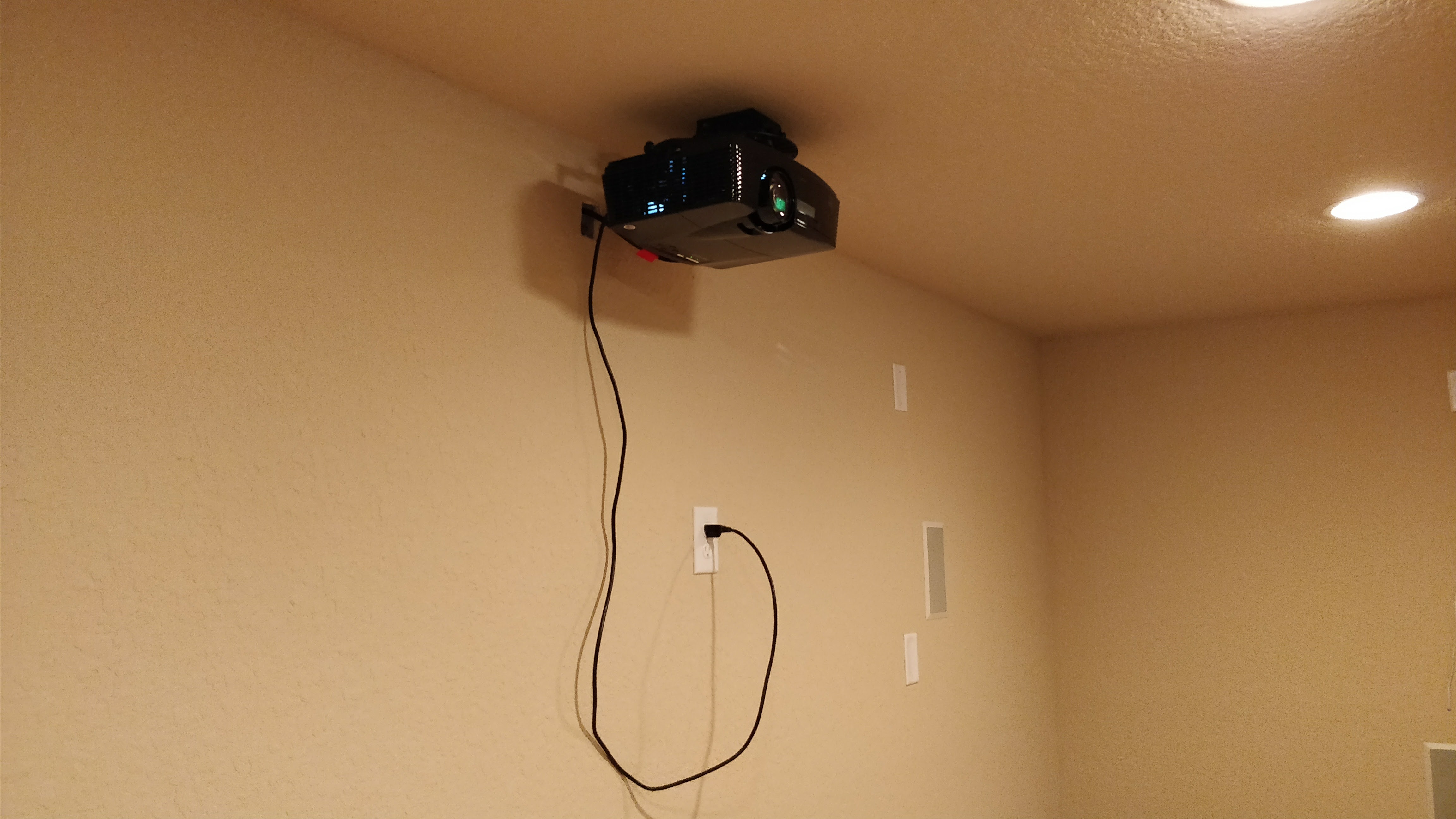

Getting the projector lined up so we can put the front three speakers behind the screen.

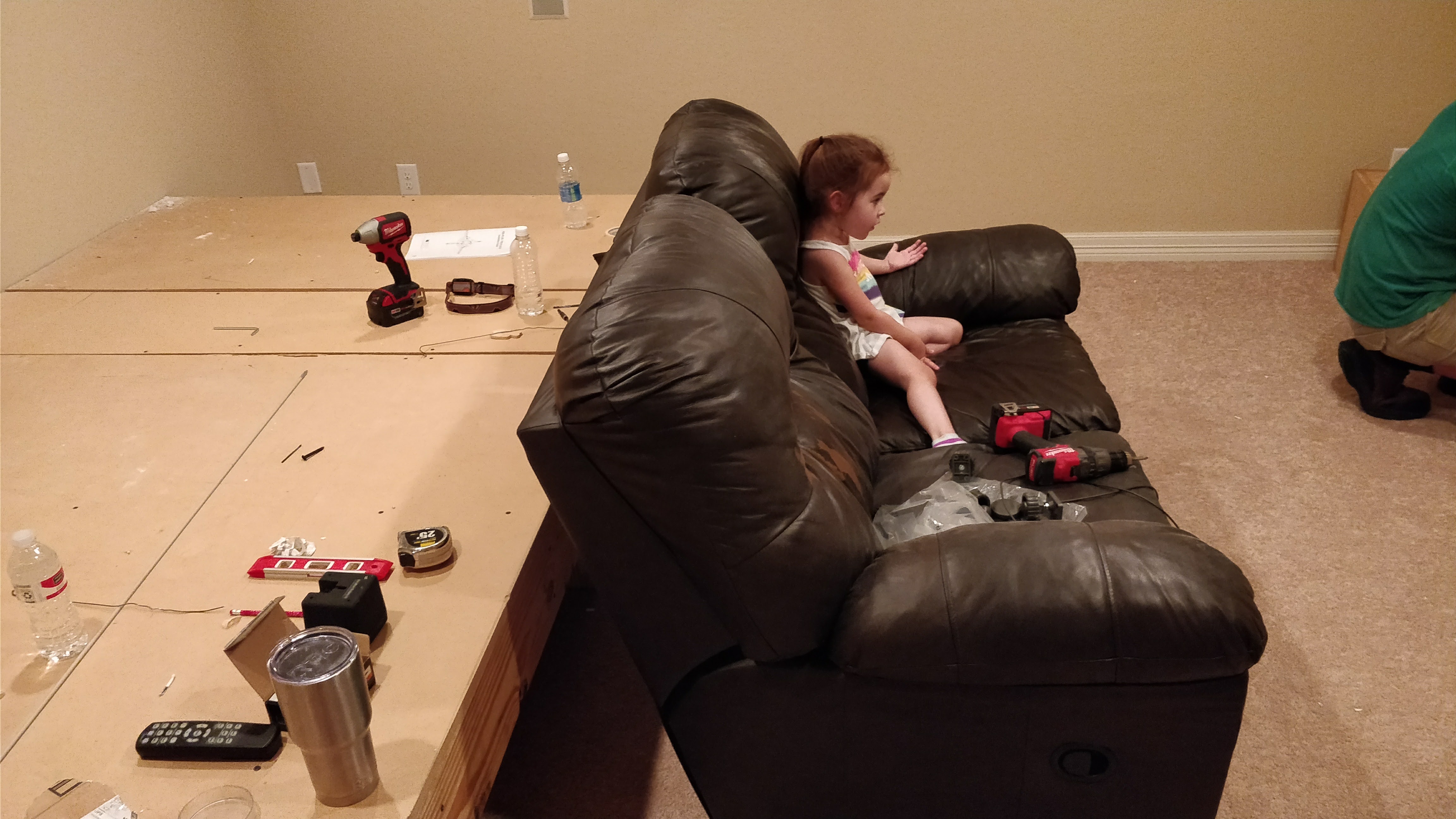

Someone wanted to "help". She is confused about something... Only one row of seating until I get new seats. Riser is already done.
I got a deal on a VERY nice fully adjustable "flush" mount for the projector. Electrician was apparently confused as to "as close as possible to the ceiling" meant when he installed my outlet.

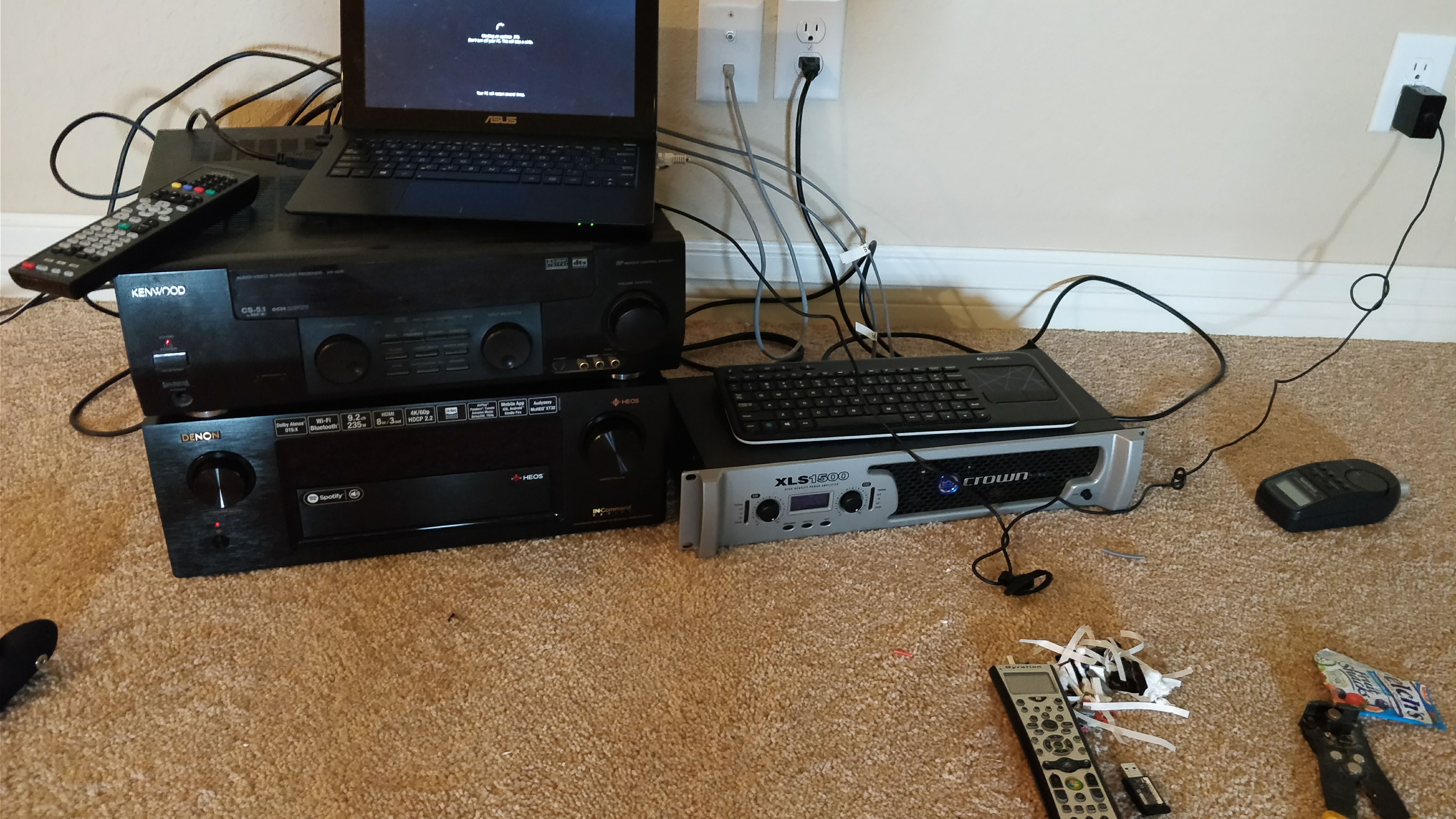

I need to build a rack now. If I can find someone to cut tempered, tinted glass. May end up buying a rack. Gotta keep the tiny hands away. I have the crown XLS 1500 for the subs. I'll use a bit over 1300w when all is done. The denon 4300h is powering every speaker except the two "rear height" atmos speakers. That's where the kenwood comes in. That is the first receiver I ever bought when I was 16. Center channel is blown, but everything else works. Temporary until I get a 2ch amp.
Temporary Atmos top speakers. They actually do a great job. I may buy another 4 pack of the Speakercraft LCR AIM3 Series 5 to go into the ceiling since everything is aimable.
Front 3 installed. Suds and a bad pre-wire I shouldn't have paid for made this difficult. Speakers are behind the screen so I'm not too upset about the need to surface mount the wiring. The speakers will eventually have back boxes once I get the time to get the measurements done.
You can see the last Atmos speaker and more of the stupid plates the moron that pre-wired put in to cover up the fact that he had to do the job twice because reading the plans I drew was too much of a hassle.
You can see two of the subs in their unfinished cabinets. I plan to do a roundover bit on all sides, install rubber isolation feet and paint them flat black.
Going to get some wall plates to tidy everything up. That is before all 15 wires were run.

So far it sounds good. Gotta get Audyssey dialed in after the other two subs are done and will report back.

It looks like you're tilting the PJ down anyway, for a lower image height. I'd think your image could be compromised by going even further off axis, nearer the ceiling?
panteragstk
panteragstk
It actually isn't tilted down. It has around a 19" offset since there is no lens shift to speak of. Add that to the mounted distance from the ceiling and the top of the image goes pretty far from the ceiling. It works fine though. We measured and there is no keystone. We didn't have to make any corrections. Image is nice and square.

Ran Audyssey twice to get it to recognize both subs and set the levels/distance correctly. Nailed on pass 2. I have to be honest in saying that these Speakercraft speakers sound pretty amazing so far.
