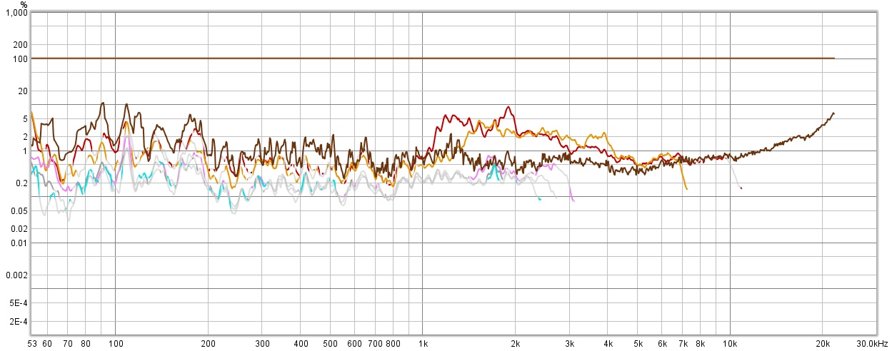

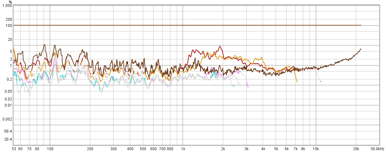

I'm glad to hear that you didn't take my late-night diatribe personally. Speaker stuff isn't worth that. Controlled dispersion is just a sore spot with me. There was a typo in my comments about the BS22 tweeter that rendered the paragraph pretty much meaningless. I meant to say the problem with the 22 was the tweeter, not the crossover. I never measured that tweeter at anything like 95 dB at two meters. That's pure torture. The RAAL would also show major distortion at that level, if it survives at all. The NRC measures distortion at 90 dB at two meters, and if the speakers do very well on that tough test, a 95 dB reading is thrown in for good measure.
I did basically a compression sweep. 80, 85, 90, 95. I stop when the distortion rises.
I grabbed that graph because the problem was the worst/most obvious. It was high at 85 and 90, just not that high.
I think I asked you about doing a similar test on your speaker up to 90 and you asked me not to, for fear I would hurt them. I was kind to the BMR but I did measure their distortion at the equivalent of 85dB at 2 meters. I measured near field because it was in room. I remember them having very low distortion.
for me, a speakers clean maximum output is an important characteristic of its sound quality. I apparently listen pretty loud and for a long time disliked a lot of otherwise good speakers. It is likely that the biggest selling point for me on the Geddes speakers were actually its high clean output. There is no rise in distortion until about 105dB and it remains modest up to 115-120 dB Range. For me, a speaker needs to have low distortion at my 3 meter listening distance out to 105dB. Most speakers simply can’t do that. While I don’t listen at 105, that is the upper limit of the cinema standard and when I rock out, it’s in the neighborhood of the peaks.
to me, nothing ruins a good listening session or movie more than a distorting speaker.
