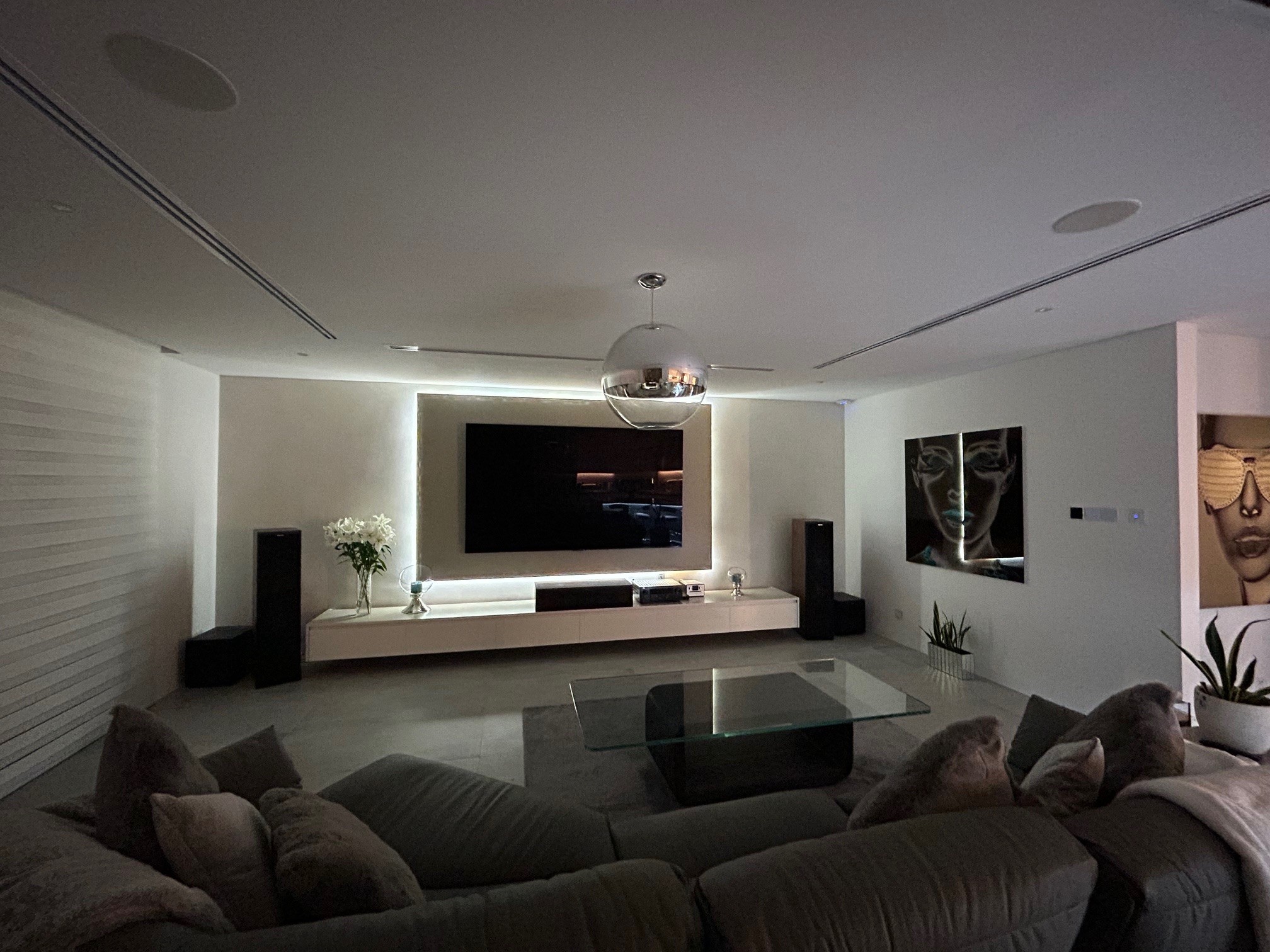

The work is in progress. View 1 is looking in from kitchen area. View 2 looking in from entrance. View 3 looking in from dining area. What walls we had have been removed. The...living, kitchen and dining will be one open space with two small pillars....not an acoustic dream.
The seating will be in the middle of the living area set back approx 4.3 m.
My idea was to have the towers close to the corners of the media wall forward from the wall , angled in...the two subs next to them at either side. The back directional ceiling speakers slightly wide behind the seating area...the surrounds at either side of seating area, with the Atmos directly above seating area. I have zone 2 outside speakers. I have contemplated a power amp for the towers...but I think that could be excessive.
I fully appreciate that ceiling mounted surrounds and backs are no replacement for ear level speakers, but wall mounting is not practical and I don't want speakers sitting in the middle of the room...(acoustically great but far from practical ) Its a compromise, not one I relish but it is what it is.
In its previous incarnation this room was set up as in the 4th photo (plus 1 extra sub and two ATMOS above the seating area), the two wide towers in cubbies, two subs and the centre in the centre cubby, two atmos above and two back B&W behind against the wall. The sound was compromised in many ways but it did sound pretty good, especially for home theatre. The ATMOS were effective but the B&W's at the back didnt add much.
Without the cubbies, I know the sound will improve...so I am simply looking to make the best of the rest.
I'm not looking to waste money but since I am already shelling out for a major refurb cost is not the dominant factor.

We are not trying to put you down here, but without near ear level surrounds, the whole sound "envelope" you are trying to create gets severely messed up putting surrounds in the ceiling.
How about a pair of in-wall surrounds? Without a diagram with dimensions and seating positions, we're guessing here, but if it's like the photo of the old set-up, one of the in-walls would go between where the right B&W was and the passageway opening. The other would be straight (?) across to the left of the Glass folding door opening.

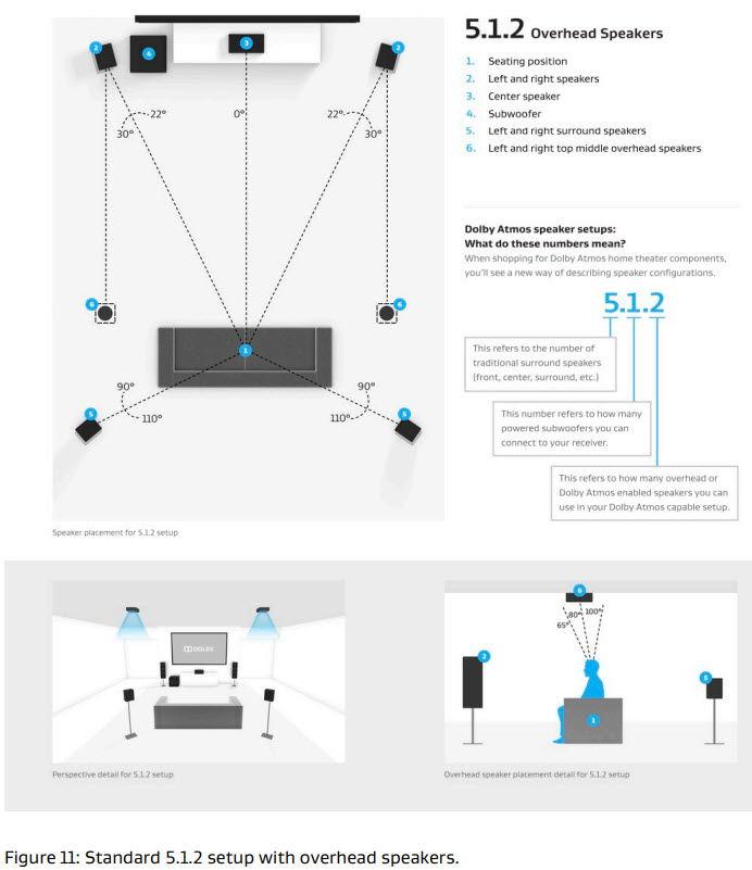

Hopefully you've reviewed the Dolby Atmos guide I linked to previously. Without dimensions I suggest you follow this 5.1.2 diagram (Sub placement should be done on it's own) to get the angles as close as possible. Notice how the Atmos pair are located just forward for the main seating position, and not behind it. (This will lessen the surrounds interfering with them and help create the complete sound field.)
See page 27 in the Guide.
I'd suggest you try your existing B&W FPM 4'S and Subs in the correct layout before jumping to purchase new gear (including panels). You'll gain a better understanding of what's needed to make you happy when you've listen to the system for a while after it's setup.
I hope this is helpful.
Very helpful thanks. I am going with the Figure 11. set up my surround backs are a little bit wider placed because thats where the columns are. I'll try the B&W's and see...I have never made the best of those as previously they were set up just as rear speakers.. With the ATMOS recommended placement and without the cubbies, I expect improvement on what was already pretty decent sound for our puposes. I have provison in place for any further changes down the line if required.
