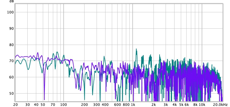

I'm seeing a huge 50hz null post correction. The purple line is after running correction. Would love to get some ideas of why this might be occurring.
It's difficult to really say, but I'd guess it's trying to choose a lesser of evils. Sometimes adjustments made to "fix" a frequency band will have deleterious effects on other frequencies up or downstream from the adjusted band. You can fix one spot but the solution might create problems in another, or just push a null up or down the frequency band.
It's tricky business, eq'ing and quite often less is more depending on room modes, speaker placement, etc. Audyssey does a really good job for me, but I can definitely improve on it with a few manual tweaks after measuring.
Pogre
Pogre
That down spike at 50 hz does look like an improvement vs no correction and is likely not even audible. I'll bet it disappears with some minor smoothing.
Pogre
Pogre
Yeah, apply 1/12 smoothing to both of those sweeps and I'll bet the purple trace is actually an improvement.
I just applied 1/12 smoothing and the change was dramatic

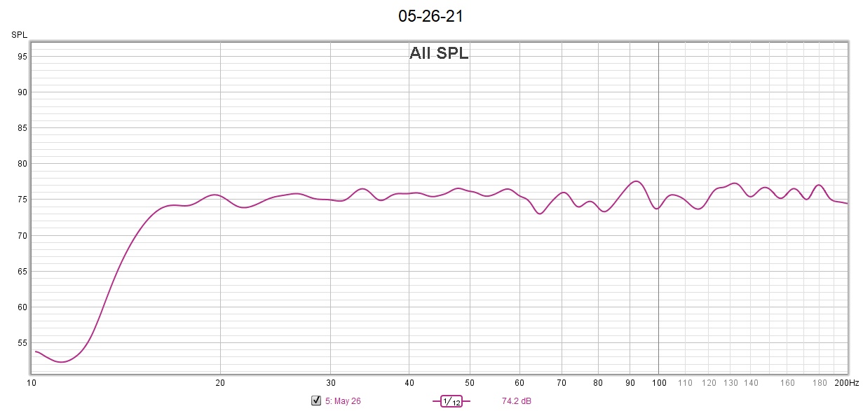

Your dB scale for the vertical axis is way to wide. You should really have it between about 100 dB and 45 dB. There's no way to see what's going on at that resolution. Also, if bass is what you're focusing on you can adjust the horizontal axis to between 10 hz and 200 hz. Here's an example.
You can see a lot more detail with the higher resolution in this chart.
Audyssey won't cause nulls as much as your room....
Ok so I went back today and did some more testing. Something funky is def going on with my Audyssey calibration. I decided to take a couple steps back and measure the subs alone with no Audyseey. Even if I remove the smoothing there is no null. I would say this is a pretty smooth curve (if I remove any smoothing it looks nearly identical) for no EQ or room correction of any kind and the dip seems to be driven by the crossover at 80hz.

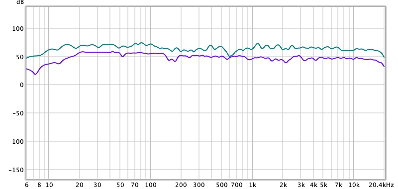

I then added the mains back to the mix still with no Audyssey. The brown line is the new curve compared to prior graph. Def some funky stuff going around 80-90hz at the crossover point without any room correction.
Lastly I added back the current Audyssey correction. The teal line is now post Audyssey, brown is without so whatever it did is actually making pretty much everything worse, my takeaway at this point is I need to completely re-run Audyssey to see what the heck is going on.
