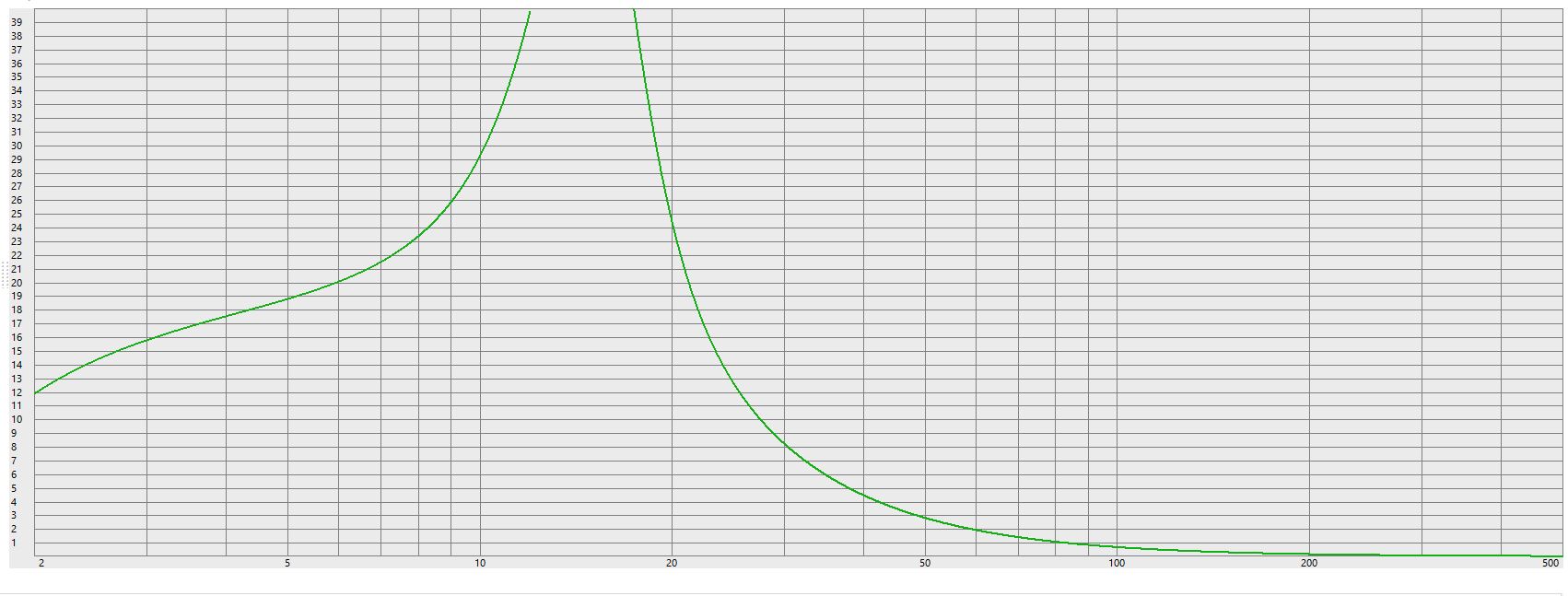

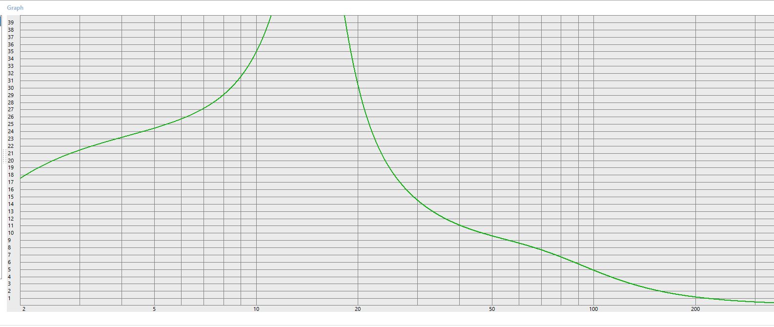

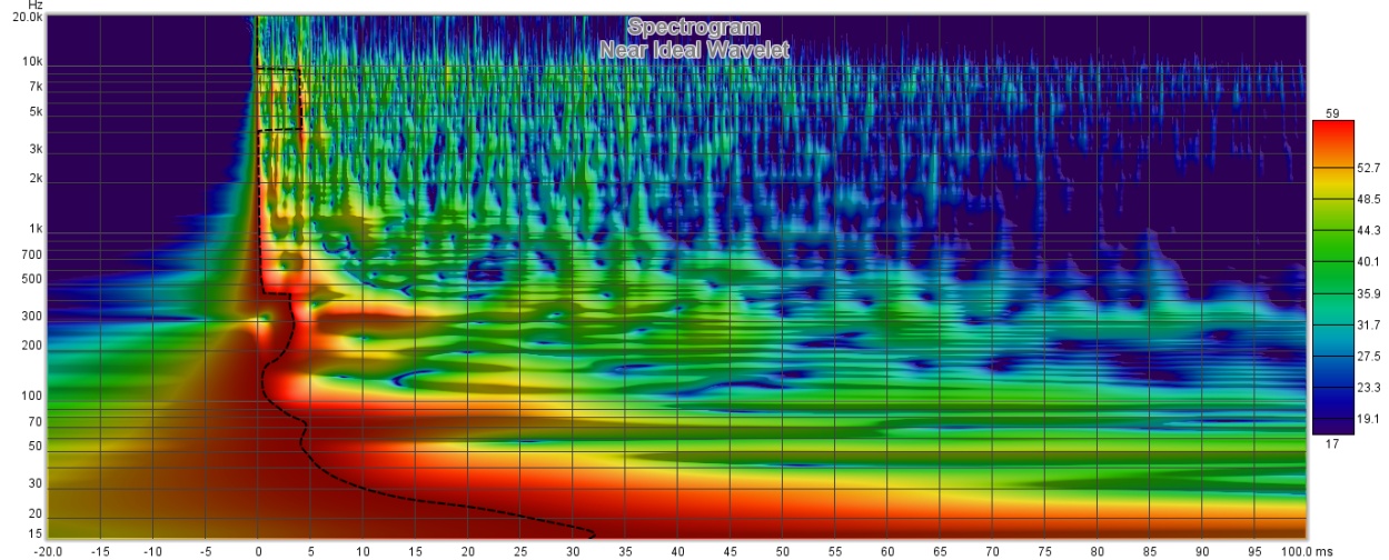

Ok what about group delay, what is this business and how serious is it? Well, normally I would say not very important. I mean, the science is thin, but what we have suggests that if the group delay is kept below 1.5 periods, it shouldn't be audible. 100hz period is 10ms, that's a long time for a speaker, it would take a lot to add more than 15ms of groupd delay, right? Well, maybe not. The times are changing, and modern DSP does a lot to screw this up. First, the sub amplifiers now have DSP and DSP itself has overall delay. But a subwoofer is bandwidth limited. What happens when you add a bandwidth limited speaker to the overall system and it has a delay. It becomes group delay.
I will use WinISD to show a series of changes to the natural group delay of a single subwoofer progressing from no added filters to a worse case scenario where someone using the fanciest new DSP powered sub has gone to down with REW, attempting to fill in every little dip with boost EQ, added steep LP filters, etc.
No issues:
Just a low pass filter:
OMG What have you done!
Ok the last one isn't as bad as it could be, but for the sake of argument, after lots of filters, we are at or beyond 1 period across the entire bandwidth. While group delay was generally said to be a non-issue, they weren't thinking it could get this bad!

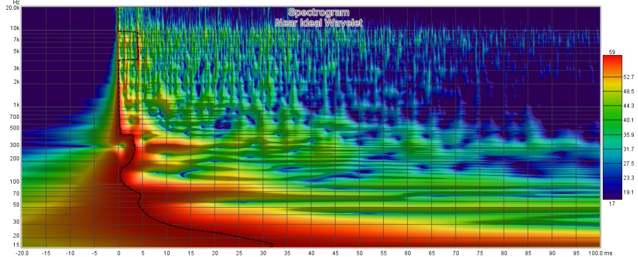

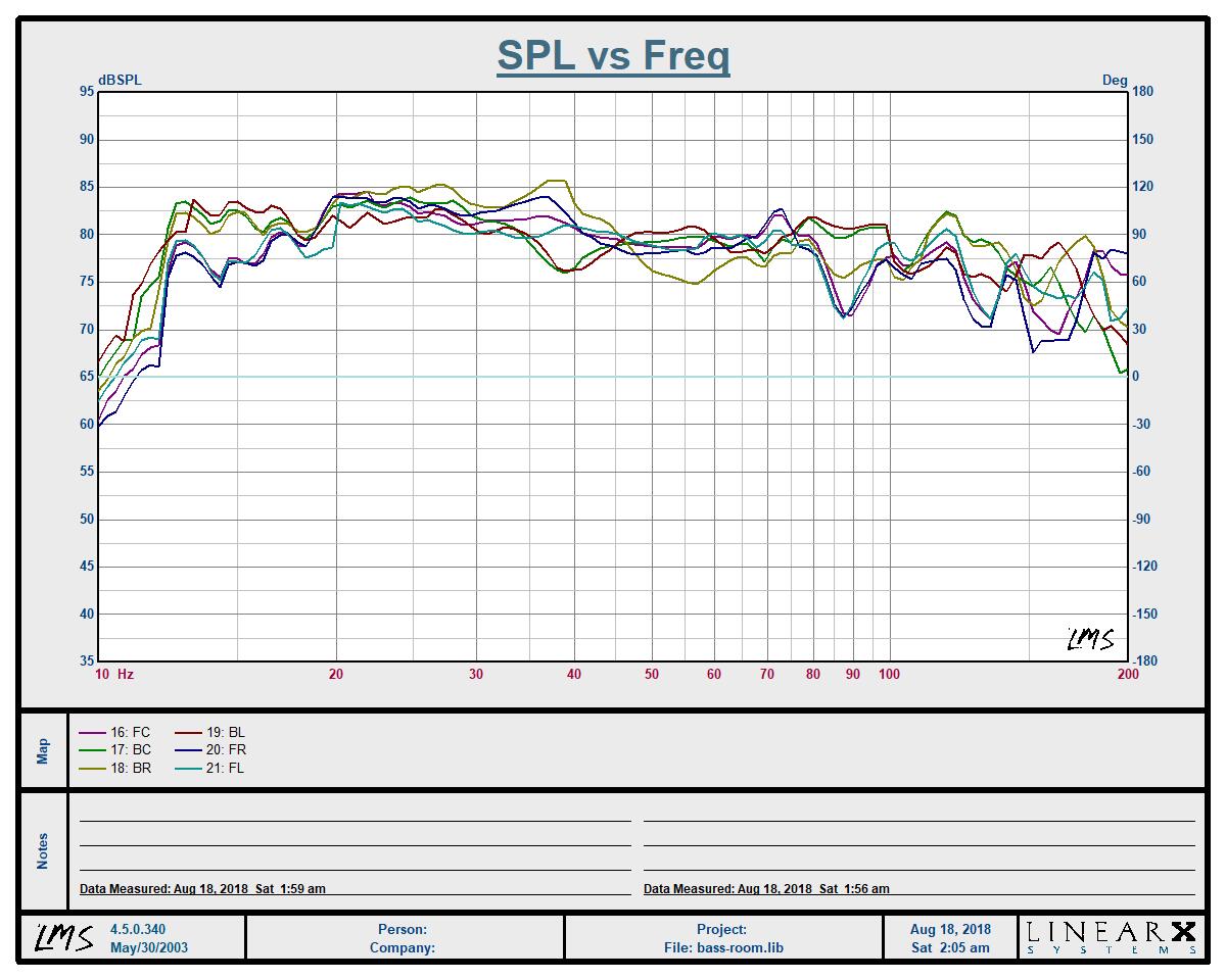

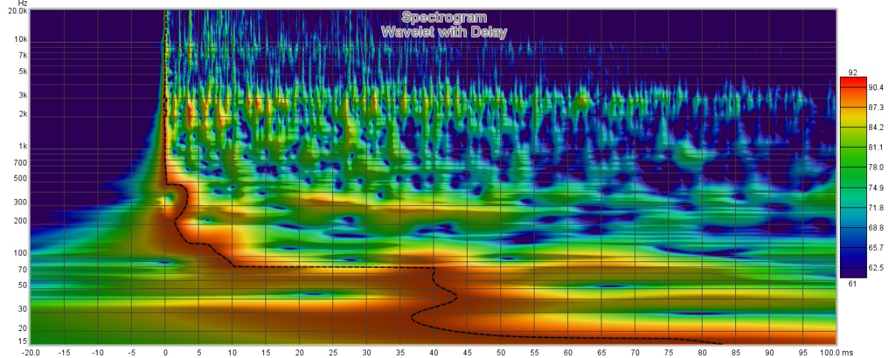

Now the room itself also gets in the way and so what I'm showing here is still better than reality. Modes add a ton of group delay, and I'll show some real-world examples of this. My point with all this, though, is that we should take steps to not introduce excessive amounts of extra group delay. I've now begun to measure peoples systems reporting more than 100ms of group delay, well over 30ms by 100hz! That isn't good.
Here is a measurement of a good system in room. This wavelet shows what we would want to see in a pretty ideal system. The black line reflects group delay, basically.
This shows a common setup with subwoofers in an ok arrangement. Not terrible, but not as good as above:
And...This shows the OMG what have you done scenario:
I think this is showing what happens when DSP runs wild. The solution is to go back to the DSP in the processor, handling the bass management, and provide the needed facilities to improve bass integration. This will hopefully reduce the reliance on DSP later in the chain (whose delay can't be compensated for if it is not common to all subwoofers) and where often far too much "fix" is applied.
When I setup a system and I "roll my own" bass management, by the time I've completed all of the setup work related to crossover, phase, speaker placement, etc., I only need 1-2 eq filters, and only cut filters. However, that is never possible with bass management the way it is.
