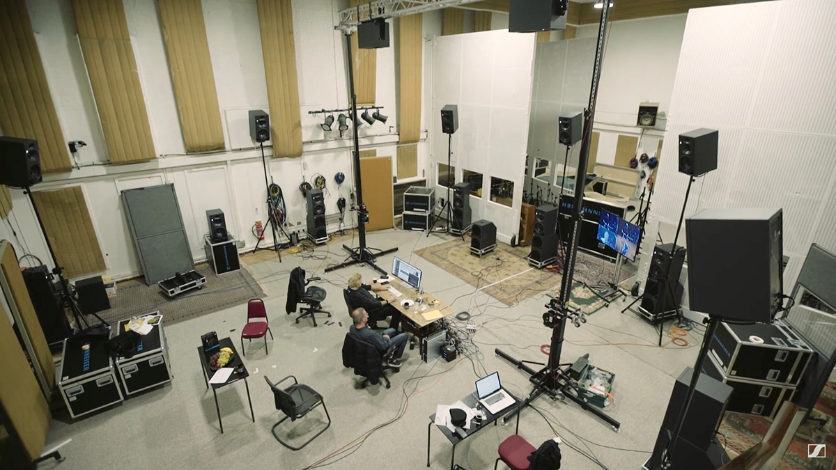

witchdoctor Full Audioholic Jan 20, 2015 409 0 18 42 Aug 24, 2022 #3 I meant more like the screening room they use rather than a mixing desk, here is the Aurotorium they use at Galaxy Studios: https://www.galaxystudios.com/wp-content/uploads/2014/01/aurotorium.jpg Mixing Immersive Audio at Abbey Road Studios. My speaker setup looks nearly identical except the monster subs on the ceiling. Notice how the MLP is equidistant from each speaker instead of a typical living room setup with the sofa in the back of the room or like you see in the dolby setup diagram for atmos. That paid huge dividends when I moved the MLP forward so the front and rear channels are equidistant in my room. They also use active speakers, Neumann I believe: Last edited: Aug 24, 2022
witchdoctor Full Audioholic Jan 20, 2015 409 0 18 42 Aug 24, 2022 #4 I had to use tall stands like in the picture for height channels because active speakers are so heavy. Obviously my room is a lot smaller so I had to dial it in a bit. I chose to use passive speakers on the ceiling for the VOG/ Top Middle channel as I don't have outlets on the ceiling to plug in active speakers .I consulted with Paradigm to choose the passive speakers that would most closely match my active speakers and it worked out fine. Do you notice how all of the height channels are NOT mounted in the ceiling pointing straight down but instead mounted above the associated bed channel and tilted at the MLP? That works GREAT in my room.
